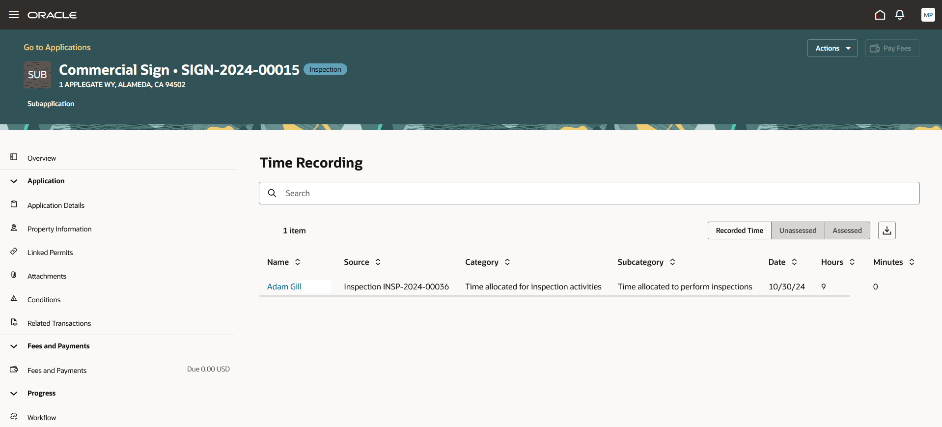

This example illustrates a time entry that was recorded for a permit inspection.
Time Recording page in the permit application details
