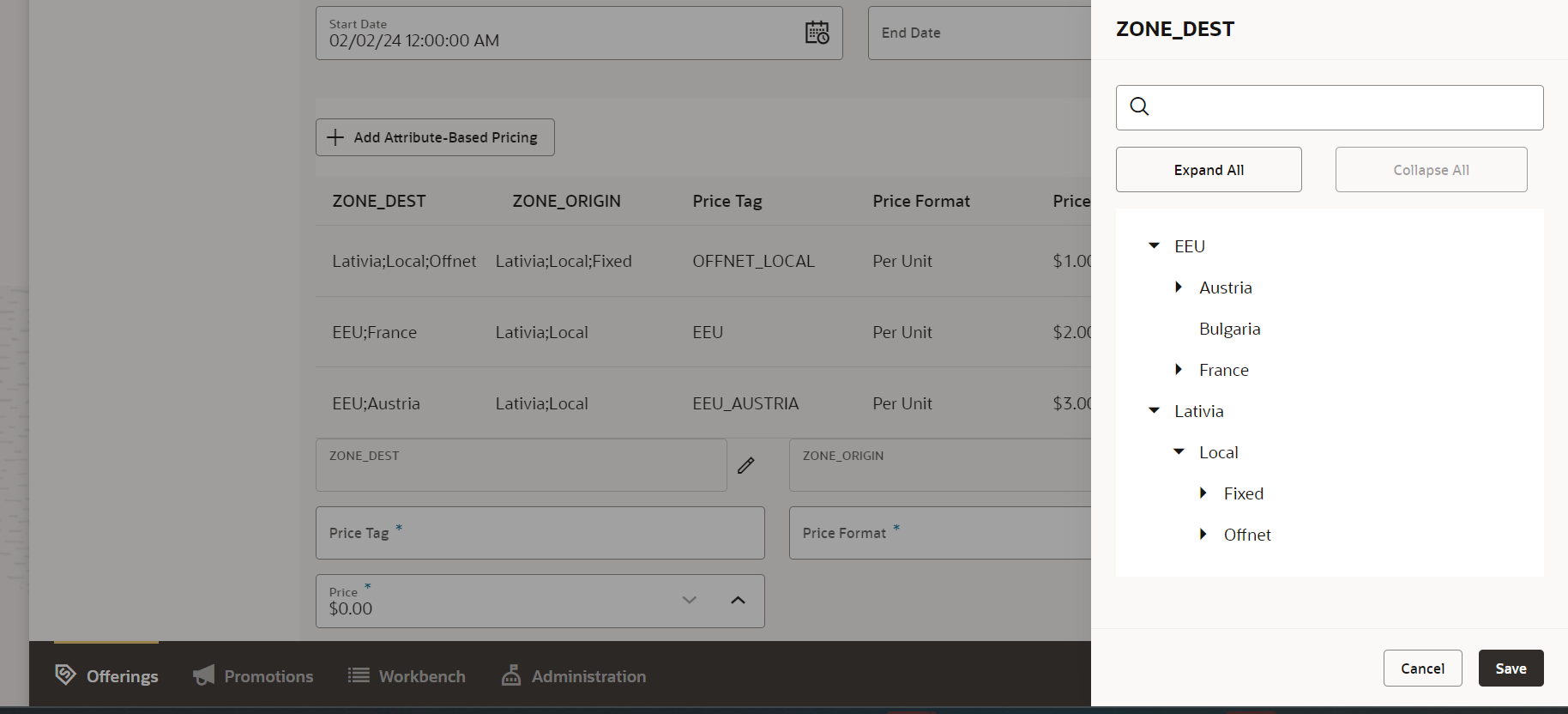

A value map is a hierarchical structure that associates zone names with values that apply to a single event attribute, such as an area code, an IP address, or a broadband bit rate. A value map can have multiple nested zones.
You use value maps in attribute based pricing to group event attribute values into manageable categories. For example, to apply the same charge to all calls made from the San Francisco Bay Area to Los Angeles, you might use a California Area Codes value map that includes the following zones:

Instead of creating attribute based rules for all possible combinations of those area codes, you associate the California Area Codes value map with the attribute based pricing and then create only one rule in which San Francisco Bay Area is the origin call value and Los Angeles is the destination call value.

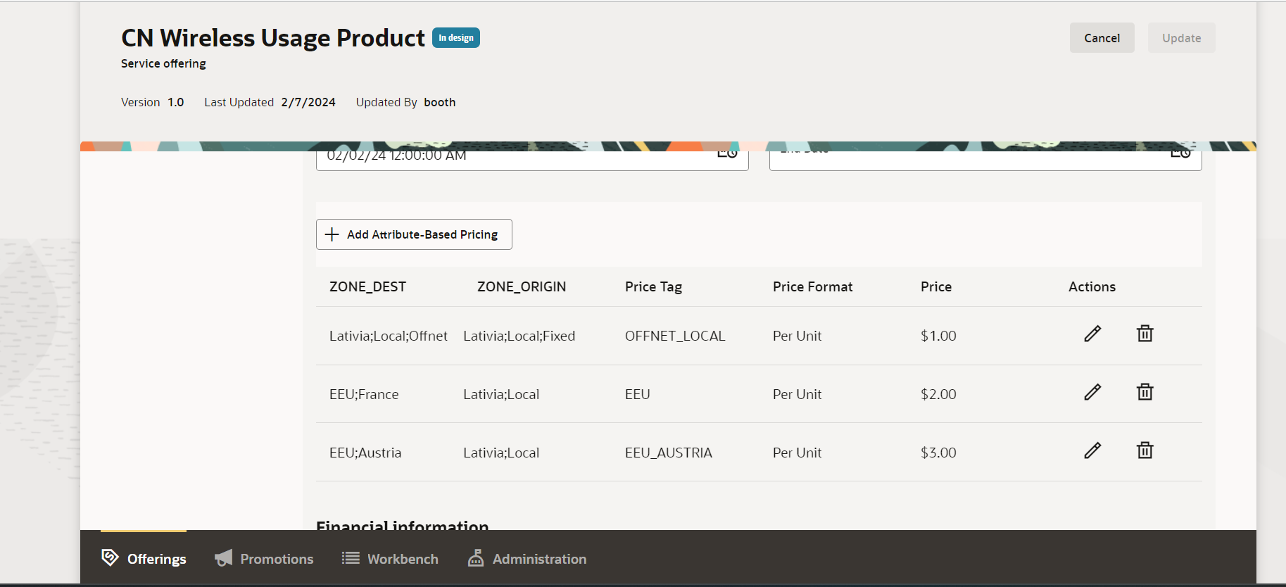

The following figure shows attribute based pricing using value map
Zone Configuration
Zone Configuration

The value map needs to be created via REST API as a prerequisite for it to be used in the atomic offer attribute based pricing. Refer to the REST API documentation for more information.
