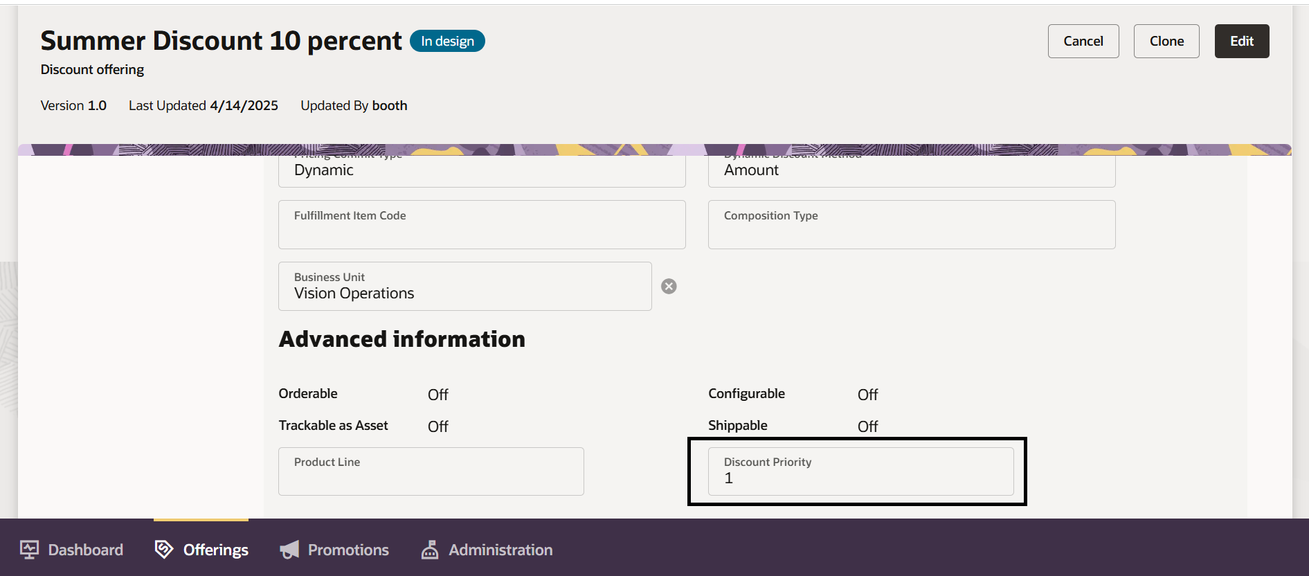

    • Discount priority for product offer type discount and time-based discount. Discount priority dictates the order in which discounts are evaluated by the charging engine in case there are multiple discounts. Higher the number the more the priority.

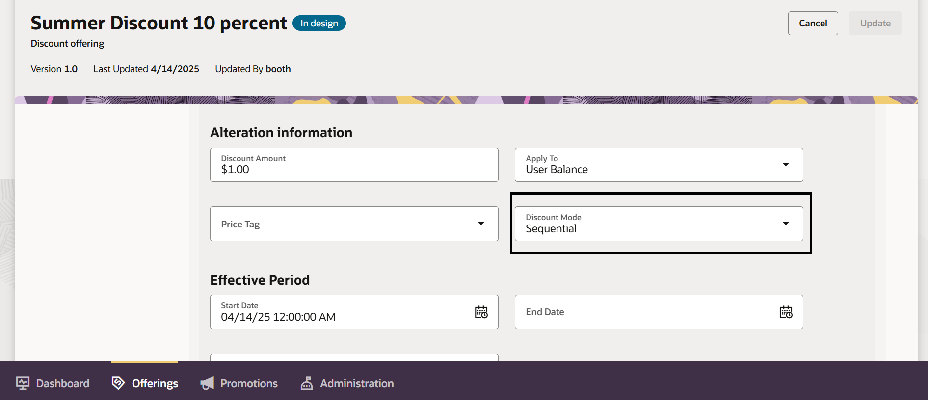

    • Discount mode – This indicates how a discount needs to be applied by the charging system. The values are sequential or parallel. Sequential discount means the discount offer is applied to whatever charge amount remains after previous discount offers are applied. Parallel discount means the discount is applied to the original charge amount, regardless of whether that amount was reduced by previous discount offers.

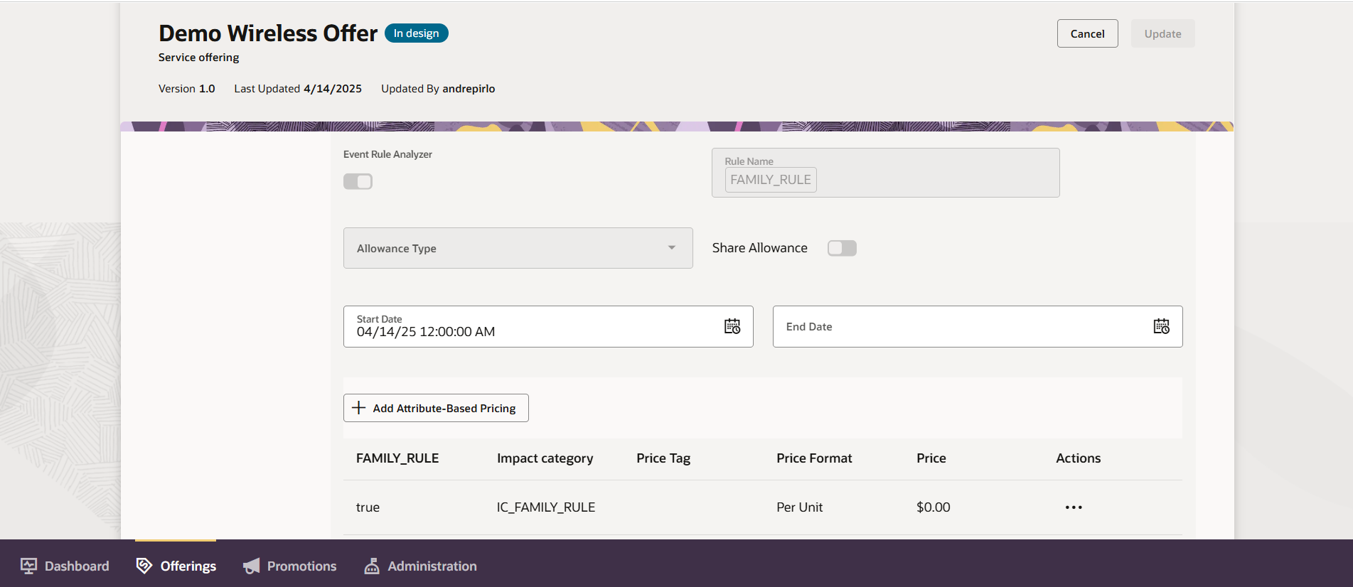

    • Ability to configure friends and family or closed user group pricing.
    • Initially setup custom event analyzer rule in both Pricing Design Center (PDC) and Launch for automated distribution to PDC.
      • REST API end point for custom anayzer rule https://<HOST_NAME>/crmRestApi/atcProductCatalog/11.13.18.05/productCatalogReferenceManagement/v1/customProfileSpecification  ("profileType": "CUSTOM_ANALYZER_RULE“)
      • Configure the Impact category in the Common Business Configuration to be used in the attribute-based pricing
    • Setup atomic offering with billing service type as special rating.
    • Use attribute-based pricing in Launch with the custom event analyzer rule and setup special rates for each rule
    • Ability to publish these definitions to Siebel and PDC
    • Example – 0.1$ price for five family numbers.
The following image shows the discount priority in atomic offering.
Discount Priority
Discount Priority
The following image shows the discount mode in atomic offering.
Discount Mode
Discount Mode
The following image shows the friends and family pricing in atomic offering.
Friends and Family Pricing
