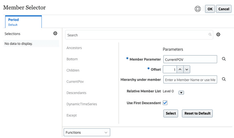

Two additional optional parameters, Relative Member List and Use First Descendant, are now added to the RelativeMember member selection function.
- Relative Member List: When a level or generation member list is specified, the relative members are taken from the specified list of members.
- Use First Descendants: Returns the first descendant under the specified member parameter.
relativemember function
Note: You cannot use both the Hierarchy Under Member and the Relative Member List parameters in the same definition.
