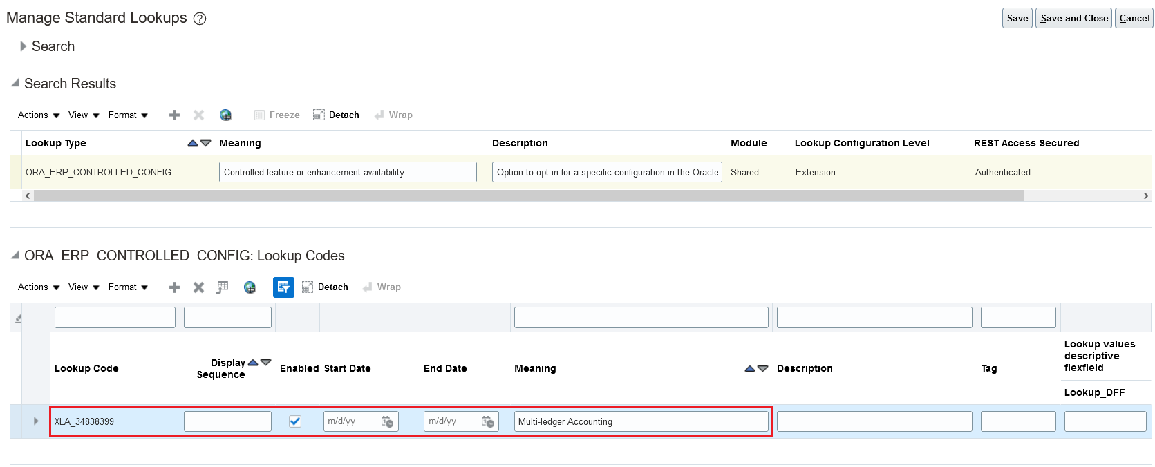

Enabling the Process Multiple Ledgers in a Single Process Run and Improvements to Transfer of Subledger Accounting Entries to General Ledger Enhancements for Accounting Hub Applications
Use the following steps to enable the Process Multiple Ledgers in a Single Process Run and Improvements to Transfer of Subledger Accounting Entries to General Ledger enhancements for Accounting Hub applications -
  1. Navigate to Setup and Maintenance.
  2. Search and navigate to the Setup Task: Manage Standard Lookups.
  3. Search the Lookup Type: ORA_ERP_CONTROLLED_CONFIG.
  4. Define the following Lookup Code under above Lookup Type -
    • Lookup Code: XLA_34838399
    • Enabled: <Checked>
    • Meaning: Multiledger Accounting
  5. Save the changes.
Defining lookup code under lookup type for Multiledger Accounting

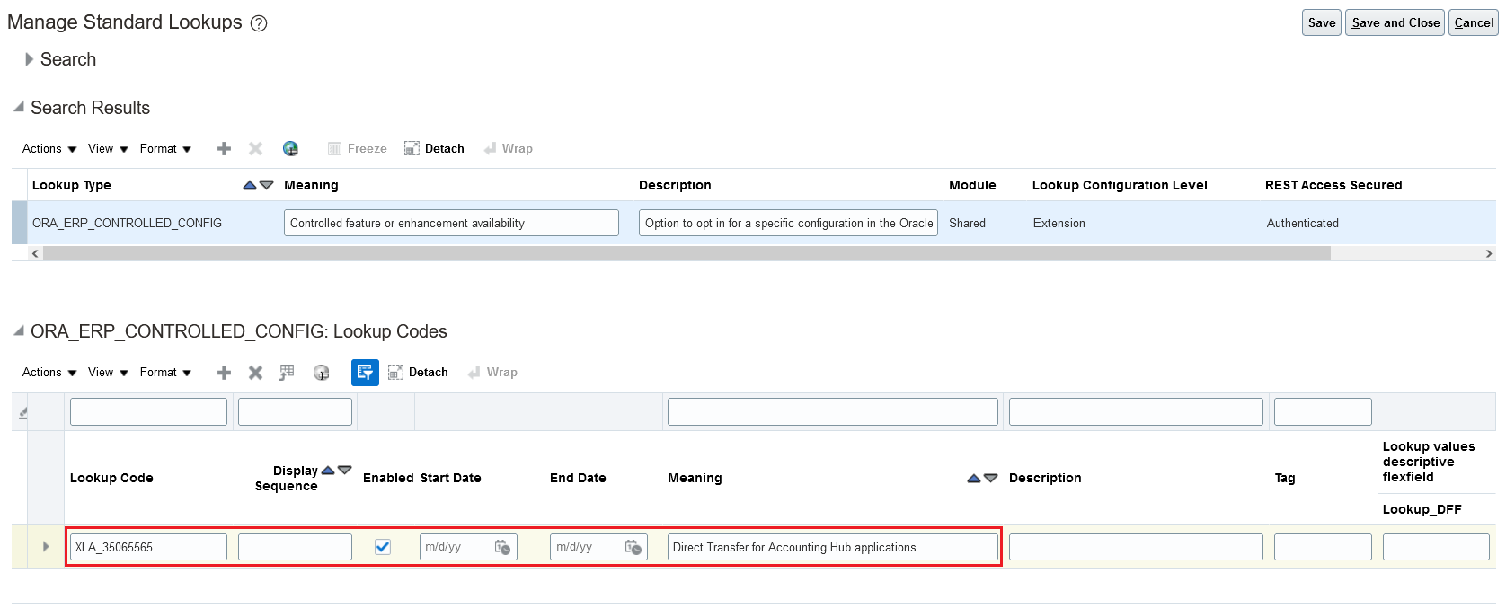

Enabling the Improvements to Transfer of Subledger Accounting Entries to General Ledger Enhancement for Accounting Hub Applications
Use the following steps to enable only the Improvements to Transfer of Subledger Accounting Entries to General Ledger enhancement for Accounting Hub applications -
    • Lookup Code: XLA_35065565
    • Meaning: Direct Transfer for Accounting Hub applications
Defining lookup code under lookup type for Direct Transfer for Accounting Hub applications

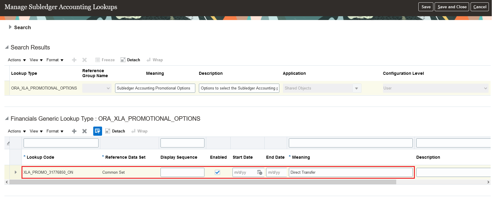

Enabling the Improvements to Transfer of Subledger Accounting Entries to General Ledger enhancement for all Subledger and Accounting Hub applications
Use the following steps to enable the Improvements to Transfer of Subledger Accounting Entries to General Ledger enhancement for all Subledger and Accounting Hub applications -
  2. Select the Setup Offering: Fusion Accounting Hub.
  3. Click on the Functional Area: Accounting Transformation.
  4. Click on the Setup Task: Manage Subledger Accounting Lookups.
  5. Search the Lookup Type: ORA_XLA_PROMOTIONAL_OPTIONS.
  6. Define the following Lookup Code under above Lookup Type -
    • Lookup Code: XLA_PROMO_31776850_ON
    • Reference Data Set: Common Set
  7. Save the changes.

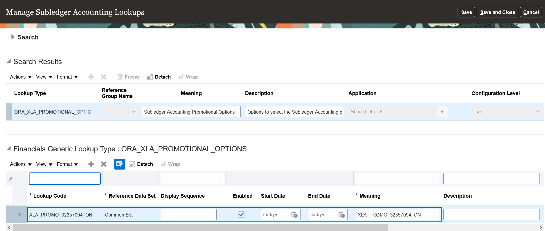

Enabling the Intelligent Queue Management enhancement for Accounting Hub applications
Use the following steps to enable the Intelligent Queue Management enhancement for all Subledger and Accounting Hub applications -
    • Lookup Code: XLA_PROMO_32357094_ON
    • Meaning: Enable Intelligent Queue Management
Defining lookup code under lookup type for Enable Intelligent Queue Management
