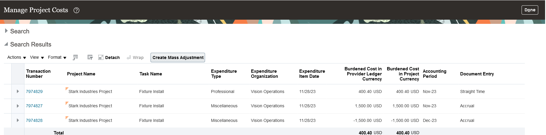

Sample Cost Transactions
| Revenue To Date | ITD Actual Cost in Project Currency with Accounting Date filter |
ITD Actual Cost in Project Currency without Accounting Date filter |
| 30/11/2023 | 1900.40 USD | 400.40 USD |
| 31/12/2023 | 400.40 USD | 400.40 USD |
NOTE: ITD Actual Cost in Project Currency without the Accounting Date filter is calculated based on Expenditure Item Date.
