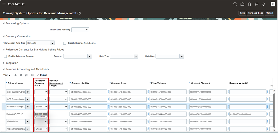

Allocation Currency Basis
Use the newly introduced ledger level Allocation Currency Basis option to designate the currency basis to use to drive your revenue allocation and recognition calculations.
When you set this option to Entered, revenue contracts and the underlying performance obligations are modeled using the transaction currency amount of the source document lines as the driving values for the allocations. The application establishes and allocates the contract and performance obligations in the transaction currency amounts. This applies to both ledger and nonledger currency-denominated transactions for the selected ledger.
Billing and receivables activities are deemed monetary and use current rates. Performance obligations are committed and expected future deliverables are valued at the expected consideration amount and unknown exchange rates are also valued at current rates. However, when the revenue value allocated is billed or collected in full and not subject to further change, an obligation may be nonmonetary and is converted at the rate of the initial recognition.
Therefore, when the revenue contract’s entered currency is a nonledger currency-denominated, the billing accounting distributions are converted using the conversion rate as of that transaction’s date. Revenue recognition is valued at the rate for the period in which the revenue occurred. Alternatively, if the performance obligation is determined to be nonmonetary, revenue can be recognized at historic rates. That is:
- When the performance obligation is designated as monetary, invoicing and satisfaction date rates, are the current period base rates.
- When the obligation is designated as nonmonetary, the satisfaction transaction date and rate date is the performance obligation’s initial performance date.
In contrast, when modeling using the Accounted option, the application invokes the existing functionality, in which nonledger currency-denominated contracts are translated at contract inception to the ledger currency. The application established the contract consideration in the ledger currency. This amount is used as the basis for revenue allocation and recognition.
When using this feature, the Revaluation process in General Ledger is configured to revalue the contract asset account balances and the performance obligation account balances. The Revaluation process operates at the portfolio (general ledger balance) level, and its foreign exchange entries are visible only in General Ledger.
Upon uptake of the release, in support of backward compatibility, the Allocation Currency Basis for existing ledgers is set to Blank. The value of Blank indicates that Revenue Management is using the original logic for treating non-ledger currency denominated revenue contracts.
When adding new ledgers, the allocation currency basis is set to Entered, because this approach provides organizations the benefit of both methods. If you set the Allocation Currency Basis option to Entered and the Foreign Currency Treatment to nonmonetary on the performance obligation, you receive the same results as if modeling using the existing Revenue Management functionality, in which the contract consideration is converted using a single rate and held constant. The only difference is that the rate used is the performance obligation’s initial performance date rather than the contract’s inception date across all performance obligations. If you want to continue using the original approach, you can modify the default setting.
If you are unsure which approach is appropriate to achieve your revenue policies, you can run a test data set of contracts in a test environment, and then switch the setting and discard and reprocess the contracts. This allows you to compare the accounting results between the two different approaches and determine which is more aligned with your needs without impacting your existing contracts, because the change is only applied to new and unprocessed lines.
Contracts created before activation of this feature will continue to be processed under that method until the end of their life cycle or when you discard the contract.

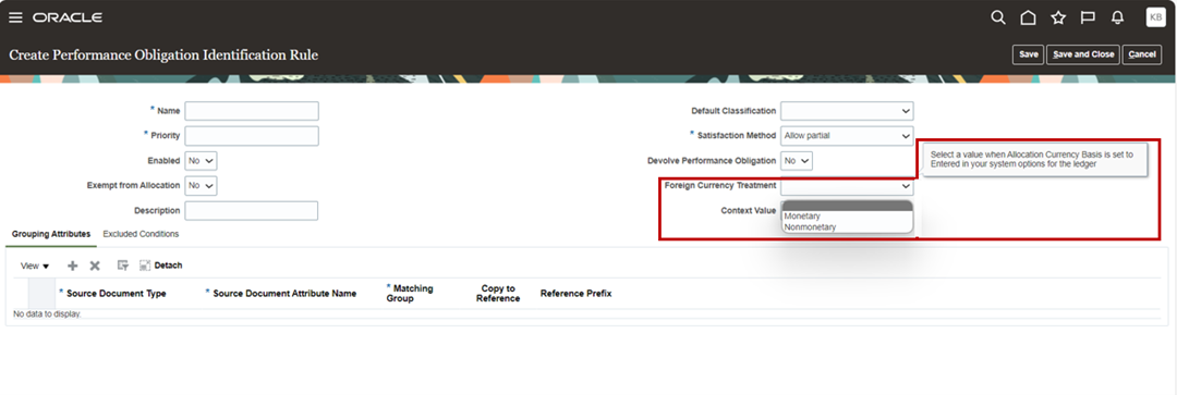

Foreign Currency Treatment Designation
For organizations who engage in agreements where the terms and conditions dictate that payment of goods and services are made in advance in full for their nonledger currency-denominated contracts and their revenue policies interpret ASC 606 Section: 830-20-30-01 as requiring the obligation contract balances to be treated as non-monetary, a new option is available to address this requirement.
You can now designate the desired treatment as part of the performance obligation identification process. A new attribute, Foreign Currency Treatment, is available in the Manage Performance Obligation Identification Rules page.
With this setting, you can designate the contract balance accounts for the resulting performance obligations as monetary or nonmonetary in accordance with your business practices.
You can use an extensible attribute to capture this information as part of the ordering process and use it when identifying your performance obligations to designate the foreign currency treatment for the contract accounts.
The application converts accounting distributions for nonmonetary performance obligations to the accounted currency using the exchange rate as of the initial performance date of the obligation, regardless of the date of occurrence. The premise is that the obligation is paid in full and the amount of revenue to be recognized is fixed and not subject to fluctuation in changes in exchange rates.
Conversely, for performance obligations that are not paid in full up front, the contract account balances are designated as monetary and the balances are converted using current rates.
This treatment affects the accounting of the contract liability accounts and revenue entries only.
Invoicing and billing is always converted using current rates.
Because performance obligation identification rules are not ledger specific and are shared across ledgers, you can continue to use your existing rules.
Alternatively, when creating new performance obligation rules, you can select the Foreign Currency Treatment by navigating to the attribute in the header region of the Create Performance Obligation Identification Rule page.
Because the designation is only applicable when processing source document for ledgers with the Allocation Currency Basis assignment set to Entered, you can set the designation on your existing In Use rules as long as your existing rule definitions support the appropriate grouping criteria. The setting is applied when processing new and unprocessed source documents from that point forward.
When processing source documents for ledgers where the Allocation Currency Basis assignment is Accounted or Blank, the designation is ignored.
After contract and performance obligation identification, if the accounting treatment is not in line with your policies, you can change the assignment in the performance obligation rule and then discard the contract. Upon re-identification of the contract, the application applies the latest performance obligation identification rule settings.

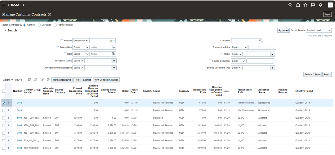

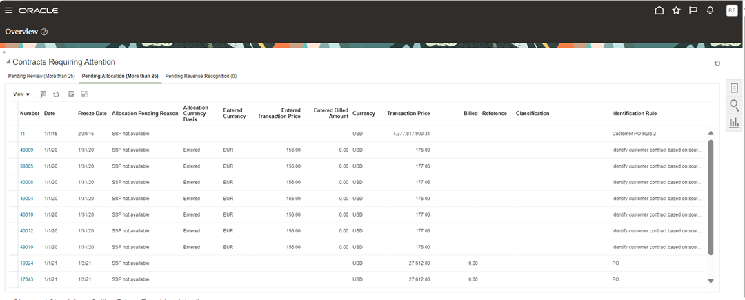

In support of this feature, the Revenue Management Overview work area is expanded to include the new attributes. When viewing the contracts, the work area now displays the allocation currency basis for the contract, its foreign currency treatment indicator, and the relevant entered currency amount details.
The Manage Customer Contracts page now displays the entered currency-related details, in addition to the new attributes, so that you can distinguish the allocation basis and foreign current treatment of the contract. These attributes are also available when you perform an advanced search.
When the contract is modeled using the Entered Allocation Currency Basis, the Edit Customer Contract page displays only the applicable contract details in the entered currency, because the accounted versions are no longer applicable. In the contract header, the revenue recognized to current period attribute displays the revenue recognized in both the entered and accounted currencies. This number represents the amounts that are final accounted and posted to the subledger.

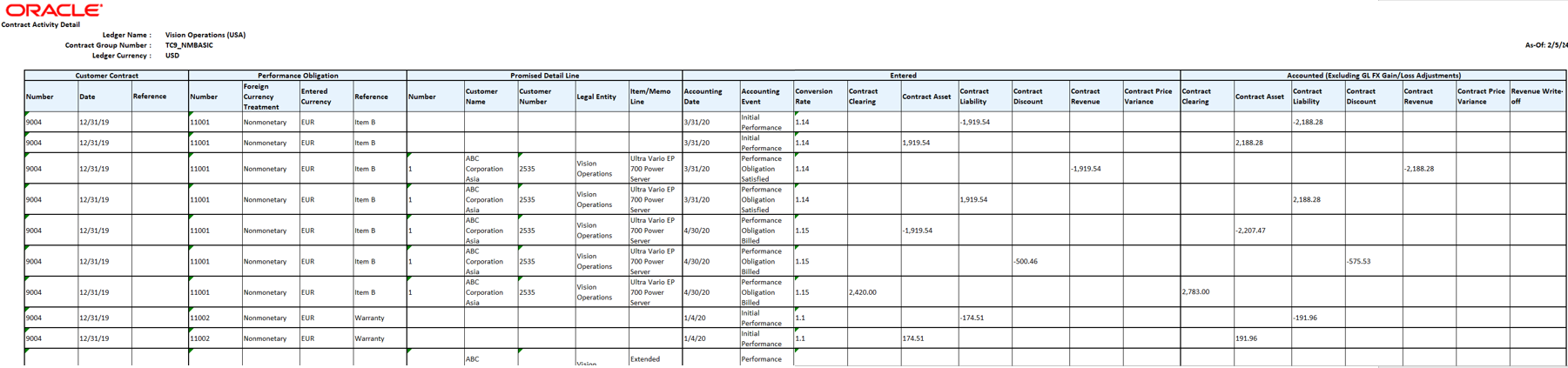

Improved Reporting
Contract Activity Details Report
The Contract Activity Details report now displays both the Entered and Accounted contract account balances for the revenue contract. The report is expanded to include the conversion rate date and rates used for the accounting events. Only accounting distributions that are final accounted are displayed.
