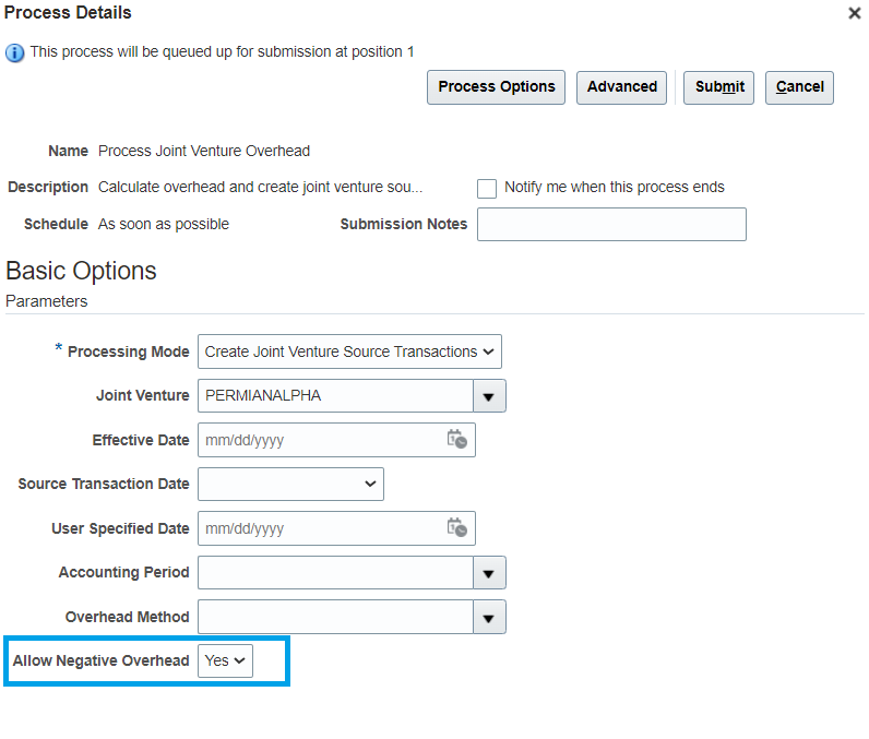

To process joint venture overhead with negative overhead amounts:
- Run the Process Joint Venture Overhead process in the Create Joint Venture Source Transactions mode.
- In the parameters, select Yes for Allow Negative Overhead to allow the processing and creation of negative overhead transactions. The default is No for this parameter..

If your normal business practice is not to create negative overhead amounts, set Allow Negative Overhead to No. The report will print the negative overhead amount, the overhead method, and the joint venture name with a message indicating that negative overhead was calculated for the joint venture.
If you set Allow Negative Overhead to Yes, the report will generate and print the negative overhead along with information about the amount created, the overhead method, and the joint venture name. It will also display a message indicating that the negative overhead was successfully created.
