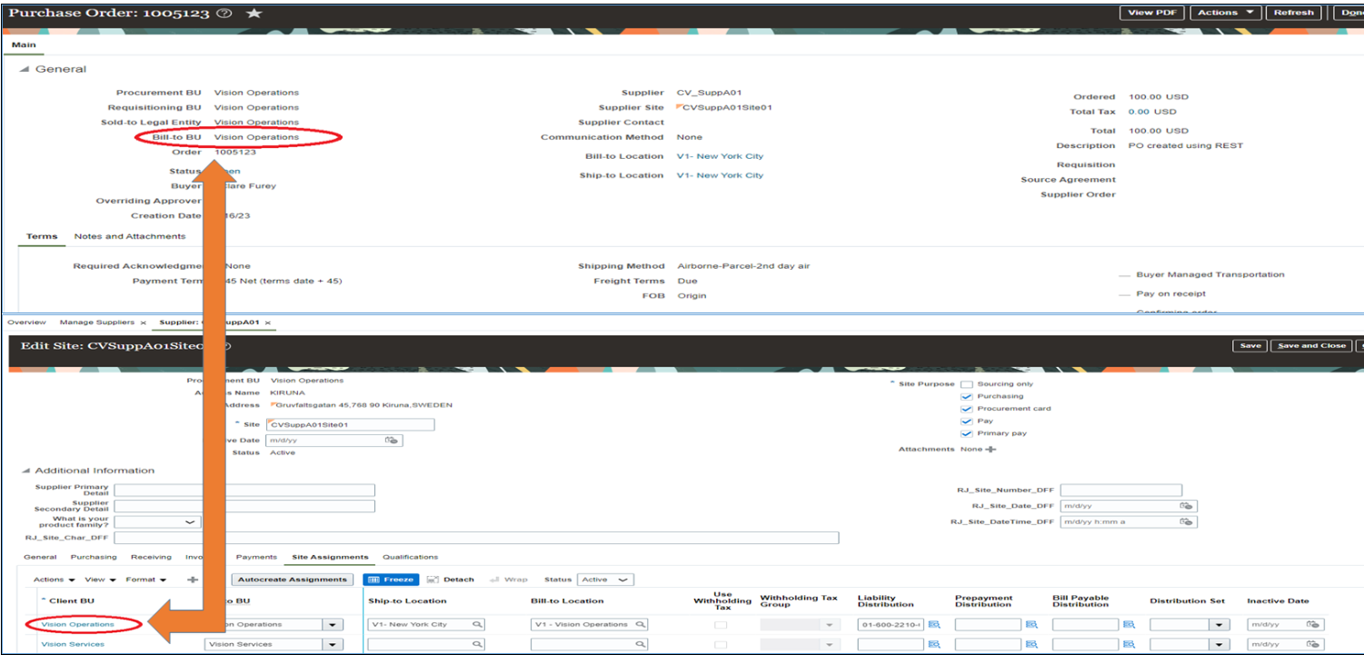

Supplier Site assignment against the Bill-To BU of the PO
Supplier Site Assignment Against the Bill-To BU of the PO

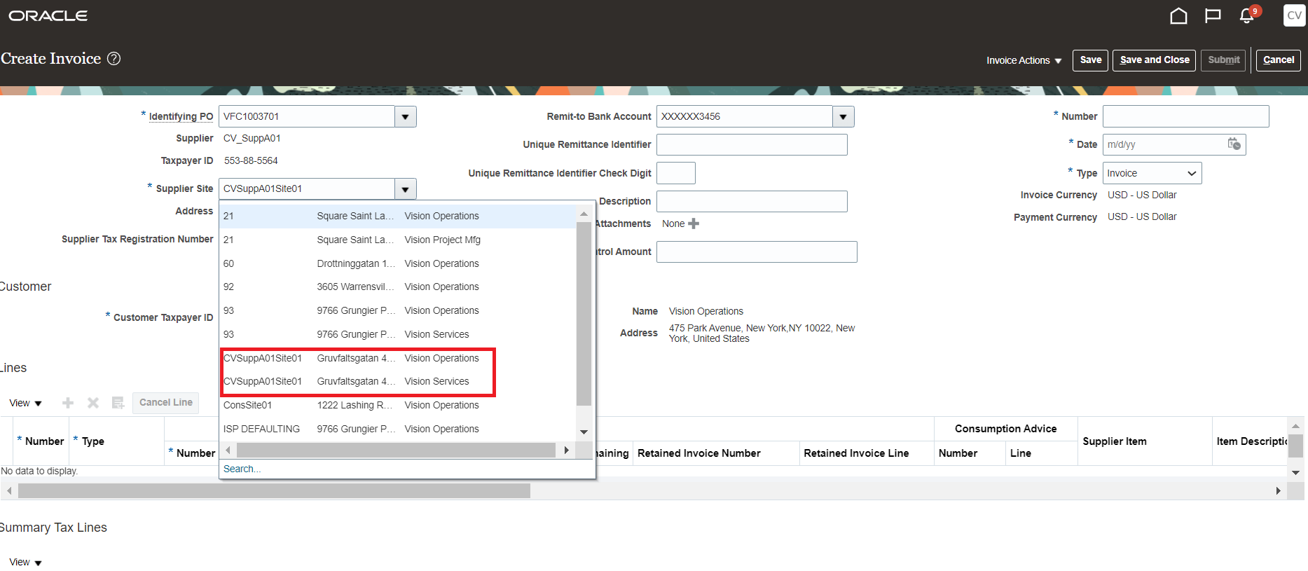

Supplier Site LOV in Supplier Portal before the change
Supplier Site LOV in Supplier Portal Before the Change

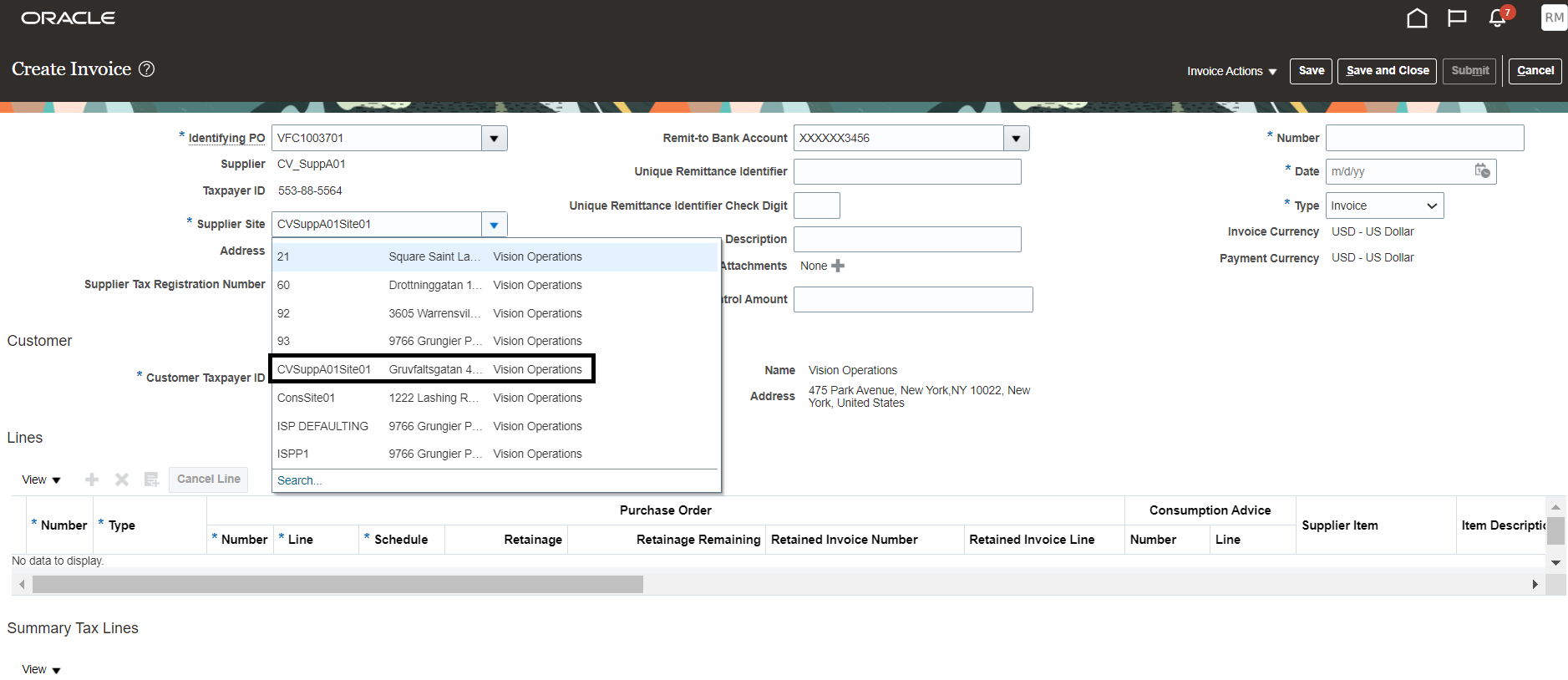

Supplier Site LOV in Supplier Portal after the change
Supplier Site LOV in Supplier Portal After the Change
