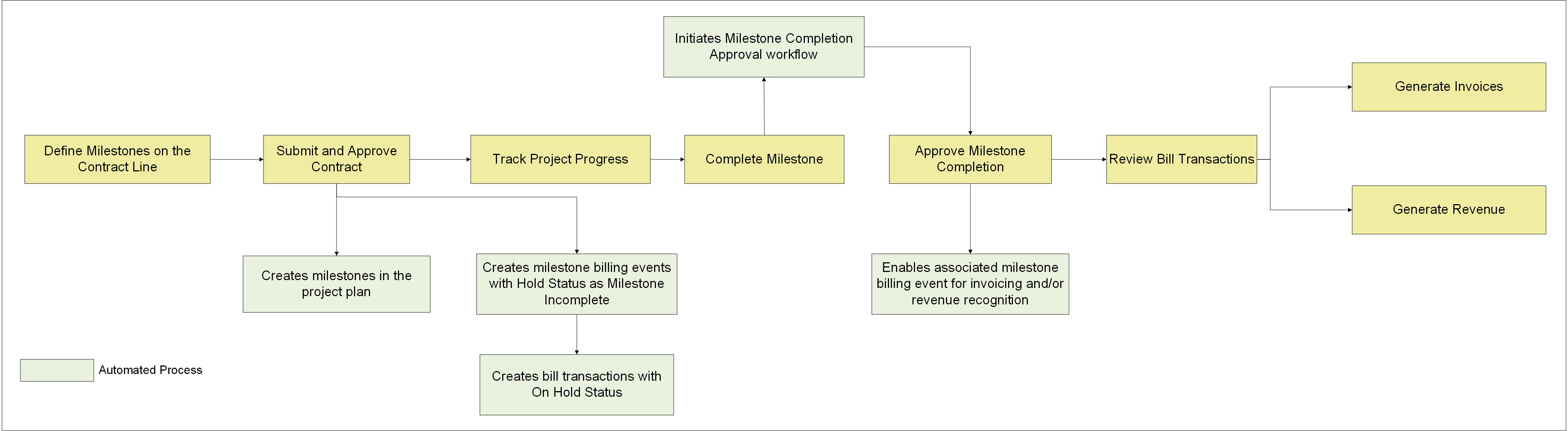

Milestone Billing and Revenue Recognition High-Level Process Flow
The following example illustrates at a high level the solution offered by this feature:

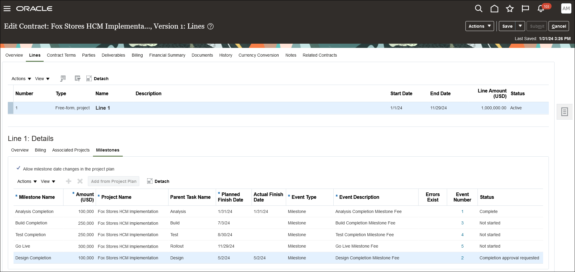

  • The contract administrator creates the contract and contract lines. In this example, the total value of the contract is $1,000,000.  As negotiated with the customer, billing is to be performed based on completion of each milestone, and the contract administrator enters the milestone details as below. Optionally, if milestones already exist in the associated project, they can be added to the contract line using the Add from Project Plan action. The Event Type chosen for a milestone determines whether the corresponding billing event is used for invoicing, revenue recognition, or both. The Eligible for invoicing and Recognize revenue indicators for the event type are available columns to display in the Milestones tab, but these are not shown in the below screenshot.
Milestones Tab on the Contract Line

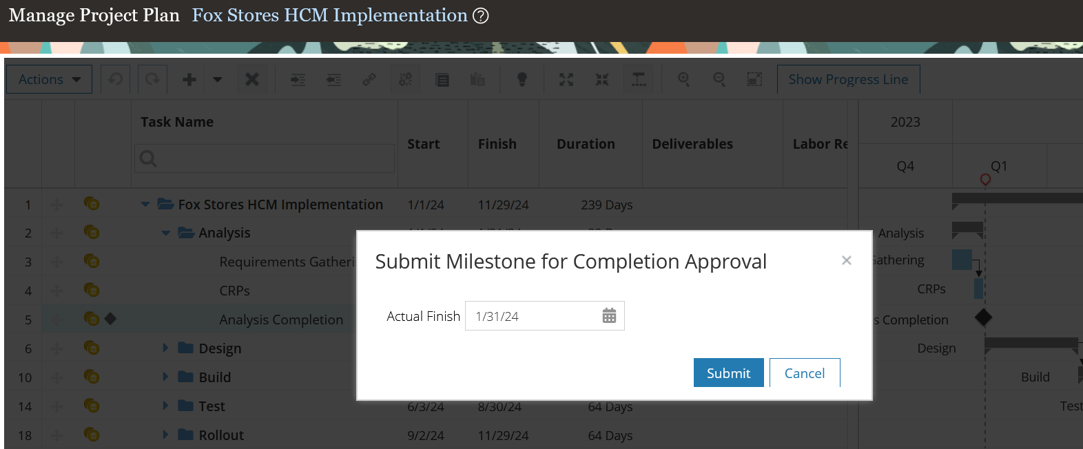

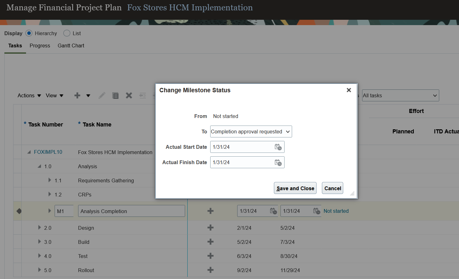

  • The project manager initiates milestone completion approval when a milestone is complete. Perform this action using the work plan or financial project plan.
On the Manage Financial Project Plan page, use the Change Milestone Status dialog window to update the milestone status and actual dates. On the Manage Project Plan page, specify the milestone actual dates directly in the Actual Start Date and Actual Finish Date columns and change the milestone status either by updating the actual dates or percent complete or Complete Milestone contextual action.
Initiate Milestone Completion Approval from the Manage Project Plan Page
Initiate Milestone Completion Approval from the Manage Financial Project Plan Page

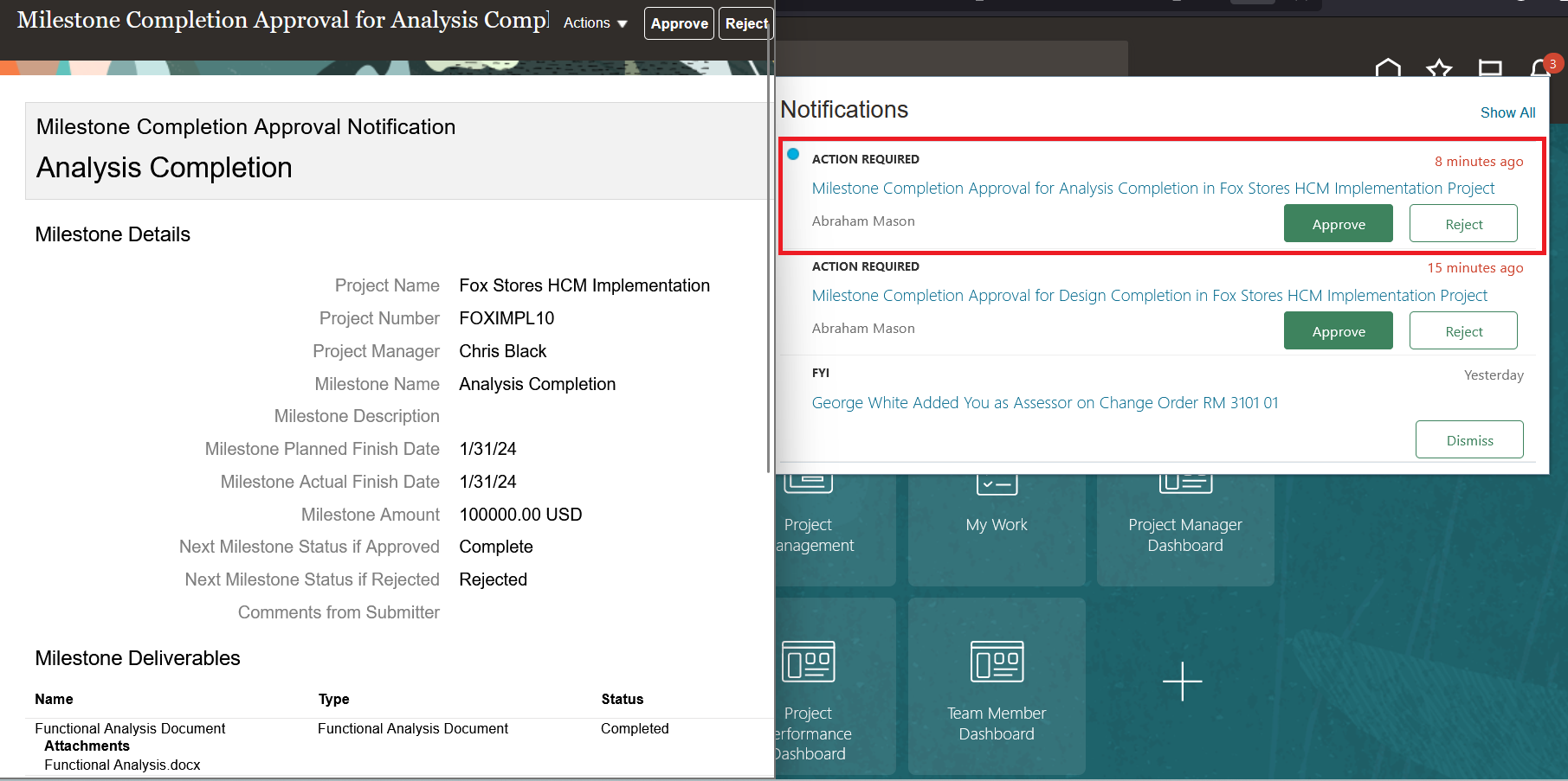

  • The approver reviews the milestone details and deliverables and approves the milestone completion.
Review Milestone Details and Approve from the Milestone Completion Approval Notification

Current Status of Milestones Displayed in the Milestones Tab on the Contract Line

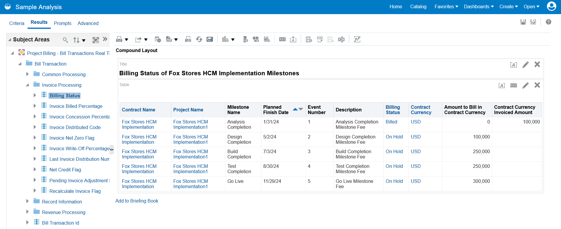

  • Project managers and project billing specialists can analyze the billing status of milestones using reports and dashboards in Oracle Transactional Business Intelligence. Report WIP in real-time using the new status attribute introduced in the Work-in-Progress by Billing Status Analysis Using OTBI feature also introduced in the 24B update.
Sample Milestone Billing Status Analysis Using the Project Billing - Bill Transactions Real Time Subject Area
