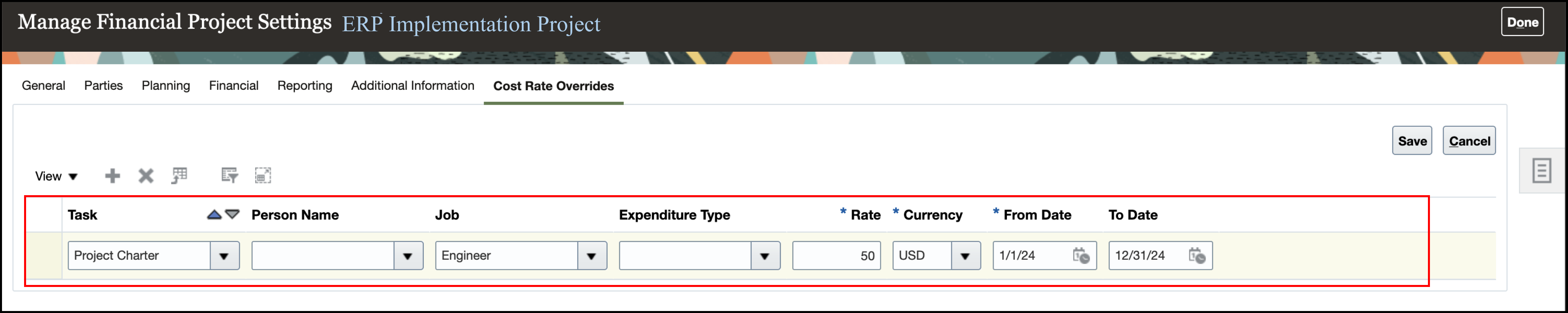

For example, to create a Cost Rate Override for a Task and Job combination, the sample payload would be:
"ProjectName" : "ERP Implementation Project",
"TaskName" : "Project Charter",
"JobName" : "Engineer",
"Rate" : 50,
"CurrencyCode" : "USD",
"FromDate" : "2024-01-01",
"ToDate" : "2024-12-31"
The rate override created with the REST API call above will be reflected in the Cost Rate Overrides UI as shown below:
Cost Rate Overrides on the Manage Financial Project Settings Page

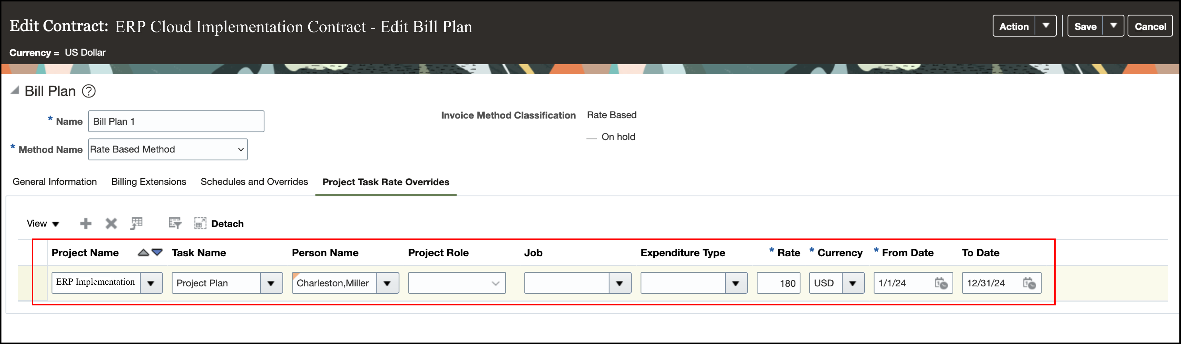

Similarly, to create a Bill Rate Override for a Project and Task combination, the sample payload would be:
"ContractNumber" : "ERP Cloud Implementation Contract",
"BillPlanId" : 300100580156886,
"ProjectName" : "ERP Implementation",
"TaskName" : "Project Plan",
"PersonName" : "Charleston, Miller",
"Rate" : 180,
The rate override created with the REST API call above will be reflected in the Project Task Rate Overrides UI as shown below:
Project Task Rate Overrides on the Bill Plan Page
