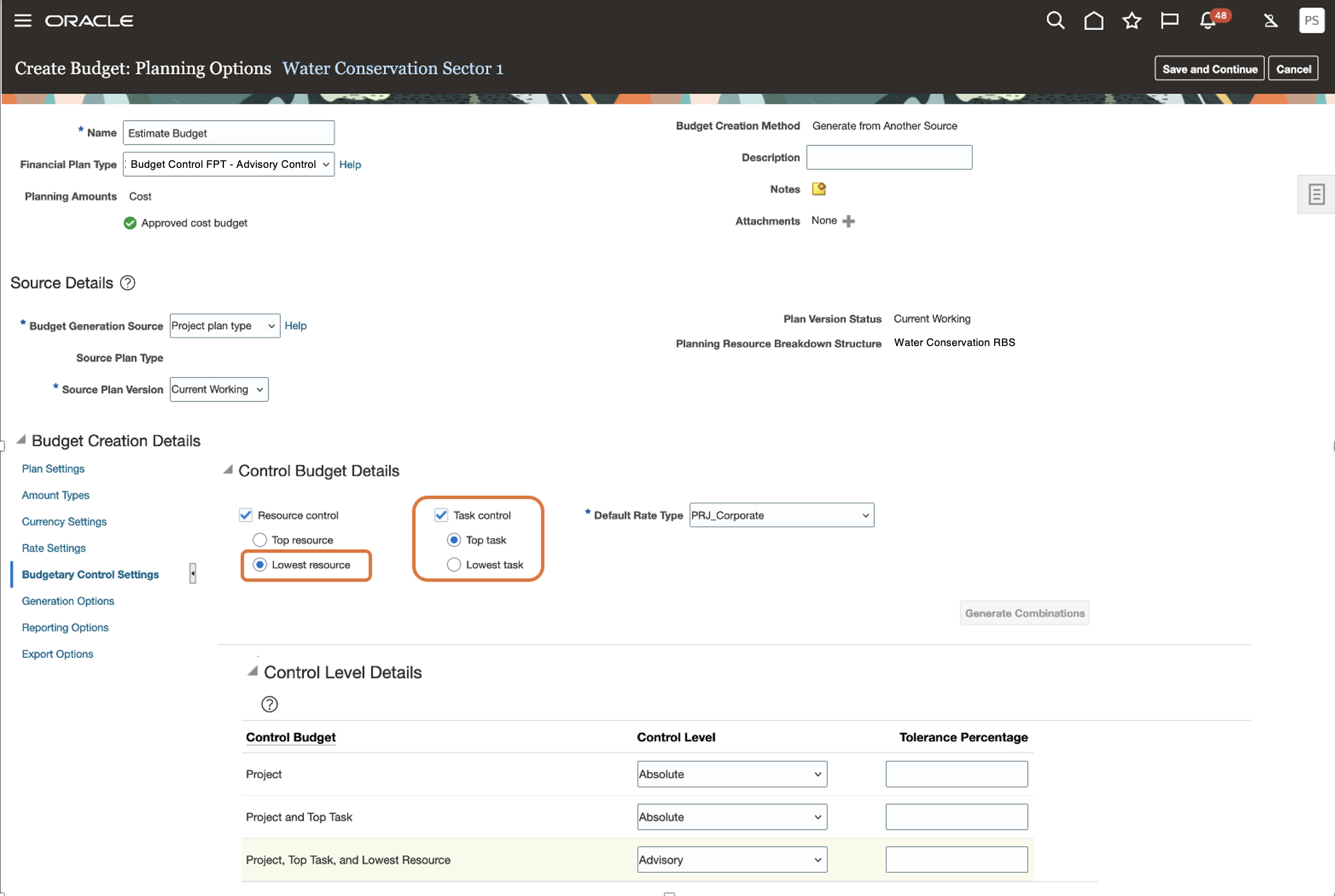

To define the budgetary control by task or resource for a project, select the appropriate budgetary control settings on the planning options while creating the project budget.
  • Select the Resource Control option to indicate whether to control costs for top resources or lowest resources. For example, set controls for specific types of costs or named persons. Alternatively, set controls at a top resource for an organization or cost category.
  • Select the Task Control option to control costs for top tasks or lowest tasks.
  • After selecting the resource and task controls, generate the control budget combinations. For sponsored project budgets, additional control by funding source is available.
    • Select both the Control Level (Absolute, Advisory or Track) and Tolerance Percentage for the control budgets based on the need for controlling costs.
Manage Project Budget Planning Options

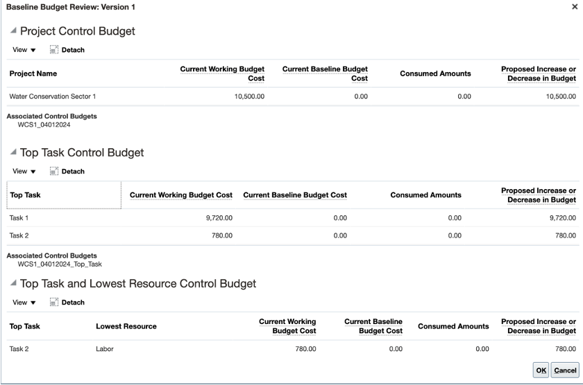

  • The control budgets listed under Control Level Details are created when the budget is set to baseline. Use the Baseline Budget Review dialog box to review and validate the current working budget cost, current baseline budget cost, consumed amounts, and the proposed increase or decrease in budget amounts for the respective control budgets.

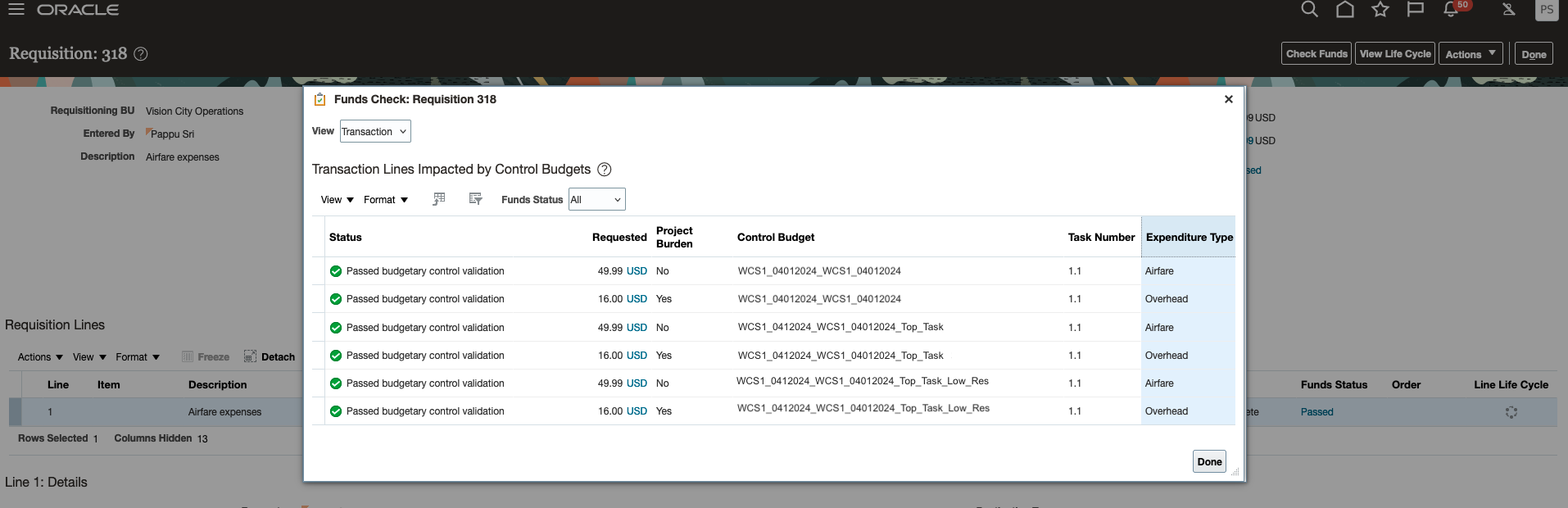

Once the budget is set to baseline status, any applicable charges for the project are subjected to budgetary control validation. All applicable control budgets are validated for both raw and burdened costs. The View Funds Results dialog box shows the budgetary control validation results.
View Funds Results for Requisition

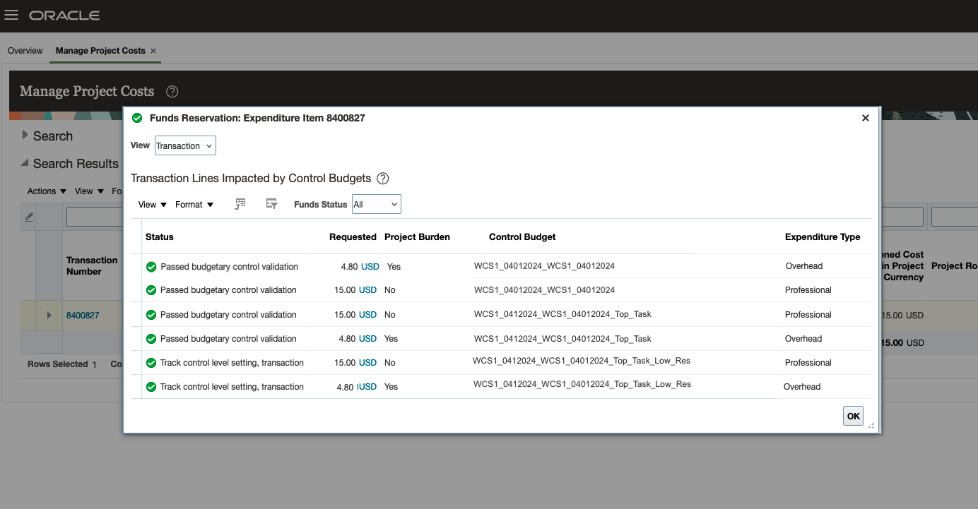

Here's an example of a labor cost in the Manage Project Costs page with the budgetary control validation results.
View Funds Results for Labor Cost in the Manage Project Costs page

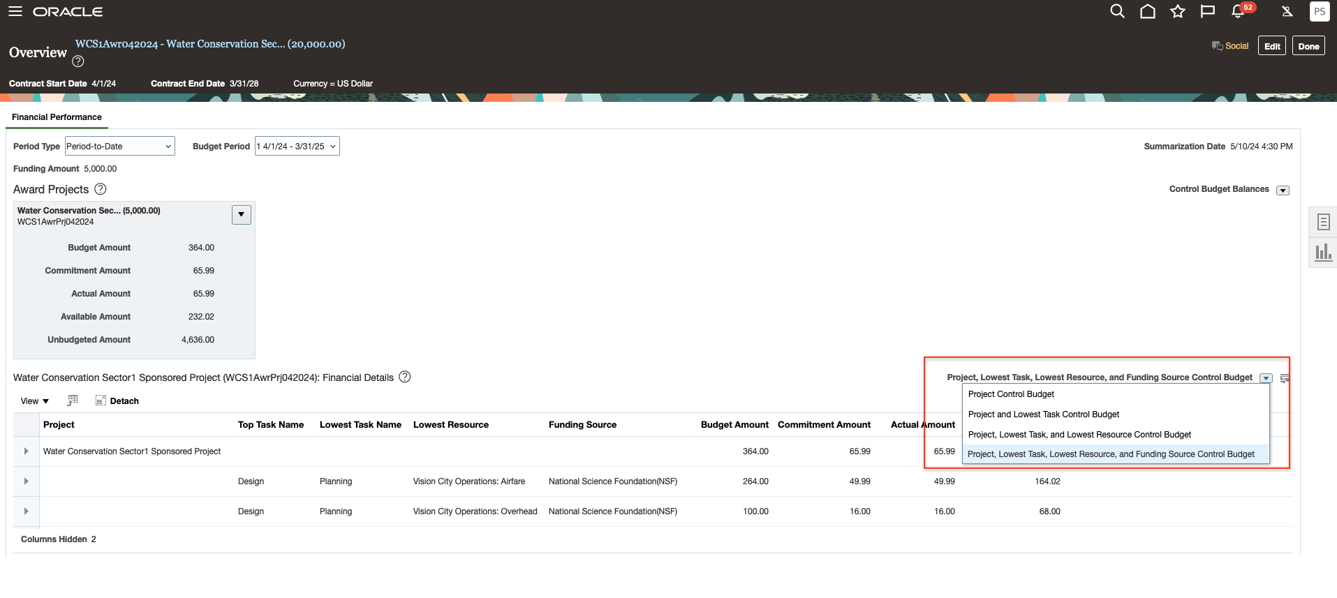

Additionally, for sponsored projects, the Award Overview page provides the available funds details for all the control budgets, including the control budgets based on the new segments of task and lowest resource.
Control Budget Balances in the Award Overview page
Export to Excel is now available for the Financial Details table in the Award Overview page.

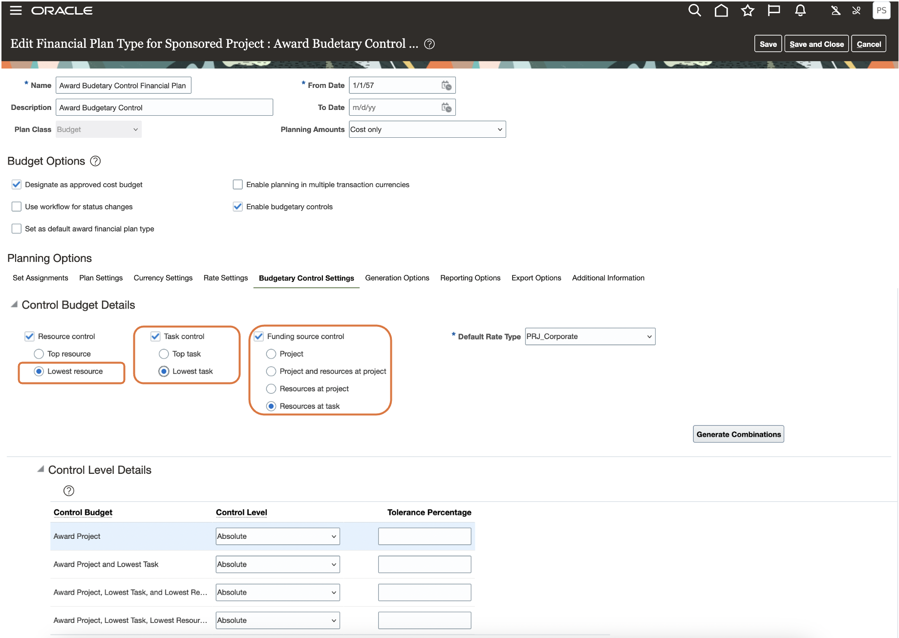

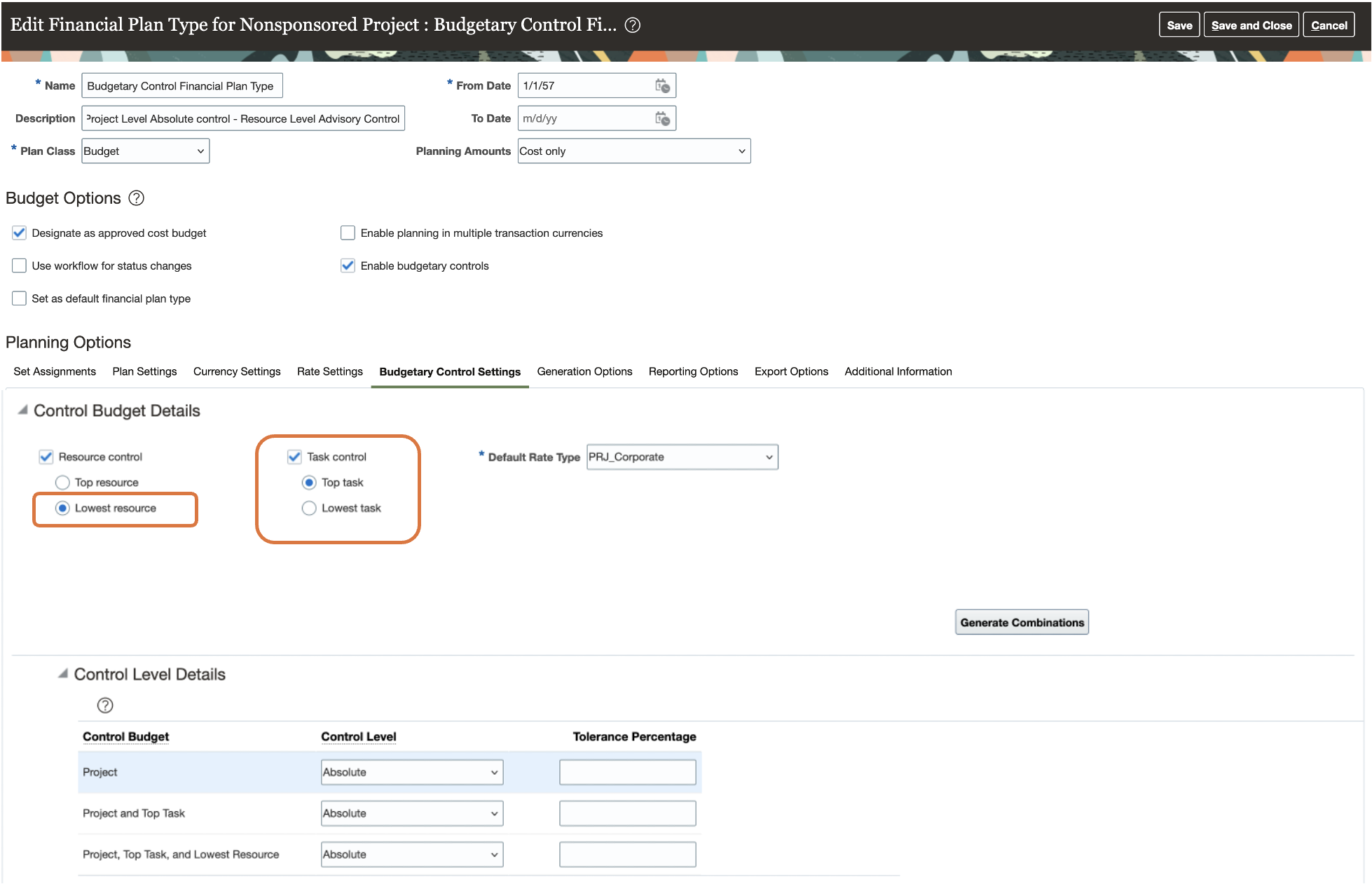

Steps to Enable
  • To create task level control or lowest resource control, select the options on the existing financial plan type in the Manage Financial Plan Types page.
  • Use the planning options under Budgetary Control Settings to define the new controls.
Nonsponsored Financial Plan Type
Sponsored Financial Plan Type
  • If you've made any changes to the control budget options in the financial plan type, then it will be defaulted to any new project budgets being created.
  • Select Generate Combinations whenever the default control budget segments, such as top resource or lowest resource, are modified. Once the control budgets are listed, you can select the appropriate control levels and the tolerance percentage for each of the control budgets.
