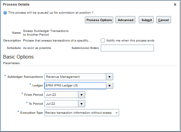

Parameters of the process:
- Subledger Transactions: Select the subledger whose transactions you want to sweep. You can select either Receivables or Revenue Management depending on your access and requirement.
- Ledger: Select the ledger whose transactions you want to sweep.
- From Period: Select the Close Pending accounting period from which you want to sweep the invalid transactions
- To Period: Select the Open or Future Enterable accounting period to which you want to sweep the invalid transactions
- Execution Type: Select either Review transaction information without sweep or Sweep transactions to next accounting period.
- Review: Runs the process to review the invalid transactions from the selected Close Pending accounting period without actually sweeping them to the selected Open or Future Enterable accounting period.
- Sweep: Runs the process to sweep the invalid transactions from the selected Close Pending accounting period to the selected Open or Future Enterable accounting period.
