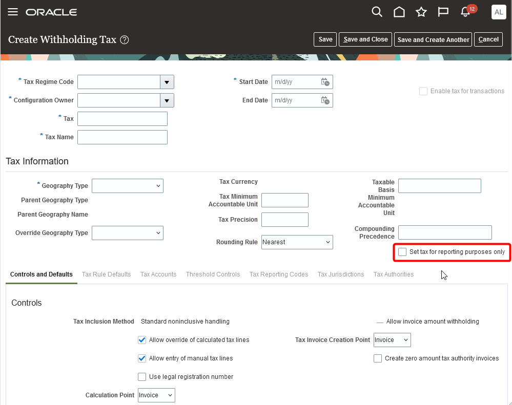

When you create a new withholding tax, enable the "Set tax for reporting purpose only" option to indicate that this withholding tax is for reporting purposes only. Enabling this option ensures that the tax is not accounted and doesn't affect the transaction totals.
Create Withholding Tax page
