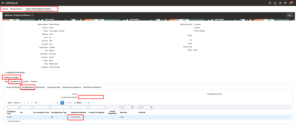

For the Supplier, you must enter the Tax Registration Number at the Address level, so that the report can extract the Country code and the TRN.
Navigate to Procurement > Suppliers > Manage Suppliers > Supplier > Addresses > Address > Transaction Tax > Tax Registration.
Supplier country and TRN setup

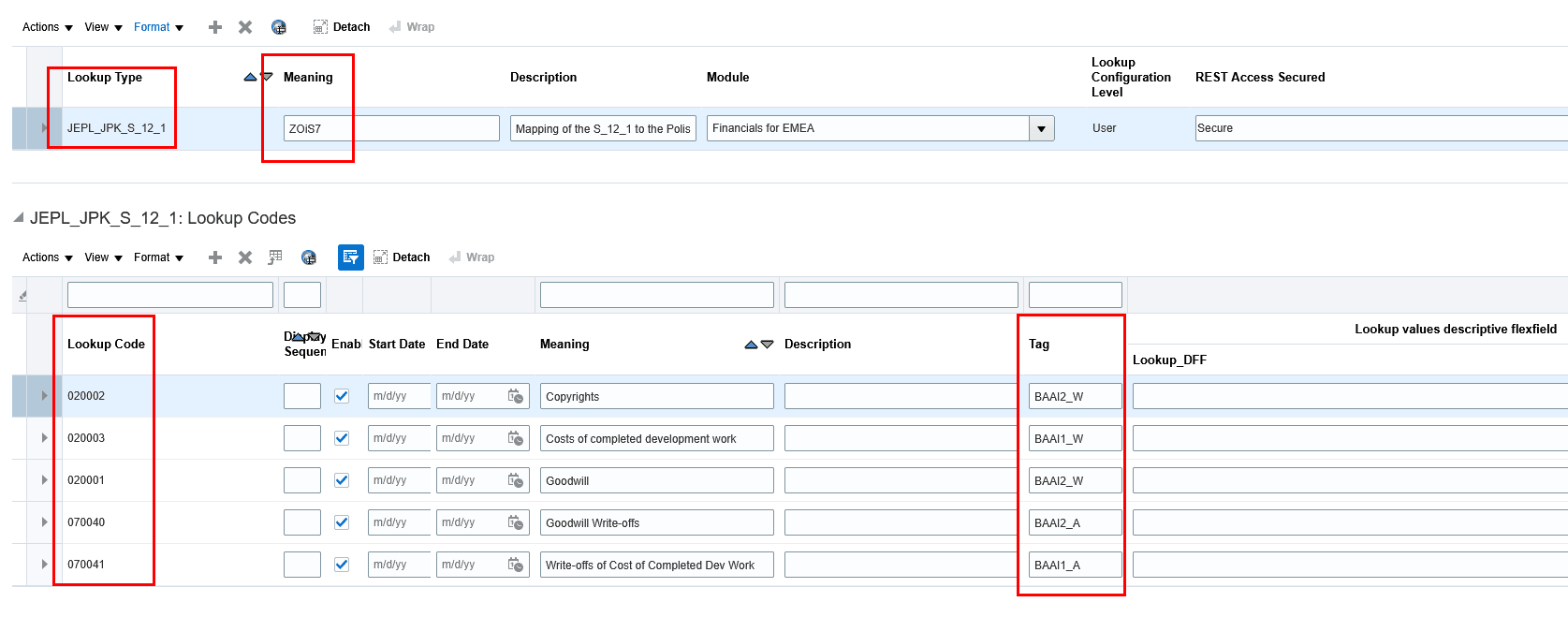

For the Account classification requirements, you must create the Standard lookups indicated below. The values for these lookups are not inherited during transaction and journal creation, and they do not need to be created at the beginning of 2025 operations. They must be in place by the end of December 2025, when the new reporting format extracts 2025 data in January 2026.
The ZOiS classification will be identified by the Description field of the lookup used for the S_12_1 classification. In this example, you must define lookup as JEPL_JPK_S_12_1 and the Meaning column value as ZOiS7 – for other entities. Similarly you must create Standard lookups: JEPL_JPK_S_12_2 and JEPL_JPK_S_12_3, which are not mandatory but depend on the implementation. These standard lookups have similar logic but you should not enter a ZOiS value under the meaning column.
Navigate to Setup and Maintenance > Manage Standard Lookups. Create new lookup type:
- Lookup_Type to be created: JEPL_JPK_S_12_1
- Form of Lookup code: The Natural account you are using.
- Meaning: is the description of the natural account
- Tag: the code given by the Polish tax authorities for this ZoiS type of industry, corresponding to the natural account in the lookup code.
JE_JPK_S_12_1

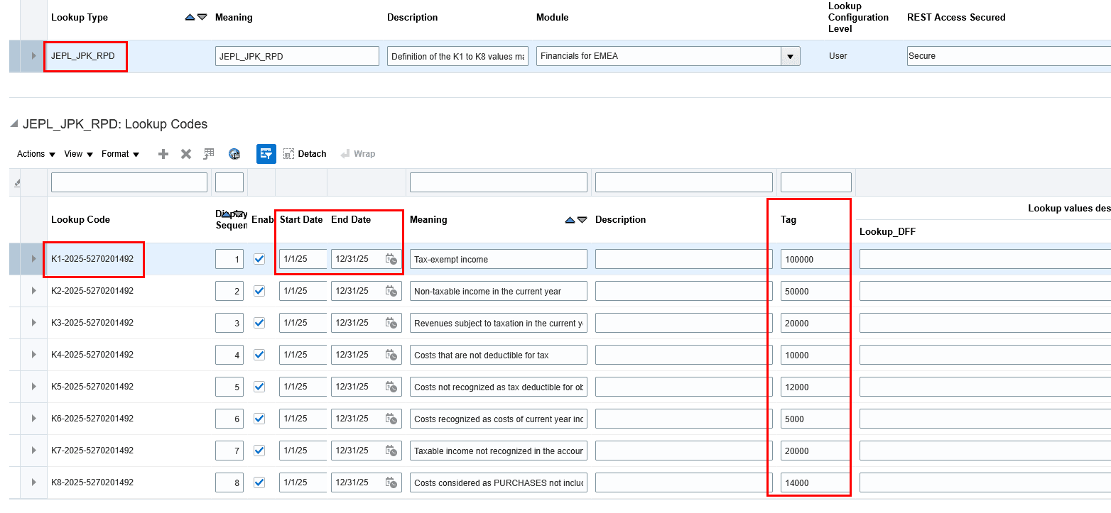

For the Tax block to be present in the report, create the JEPL_JPK_RPD standard lookup type and enter the tax-related values that were defined externally in the Tag column of the lookup. The details will be included in the Topical Essay for JPK_CIT.
- Lookup_Type to be created: JEPL_JPK_RPD
- Form of Lookup code: K1-2025-5270201492, where K1 is the JPK xml tag, 2025 is the fiscal year of reference and 5270201492 is the TRN of the LRU you are running the JPK_CIT for.
- The Start-Date , End-Date columns also define the period of reference of the lookup codes. Example of the standard lookup for the tax elements:
JEPL_JPK_RPD
