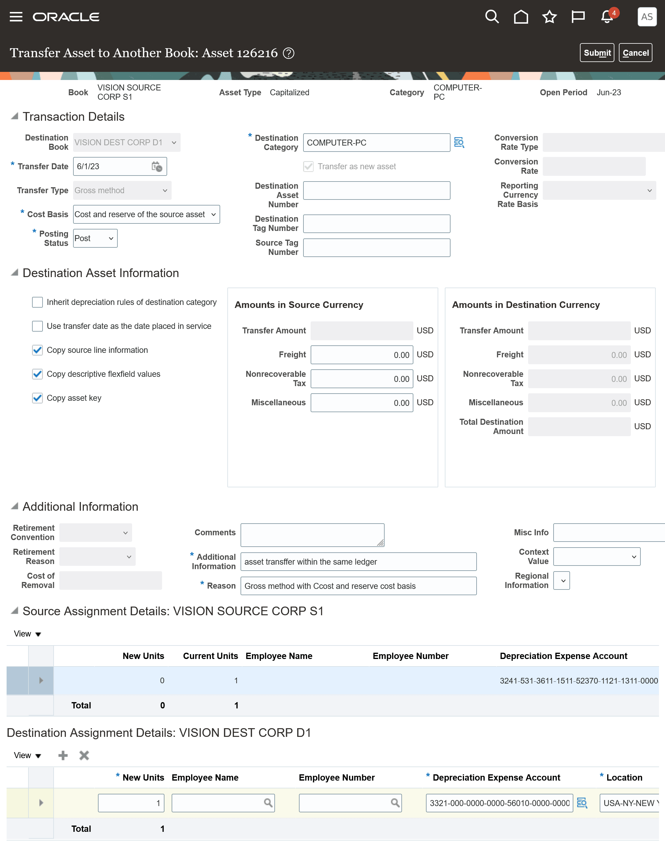

During the transfer, use either of the following cost basis types to determine the cost and accumulated depreciation in the destination book.
- Cost and Reserve of the source asset: The destination asset balances are initialized with the cost and reserve amount of the source asset.
- Net book value of the source asset: The destination asset cost is initialized with the net book value of the source asset. The depreciation reserve is initialized to zero.
The depreciation reserve for the transferred asset is determined based on the accumulated reserve balance from the period before the transfer period.

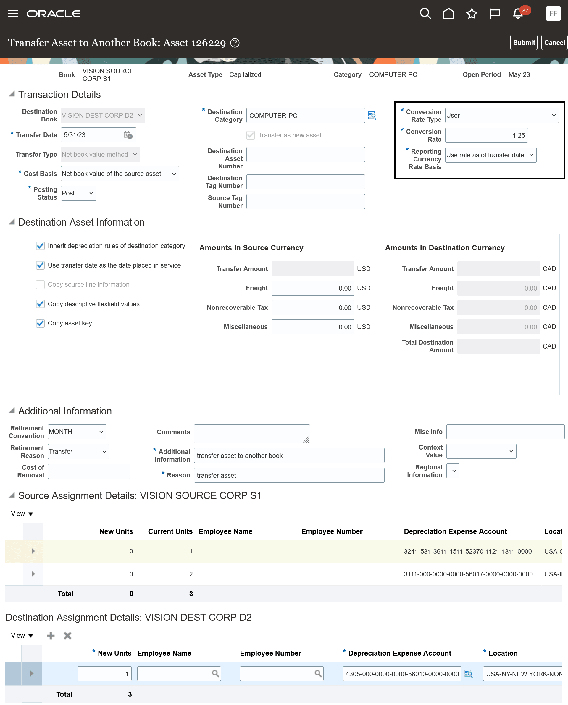

Transfer asset to another book
When transferring an asset, you can choose a different asset category for the destination book. You can either keep the depreciation rules from the source asset or opt for those of the destination book and category. The date placed in service for the new asset can be set as the original asset's date placed in service or the transfer date. You can backdate the transfer date, as long as it follows the asset's latest transaction. During the transfer, you can conveniently copy source line details, descriptive flexfield values, and asset key information.
The asset number in the destination book must be unique and can either be generated by application or you can define it manually. Additionally, the tag number should be distinct across all books, and you can decide to retain the tag number for either the source or destination asset. Each tax book requires an independent transfer process: the transfer isn't copied from the corporate book.
During the transaction process, you can record additional charges such as removal costs, freight charges, non-recoverable taxes, and miscellaneous fees. All charges except removal costs are capitalized in the destination asset and are included in the intercompany Receivables amount, which the receiving entity owes.
As expected, the depreciation expense account, location and employee information can be changed at the time of transfer to the destination book.

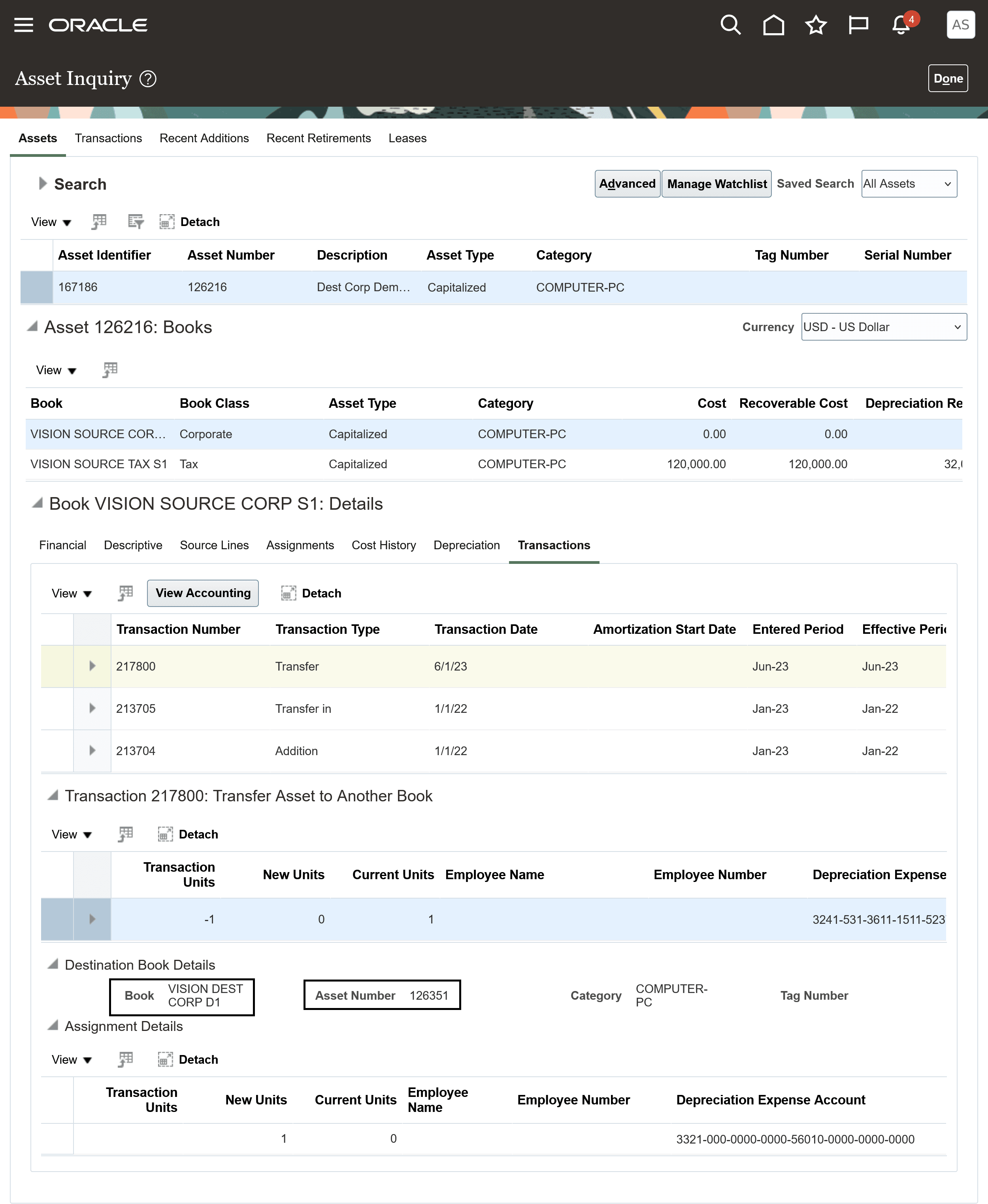

Asset Inquiry
The details of the asset number and the destination book to which the asset is transferred can be viewed from the Asset Inquiry page. You can also see the assignment details for the destination book.
Asset Inquiry Source Asset
Asset Inquiry Page

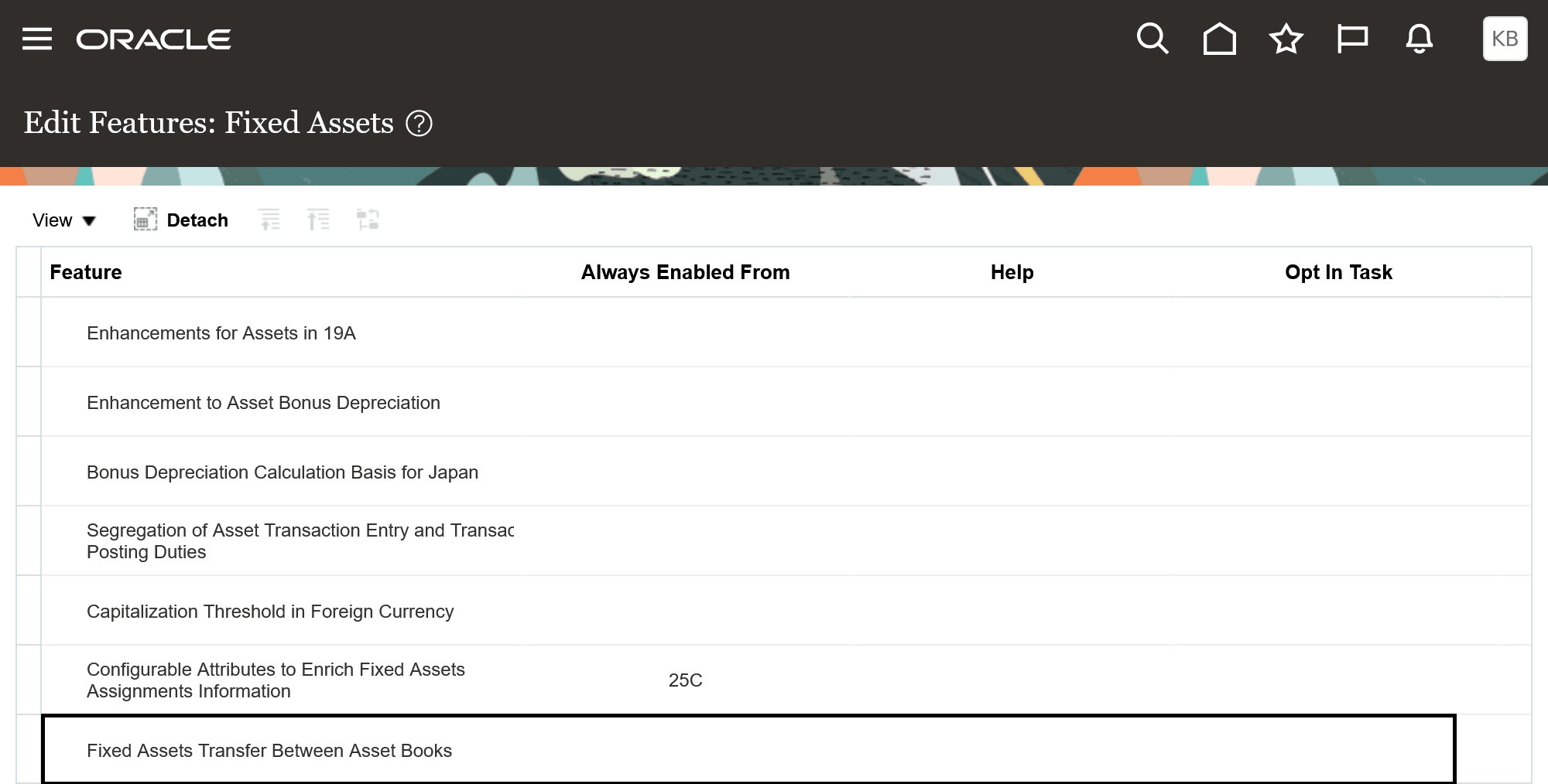

Steps to Enable and Configure
Use the Opt In UI to enable this feature. For instructions, refer to the Optional Uptake of New Features section of this document.
Offering: Financials No Longer Optional From: Update 26A
- Use the opt-in for Fixed Assets Transfer Between Asset Books in Financials to enable this feature.
- Setup and Maintenance > Financials > Change Feature Opt In > Fixed Assets> Edit Feature > Fixed Assets Transfer Between Asset Books feature in Financials.

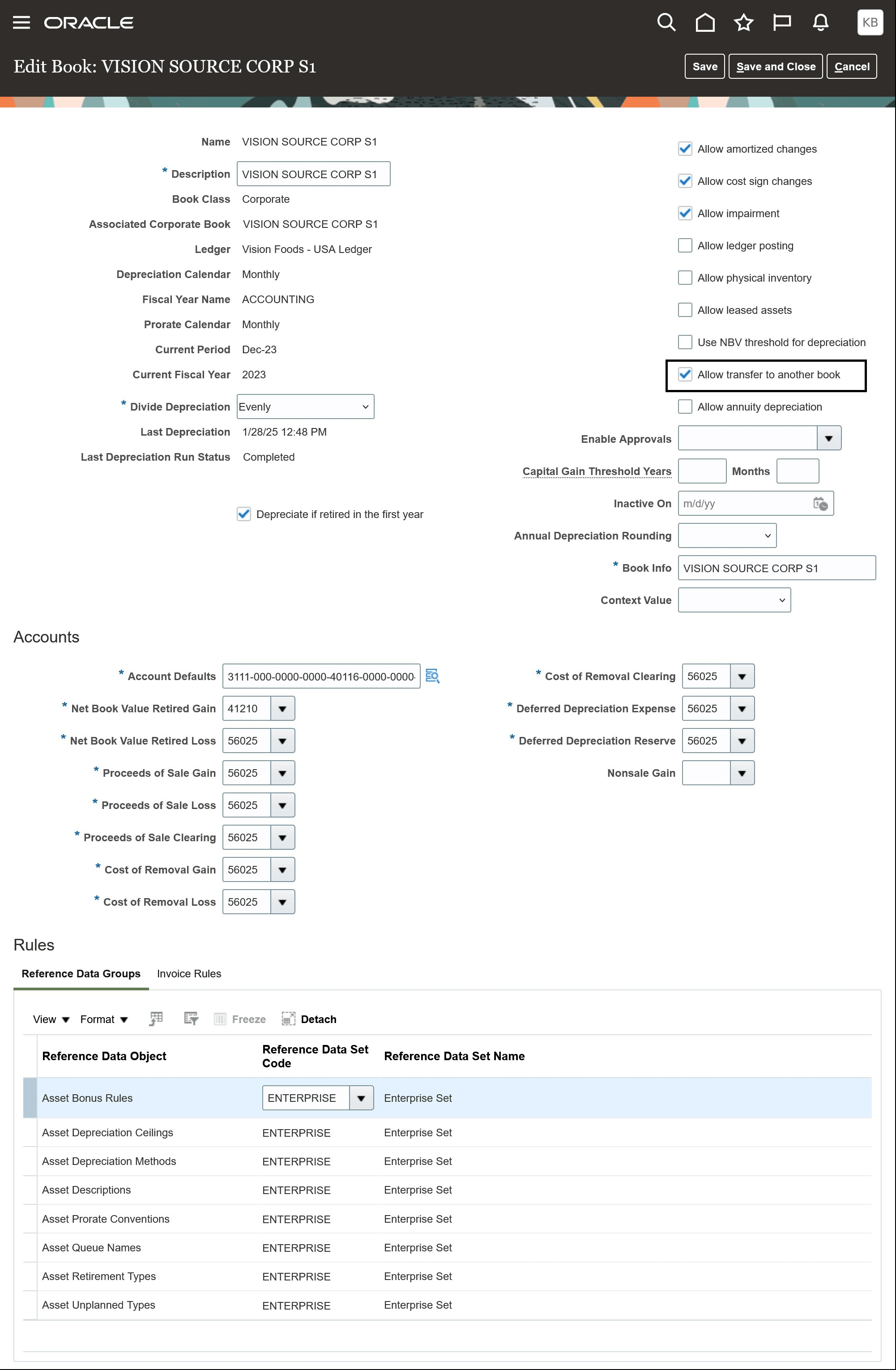

- Setup and Maintenance-> Manage Asset Books -> Select an asset book to Allow transfer to another Book

- To continue with the source asset’s life and depreciation rules, don't select the "Inherit depreciation rules of destination category" option and "Use transfer date as the date placed in service" option on the Transfer Asset to Another Book page.
- The transfer process needs to be executed individually in each of the tax books. The Mass Copy feature is not applicable for transfer across books.
- If the source corporate book has a higher number of tax books than the destination, you must manually retire the asset for tax books without a corresponding destination book. This can be done using the standard retirement feature. Conversely, when the destination has tax books without a source match, an asset addition is required in these books, which can be managed as a regular addition transaction.
- If the number of reporting currency books isn't the same in the source and destination, use the NBV method of transfer.
- This feature applies only to transactions performed using the Transfer Asset to Another Book page. Volume based book transfers aren't available in this release.
- The Intercompany Payables accounts and Intercompany Receivables accounts in the Manage Asset Books page can be populated using REST import and export services and can't be entered using the Create or Edit Asset Book page.
- This feature is limited to capitalized assets and doesn't apply to group assets and their members and to leased assets.
