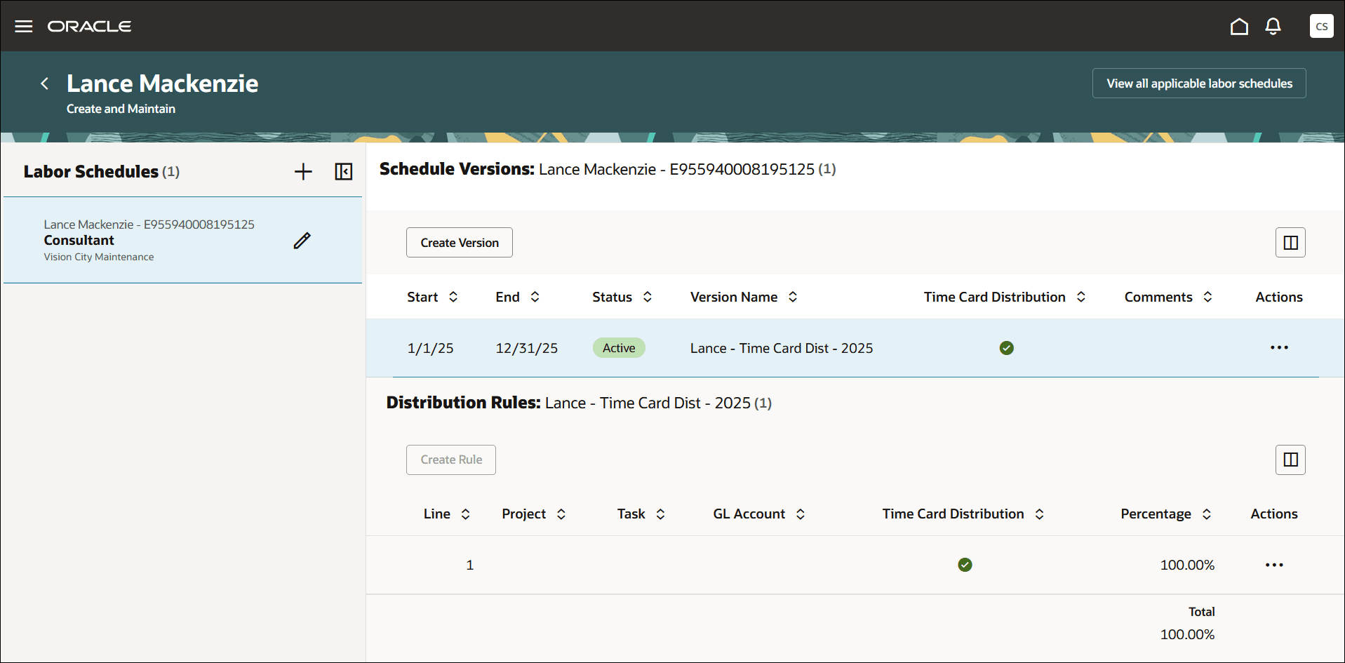

  1. Enable the Distribute Using Time Cards option when creating a new person assignment labor schedule version. A distribution rule specifying time card distribution as the basis is automatically created.
    Labor Schedule Version Enabled For Time Card Distribution

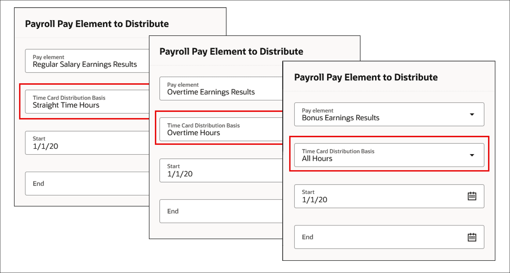

  2. Define the pay elements that you want to use when distributing costs from Oracle Fusion Payroll to projects and specify the new Time Card Distribution Basis for each. If you are importing payroll costs from third-party sources, you must specify the Time Card Distribution Basis for each payroll cost when loading into the interface table if these costs will be distributed to projects using the time card distribution method.
    Specify Which Target Time Cards Are Eligible For Each Pay Element Based on Expenditure Type Class

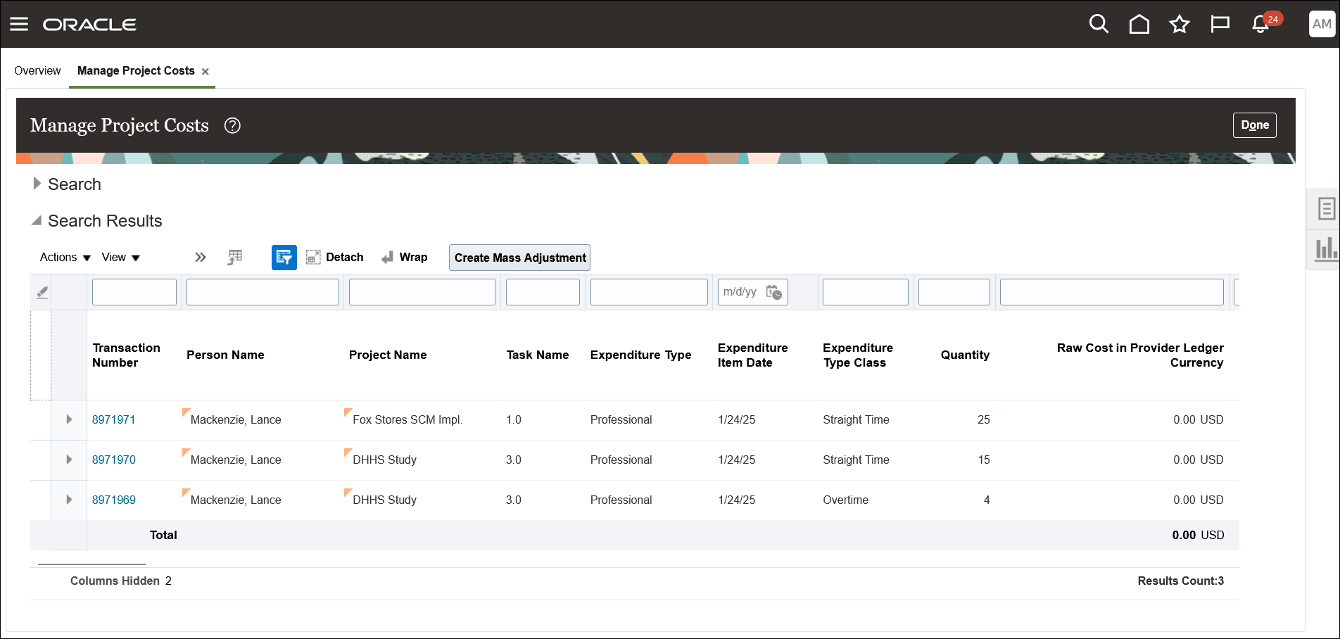

  3. Import time cards into Project Costing from either Oracle Fusion Time and Labor, Oracle Fusion Projects, or a third-party time reporting source. The Import Costs process determines whether a time card transaction being imported is eligible to be recosted using distributed payroll actual costs. If it is, then the time card transaction is imported into Project Costing with a 0 cost rate, and its payroll costed status is Pending.
    Time Cards Pending Payroll Costing Have a Cost of 0
    NOTE: For a billable time card transaction, if the pricing method is based on cost, such as the case for the cost reimbursable method, then "The transaction isn't billed because billing is based on raw or burdened cost that's zero. (PJB_ZERO_COST)" billing exceptions will be raised for time cards that are pending payroll distribution when bill or revenue transactions are created. Consider setting these transactions to Nonbillable or placing a billing or revenue hold on them until they are successfully costed using distributed payroll actual costs in order to prevent or remove the undesired PJB_ZERO_COST billing exceptions.

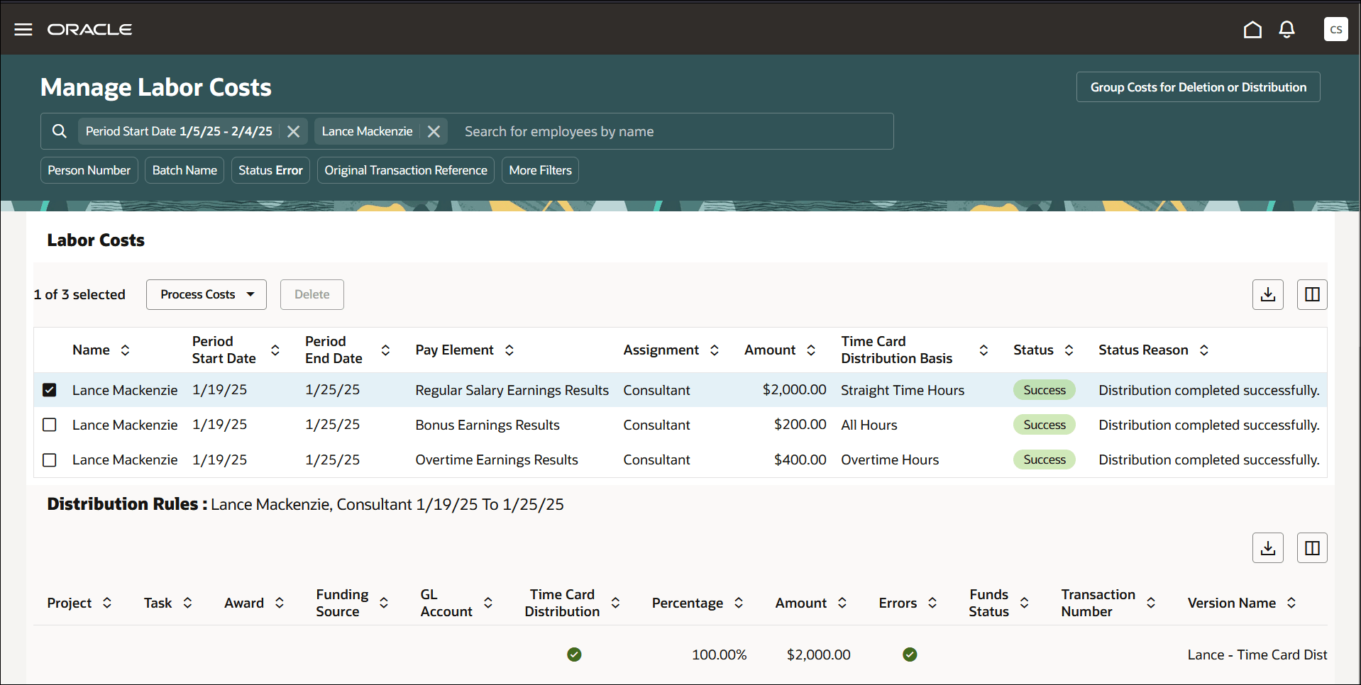

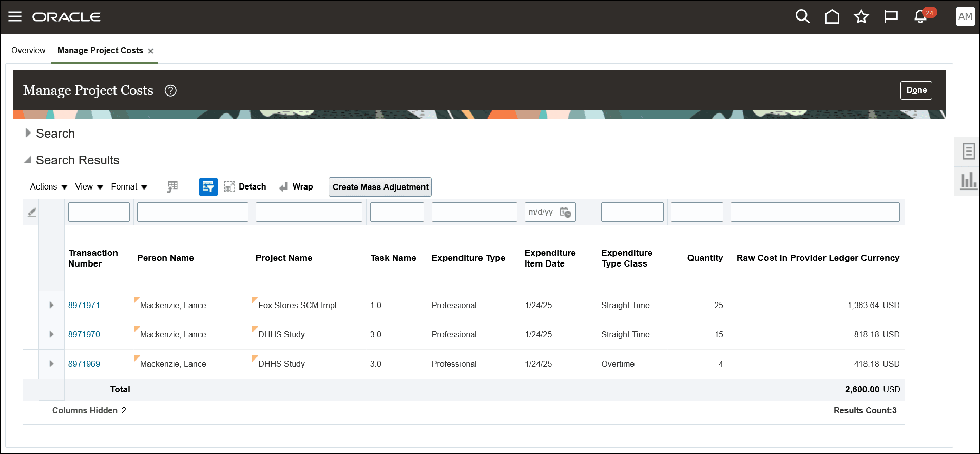

  5. Schedule the Import Payroll Costs process to distribute the payroll as defined. For time card distribution, all payroll costs for a specific person assignment in the payroll period are summarized by time card distribution basis. The target time cards in Project Costing are identified, and the total amount that each target transaction should receive is calculated, and each transaction is then recosted using a new Distribute payroll costs adjustment type.
    Imported Payroll Costs Successfully Distributed to Time Cards
    Target Time Cards After Payroll Cost Distribution
