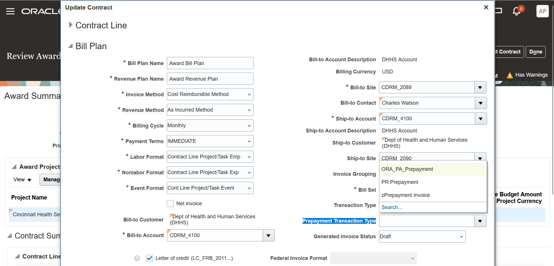

Specify prepayment transaction type when submitting contract from award. This prepayment transaction type is then used for prepayment request invoices generated for the award and sent to Receivables.
The new prepayment transaction type attribute can optionally be entered by a grants administrator in the Update Contract dialog box, as highlighted in the screenshot below. The prepayment transaction type list of values displays all the active Receivables invoice transaction types that have a transaction subclass of 'Prepayment'.

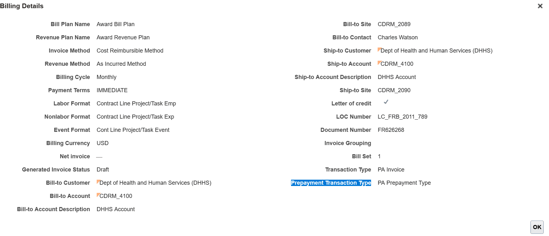

The prepayment transaction type attribute is also displayed in the billing details section of the award, as highlighted in the screenshot below.
A screenshot of the Prepayment Transaction Type field on the Award Billing Details page.

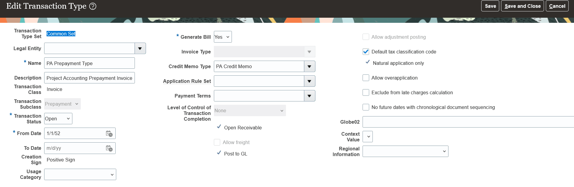

  • The transaction type set assigned to the prepayment transaction type should be identical to the set assigned to the Receivables transaction type reference data object at the business unit level.
            Receivables Transaction Type Setup
Business Unit Set Assignment
