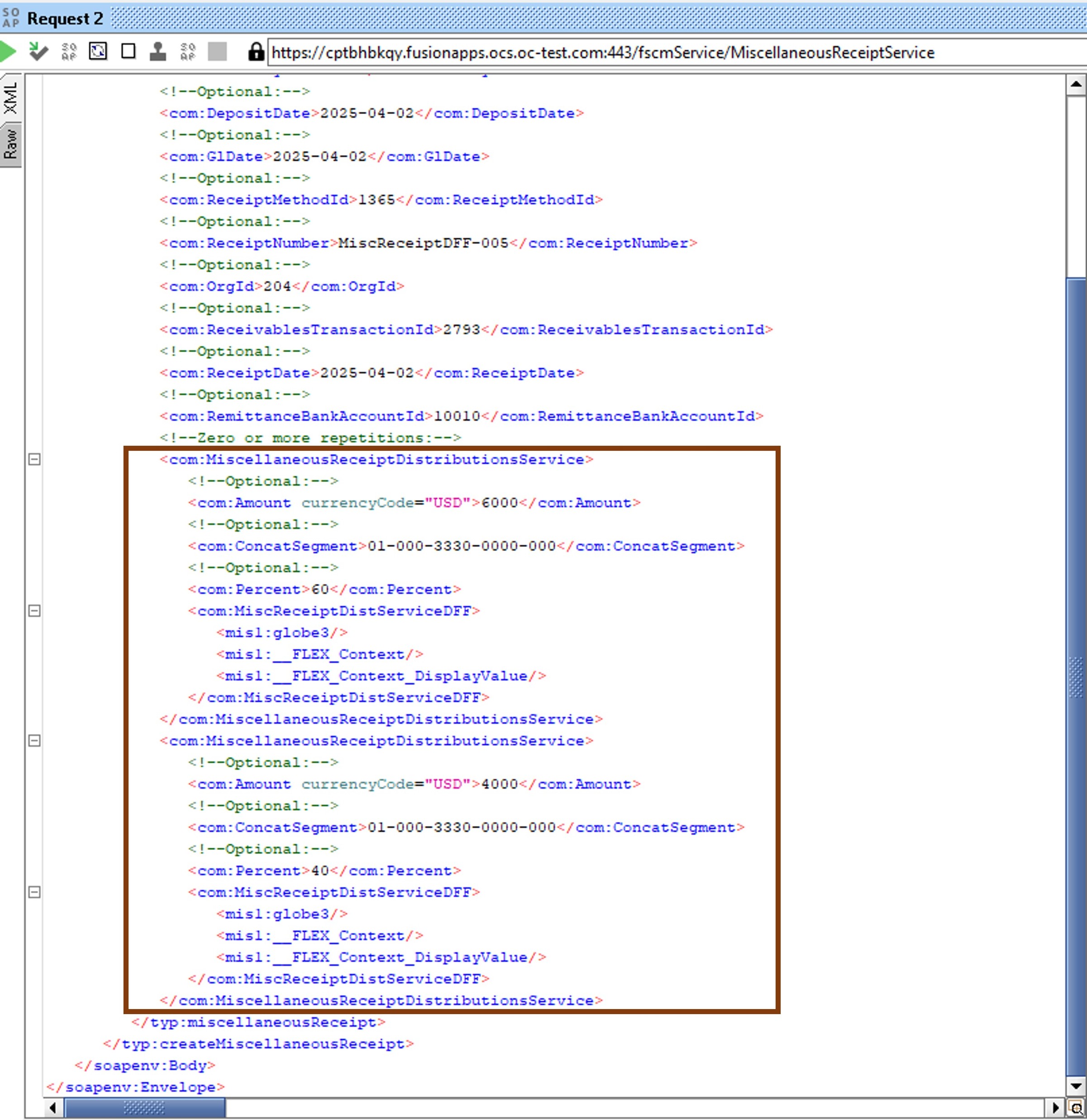

Sample Payload with Multiple Distributions

- Percentage across all distributions must equal 100% and MiscCashDistributions Amounts must equal the receipt total amount.
- All distributions must have a valid accounting code combination and must not be null.
- Receivable Activity must have the GL Account or Value Set defined when <MiscellaneousReceiptDistributionsService> section is empty.
- For distribution amounts without percentages assigned, percentage will be calculated accordingly based on entered amounts and receipt total amount.
- Duplicate Receipt Numbers are not allowed.
- Mixed Percentages and amount in the distributions are not supported. If percentages are provided, then distribution amounts will be calculated accordingly.
- When payload file does not contain Tax details then Receivable Activity Setup must include Tax Rate code, Tax Rate and Amount configured.
- Valid Cost Center must be entered in the payload.
- Delimiter must be correctly passed in the payload, for example when "-" is changed to a dot, 01.000.1110.0000.000 then miscellaneous receipt will not be created due to account structure.violation.
- Recommended maximum number of distributions per single receipt is 500.
