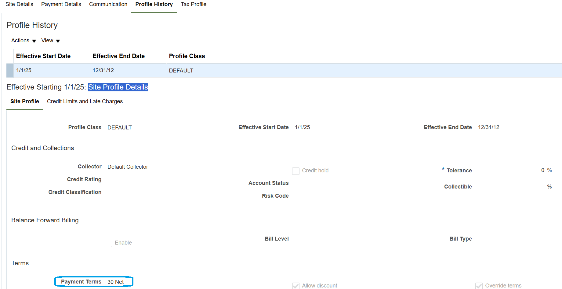

The '30 Net' payment term is set up in the Site Profile History using Manage Customers -> Sites, as highlighted below:

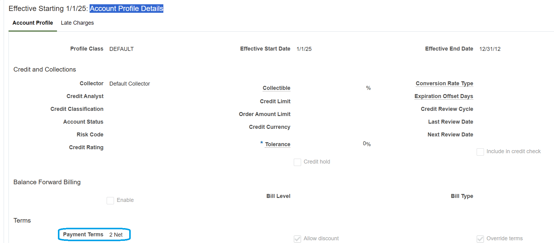

The '2 Net' payment term is set up in the Account Profile History using Manage Customers -> Accounts, as highlighted below:
Account Profile Details

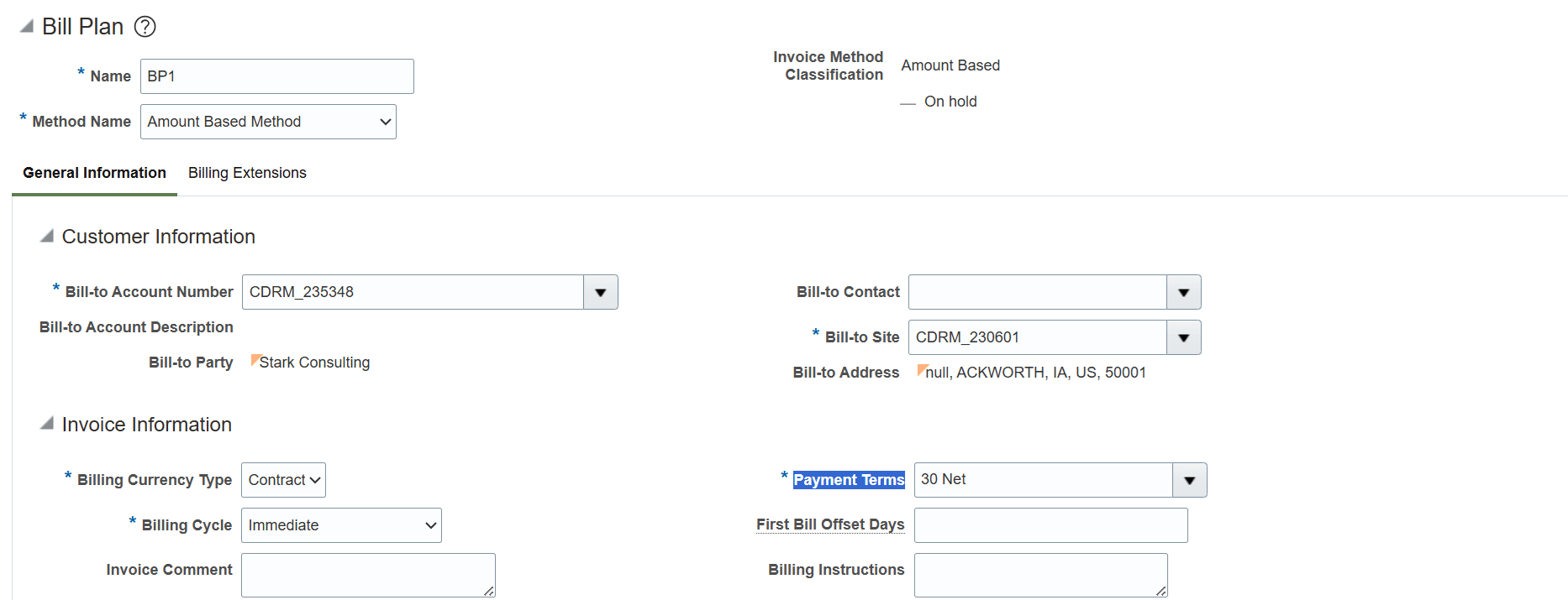

When a bill plan is created with the Bill-to account and Bill-to site specified in the Parties tab, the payment terms default to '30 Net' on the bill plan from the Site Profile History, as highlighted below:
Defaulted Payment Terms on the Bill Plan

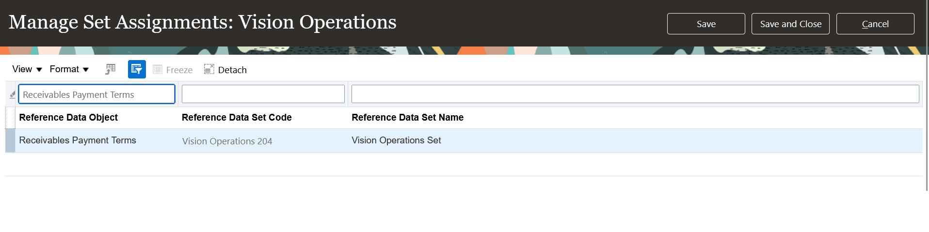

  • For payment terms to default onto the bill plan, the reference data set assigned in the Payment Terms setup must be identical to the set assigned to the Receivables Payment Terms reference data object at the Business Unit level, as highlighted below:
Payment Terms Reference Data Object
