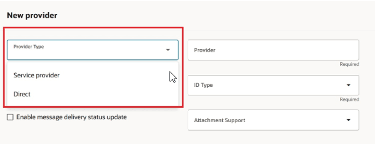

Define Your Providers
  1. Select B2B Connections from the Task Panel.
  2. Select the Providers tab to add a new provider.
    1. Select Direct or Service Provider as the Provider Type and add the remaining details.
  3. Click Save.
Add a Provider
Add a Provider

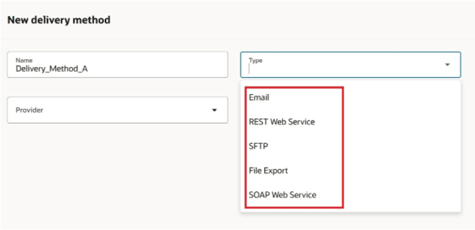

Configure a Delivery Method
  2. Select the Delivery Methods tab and add a new delivery method. Enter details for the delivery method.
  3. Delivery methods that are associated with a provider can only be used for that provider when creating connections. You don’t need to create delivery methods for B2B Adapter or Business Event. When you’re creating connections, you can select one of the values below for these delivery method types:
    1. ORA_B2BAdapter
    2. ORA_BusinessEvent
  4. Click Save.
Add a New Delivery Method

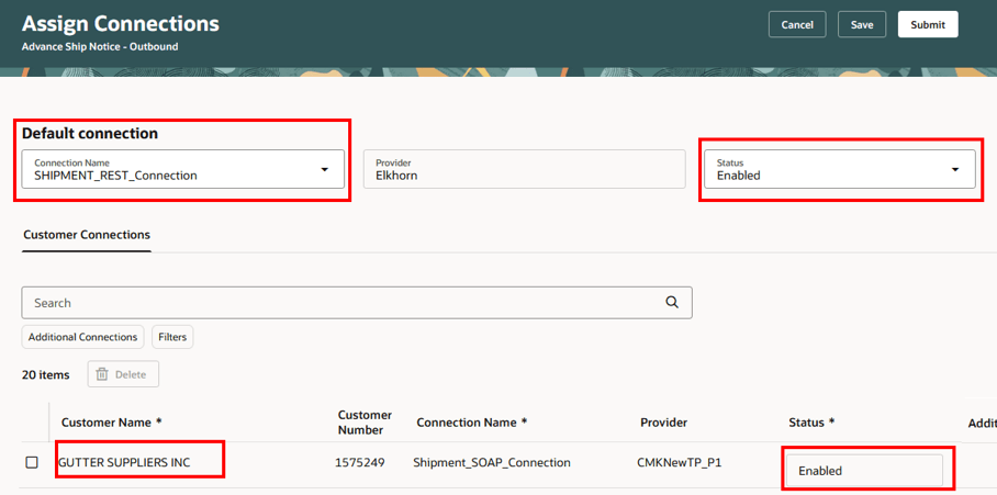

Assign Connections to Documents
  1. Select B2B Documents from the Task Panel.
  2. Select each order-to-cash document and set the Enabled field to Yes. Select Configure Document Properties to define any properties specific to the selected document.
  3. For outbound documents, you can configure the document so that you get the partner information from the payload for message processing.
    1. Enable the property group Partner identification from payload.
    2. Select Edit Properties and enter a value for Partner ID path. You can also enter a value for Partner ID type path. If you don’t enter a value, the partner ID type Generic is used.
    3. Click Submit.
  1. For order-to-cash inbound documents, you can configure the document so that the Load Interface File for Import scheduled process is submitted on receipt of purchase orders.
    1. Enable the property group Document properties.
    3. Select Initiate Load Interface File for Import on receipt of orders. Click Edit. Select Yes.
    4. Click Submit.
  1. On the B2B Documents page, select the outbound document you are configuring and click Assign Connections.
  2. On the Assign Connections page, select a default connection for the document and enable it. You can also assign a customer connection.
Default and Customer Connection
  1. You can’t assign connections to inbound documents, but you must have active connections for each of your inbound documents.

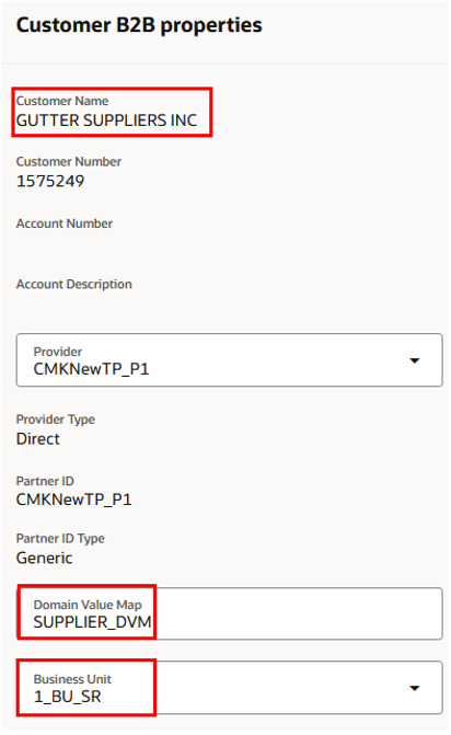

Set Up B2B Partner Properties
You can define B2B properties for the following use cases:
  • Associate the BU for the inbound orders.
  • Associate domain value maps to your customers.
  • When you're using a service provider and you haven’t configured the document property to get partner identification from payload, you'll need to add B2B properties to define partner information.
Here’s how you add B2B properties:
  1. Select B2B Partners from the Task Panel.
  2. Click Add on the Customer B2B Properties tab.
  3. Enter the customer details on the Add customer B2B properties drawer. Note that the customer account is not needed.
  4. Click Save.
Add Customer B2B Properties
