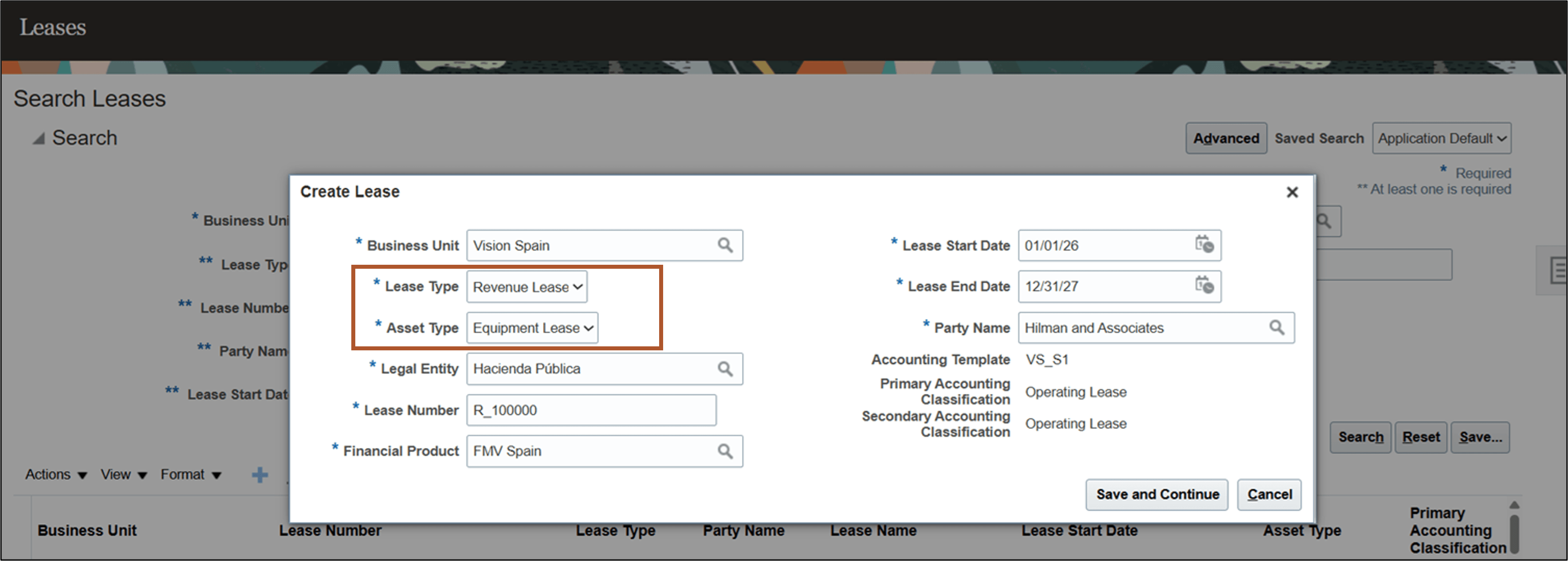

To create a revenue lease for equipment:
  1. Create a revenue lease and select the asset type as Equipment and select a financial product. The financial product defaults the accounting template and the primary and secondary accounting classifications for the lease.

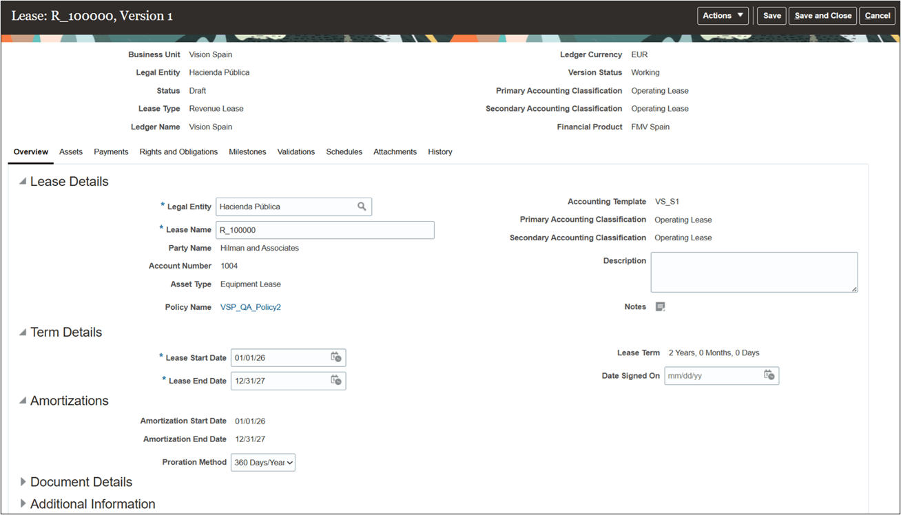

  2. Update lease details such as the lease name, lease term details, party, proration method, and document details.

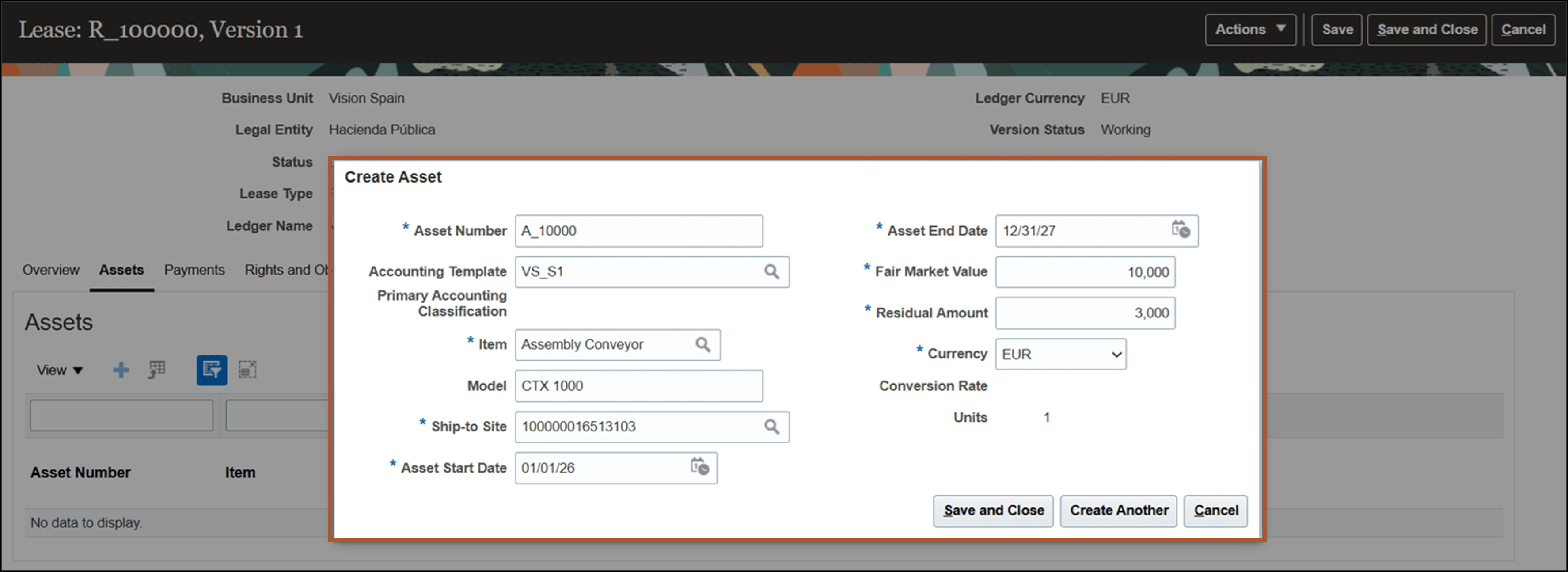

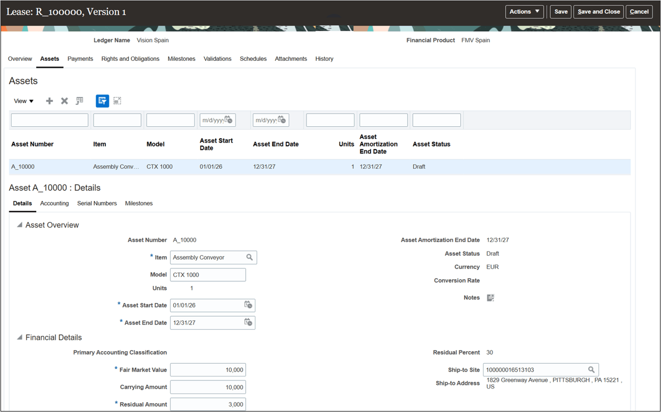

  3. Create an asset and update asset details such as the asset term, item details, fair market value, and residual amount.
  4. The accounting template and distributions defaults from the financial product and may be updated as needed.

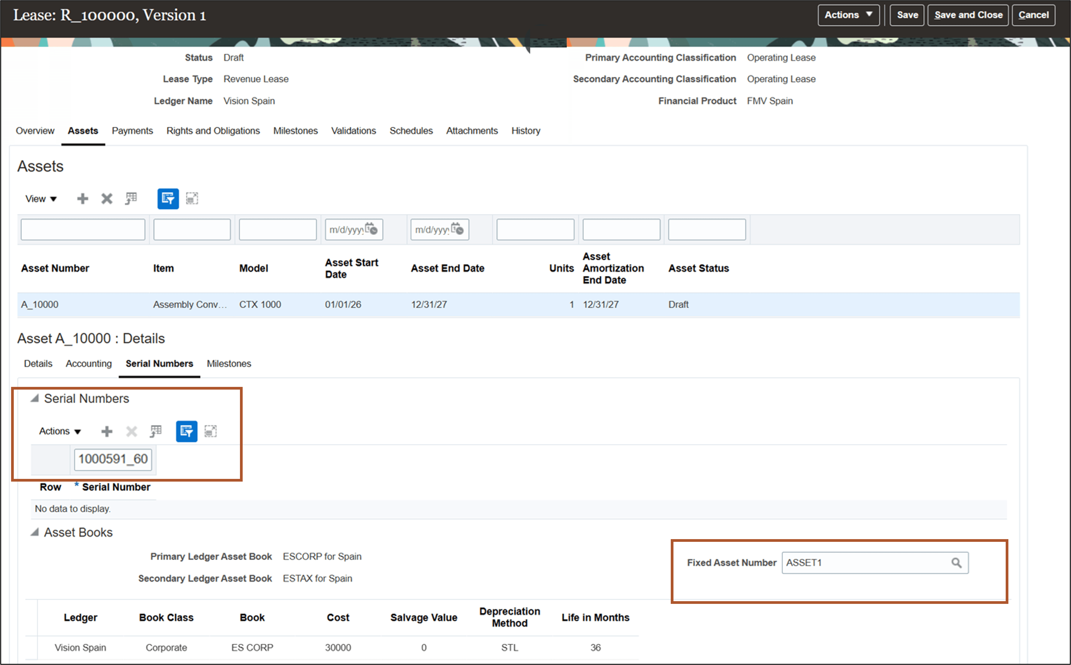

  5. Update the asset serial number and link a fixed asset number from Oracle Assets.

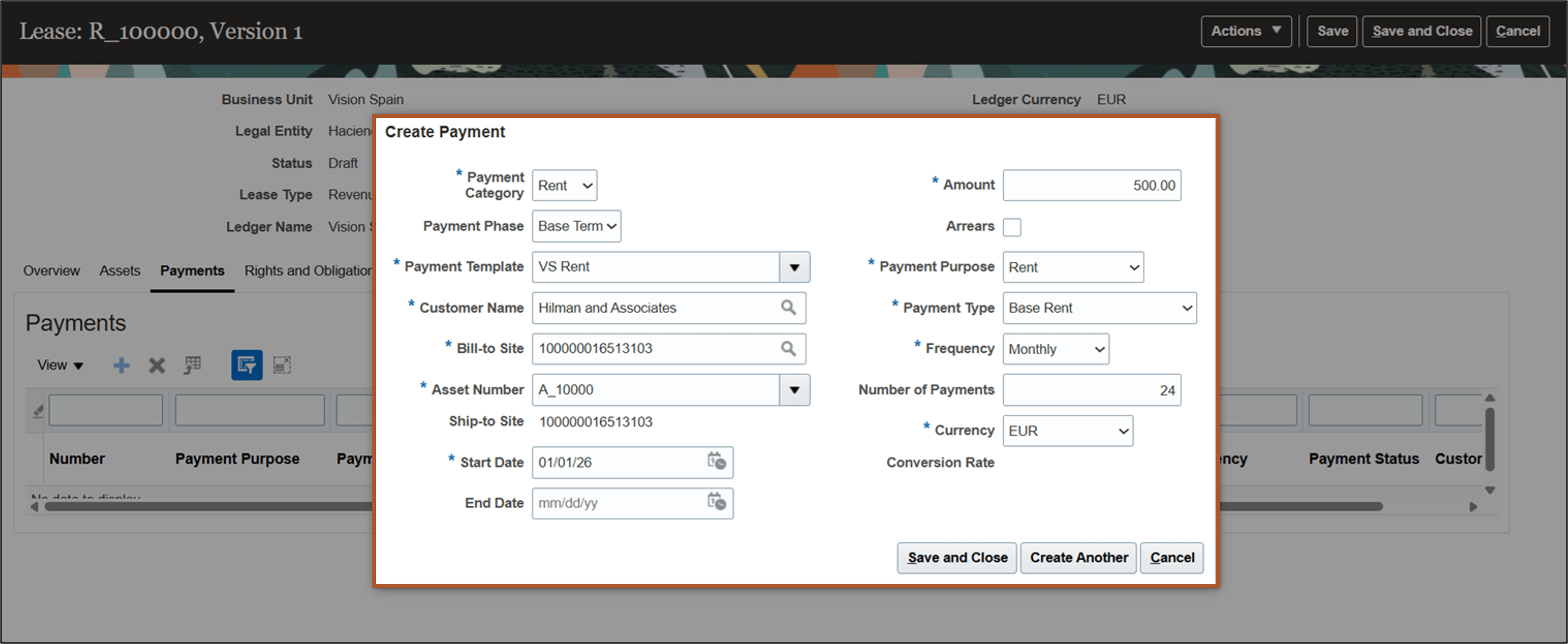

  6. Create rent payments by selecting the payment category as Rent.

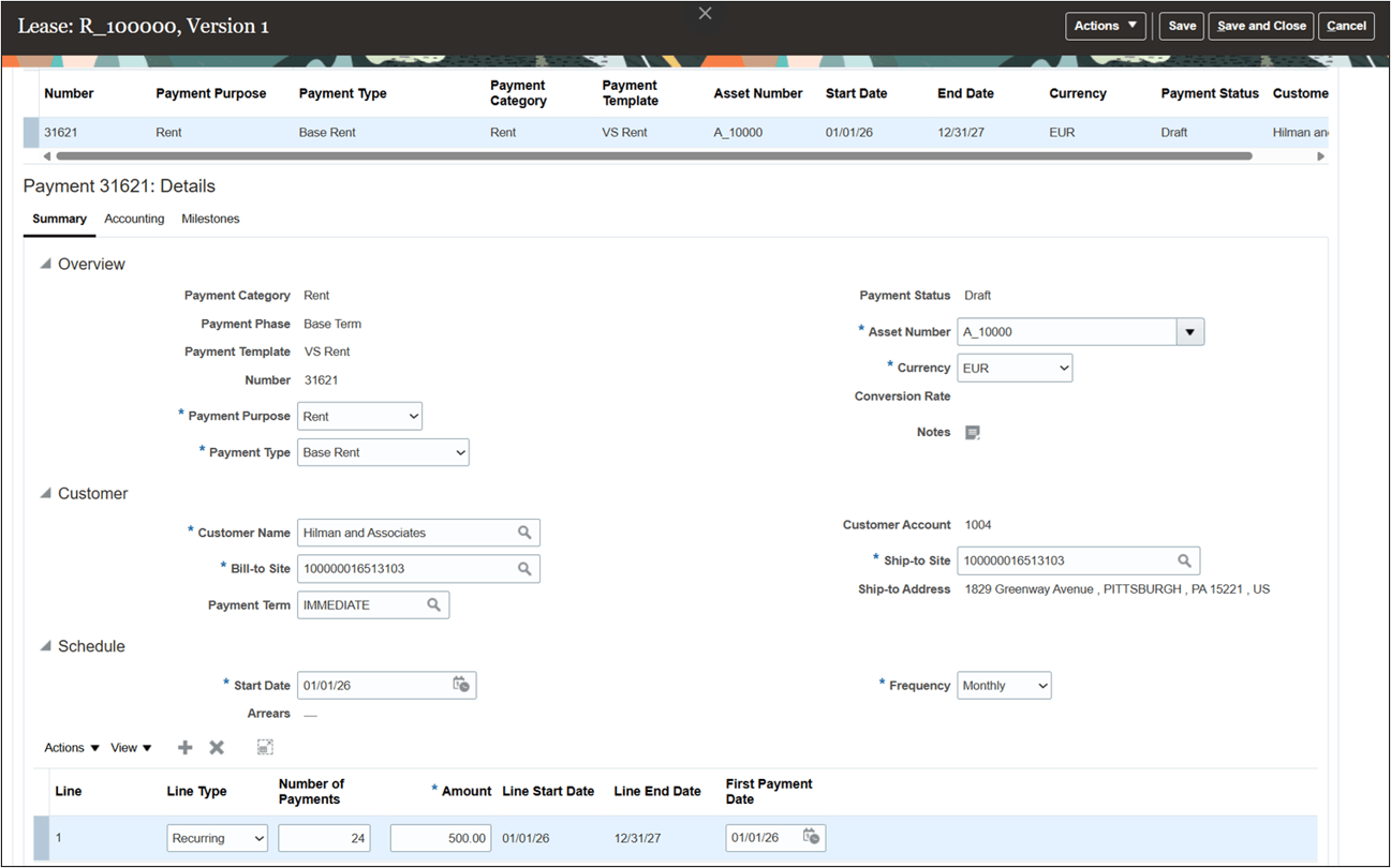

  7. Update payment details such as payment amounts, frequency, number of payments, and transaction tax details. Associate the payment to an asset.

Create Lease page
Create Lease page
Lease Details page
Lease Details page
Create Asset page
Create Asset page
Asset Details page
Asset Details page

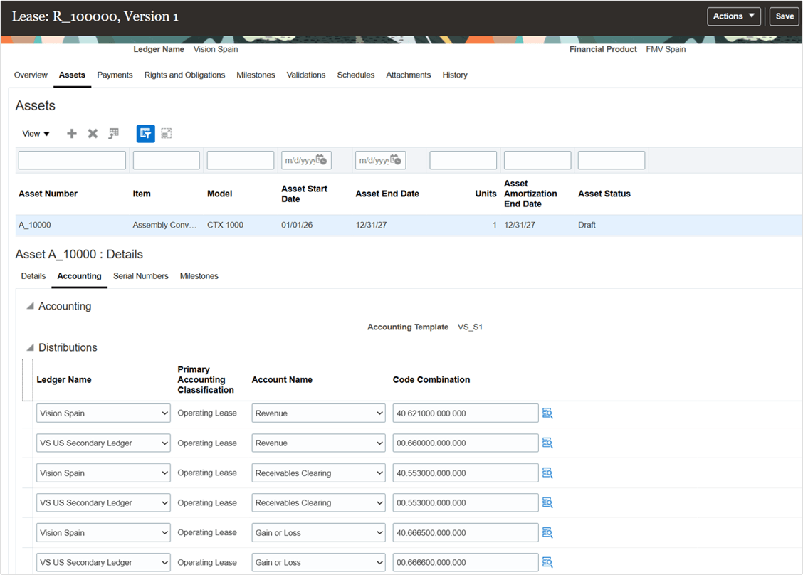

Asset Details Accounting tab
Asset Details Serial Numbers tab

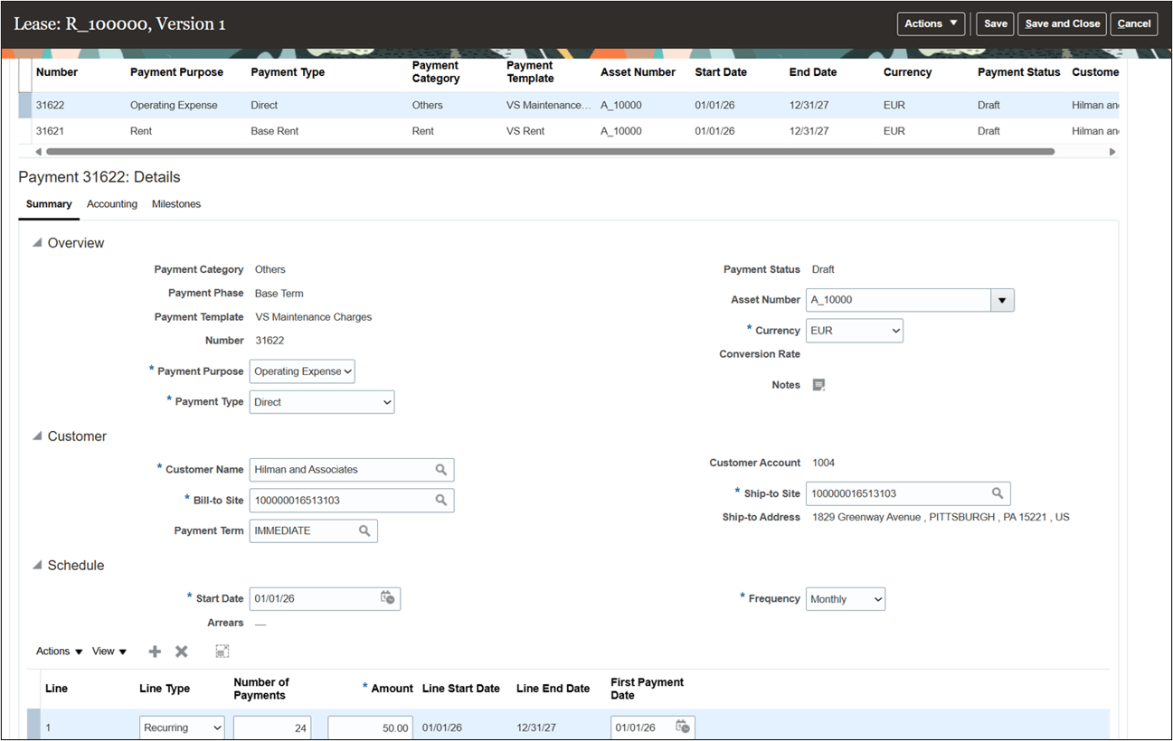

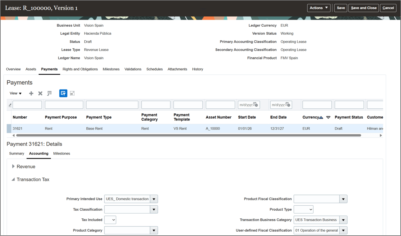

Create Payment page - Rent
Payment Details page - Rent
Payment Details Accounting tab - Rent

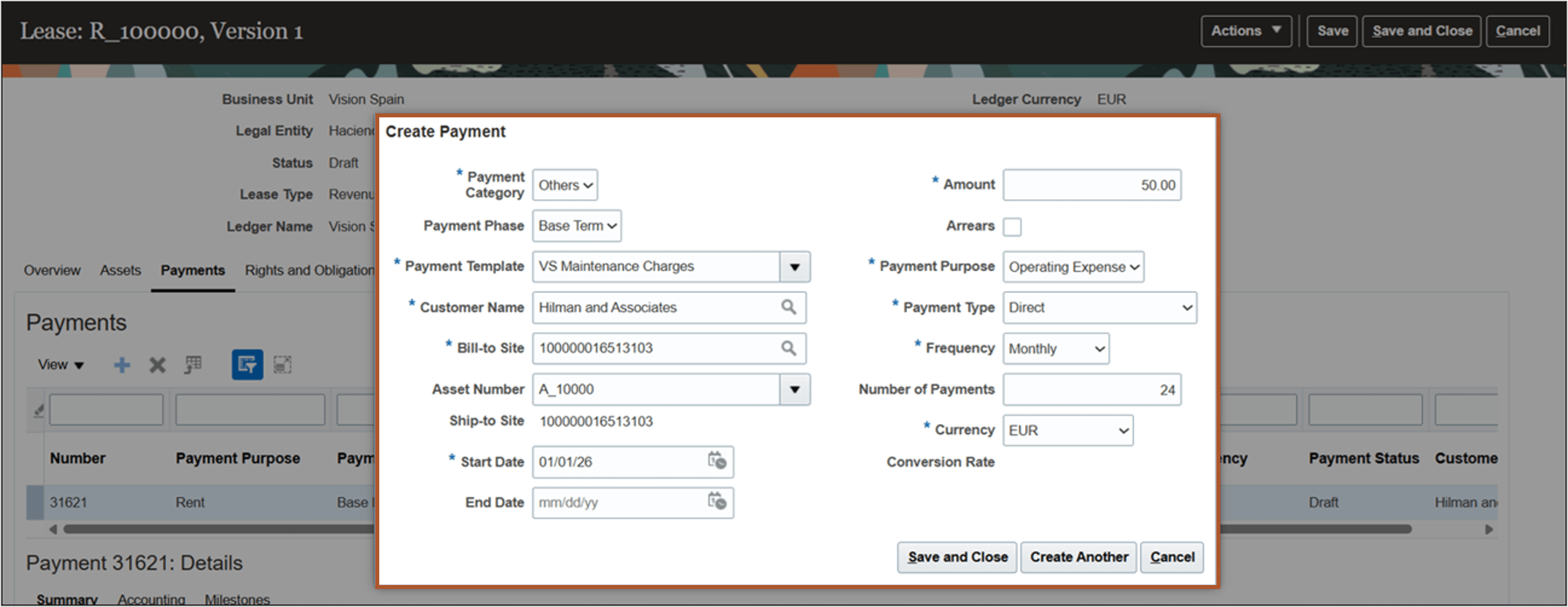

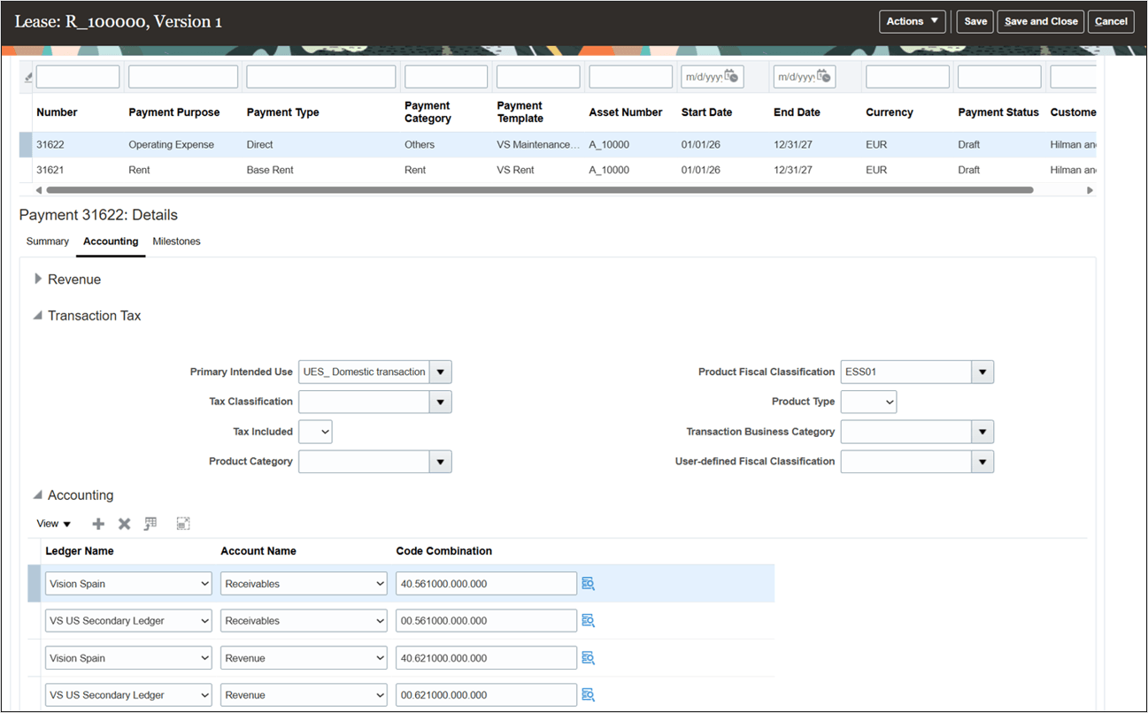

Create Payment page - Others
Payment Details page - Others
Payment Details Accounting tab - Others

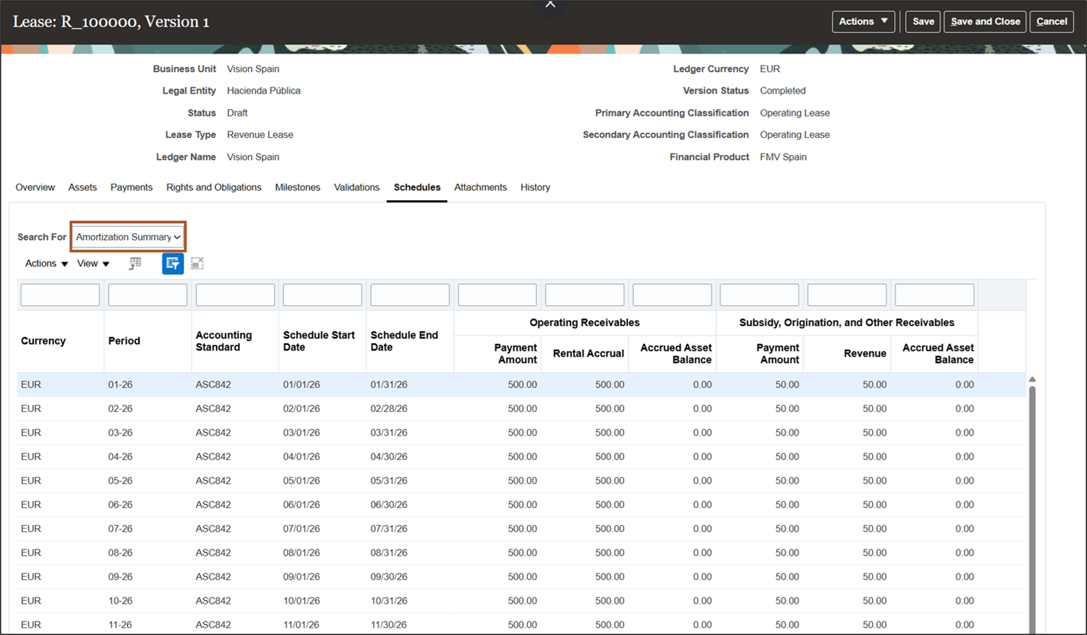

SCHEDULES
Validate the lease and generate schedules. The schedule contains all lease payments and the periodic amortization of revenue from rent and other payments. Use the Schedules tab to view the schedules before lease activation.
Schedules - Amortization Summary

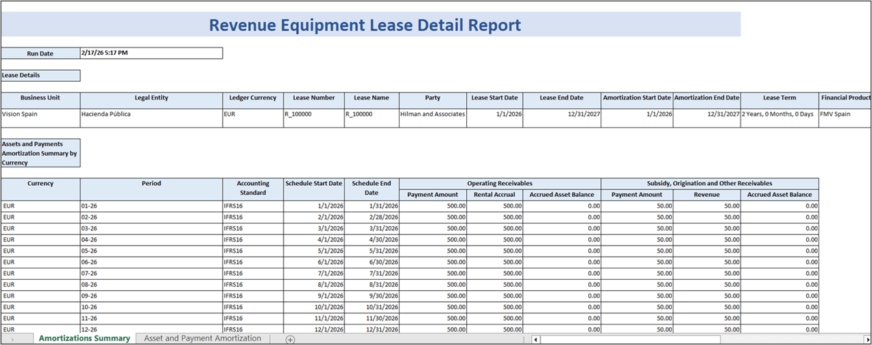

Activate lease contracts to complete the lease creation process. The activation process generates the lease booking transaction and enables the lease for billing and periodic accruals processing. Active contracts are available for viewing in read-only mode. A detailed report of the payment and amortizations down to the asset and payment level is available after contract activation.
Lease Detail Report
Lease Detail Report

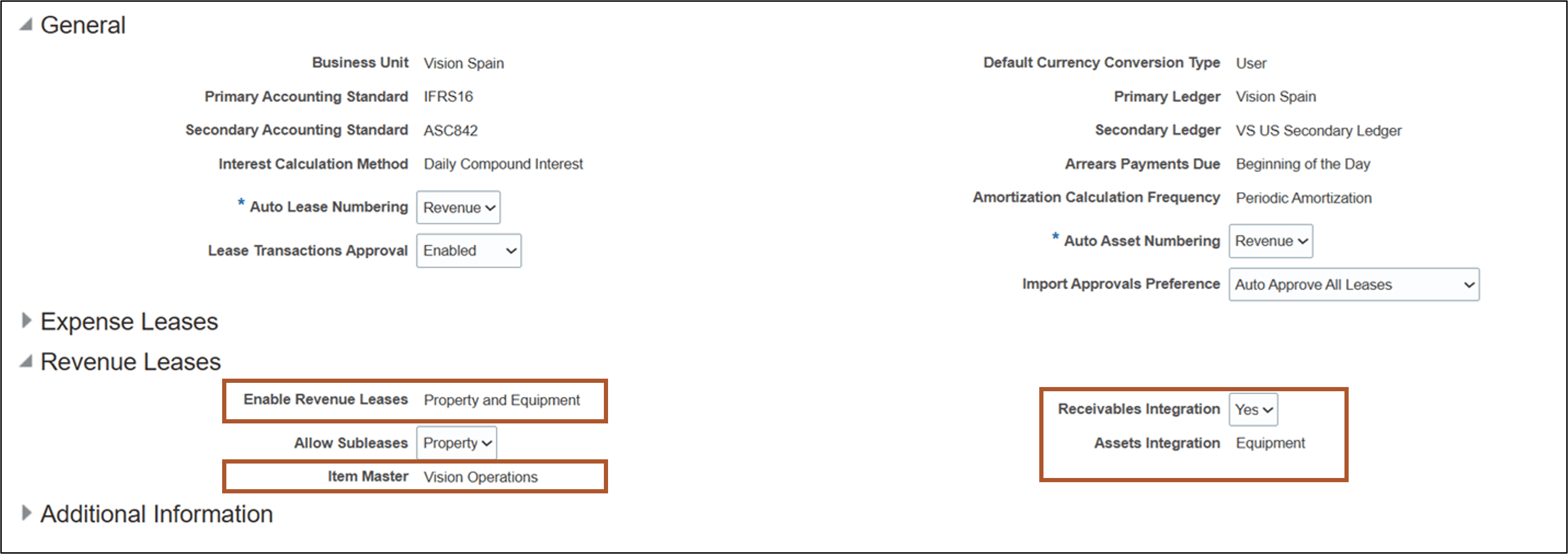

Manage Lease Accounting Configurations:
  • Define System Options for Revenue Leases. Enable revenue leases for equipment. Enable Receivables and Assets integration and select Item Master.
System Options page
System Options page

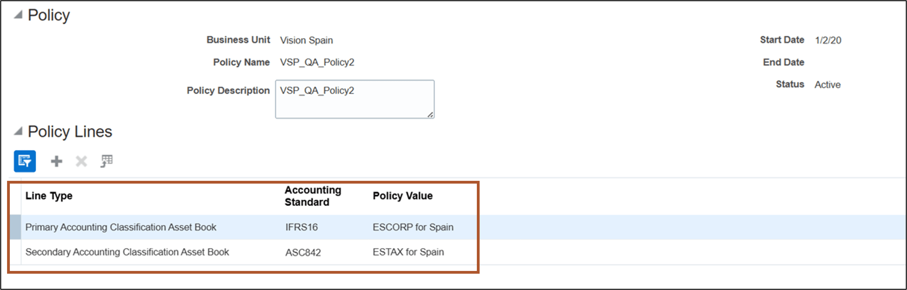

  • Create Policy. Select the Primary Asset Corporate Book and Secondary Asset Tax Book. Update the policy status to Active.
Policies page
Policies page

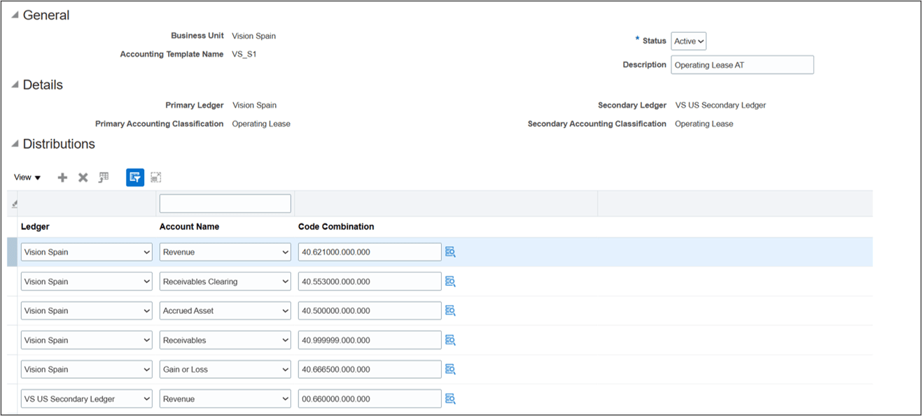

  • Create Accounting Template. Select the primary and secondary accounting classifications and distributions for accounting the rental accrual and payments for the leased asset. Update the accounting template status to active.
Create Accounting Template page

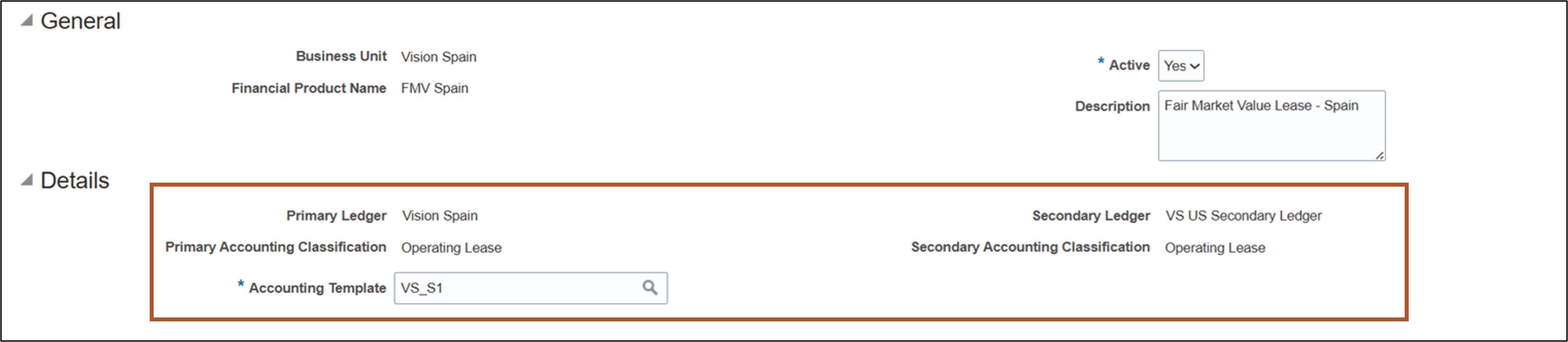

  • Create Financial Products. Select the primary and secondary accounting classifications and associate an accounting template. Activate the financial product.
Create Financial Product page

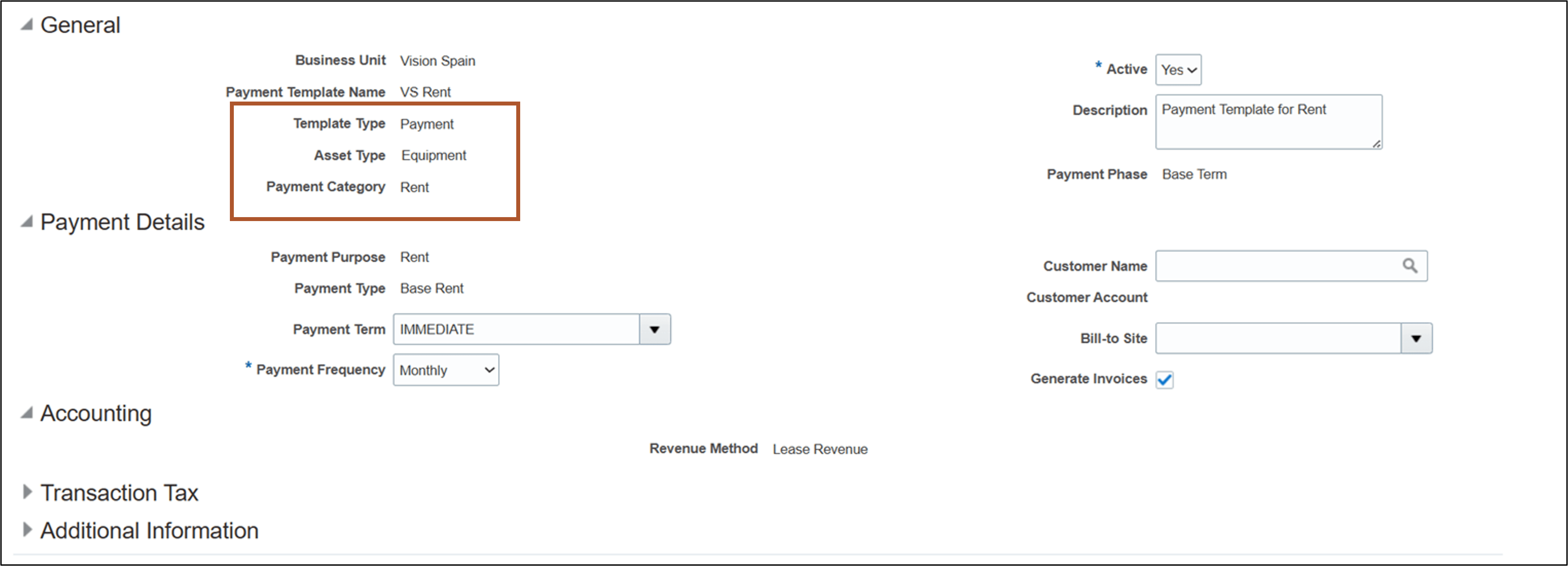

  • Create Revenue Lease Payment Template for rent payments. Select the asset type as Equipment and the payment category as Rent and enter the payment and transaction tax details.
Create Payment Template page - Rent

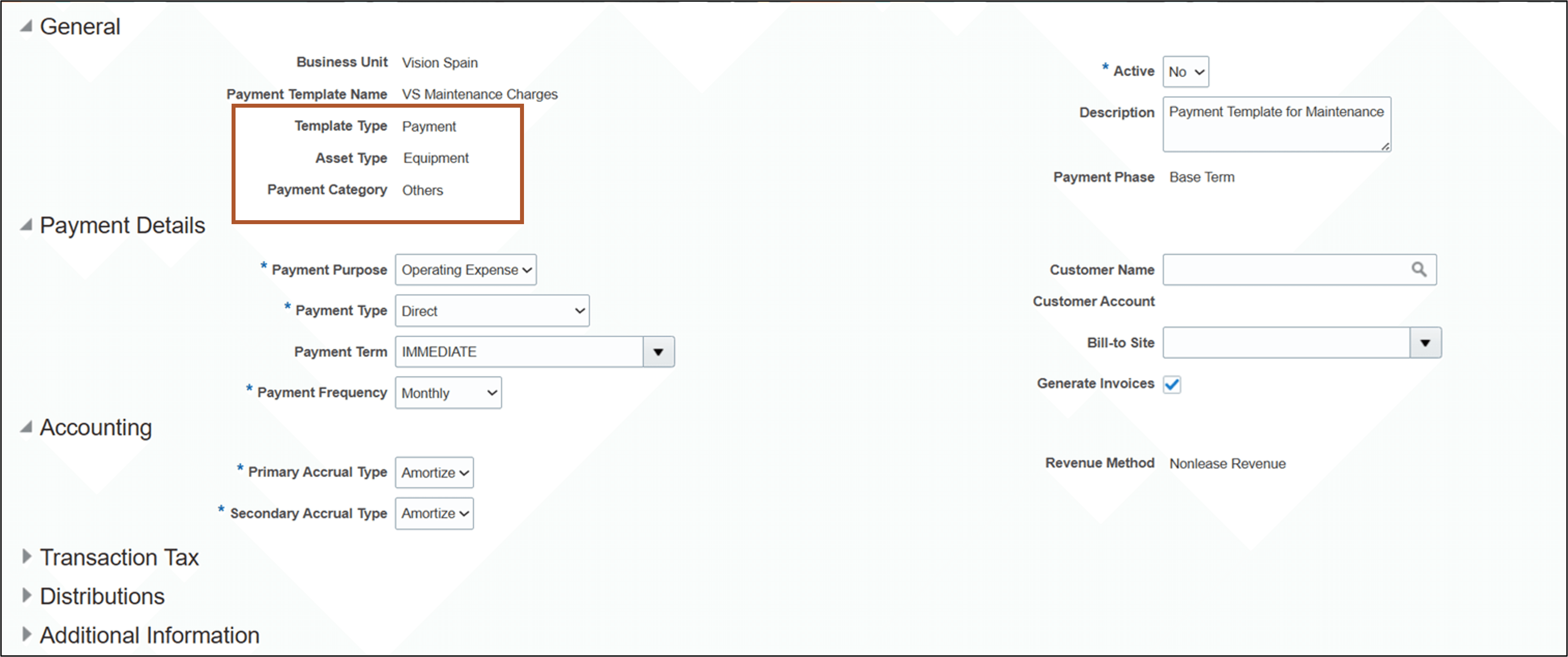

  • Create Revenue Lease Payment Templates for sundry charges. Select the Asset Type as Equipment, Payment Category as Others and enter payment and transaction tax details.
  • Select the accrual type from the following:
    • Amortize - Generate recurring income amortization over the payment term.
    • None - Do not generate income amortization.
Create Payment Template page - Others
