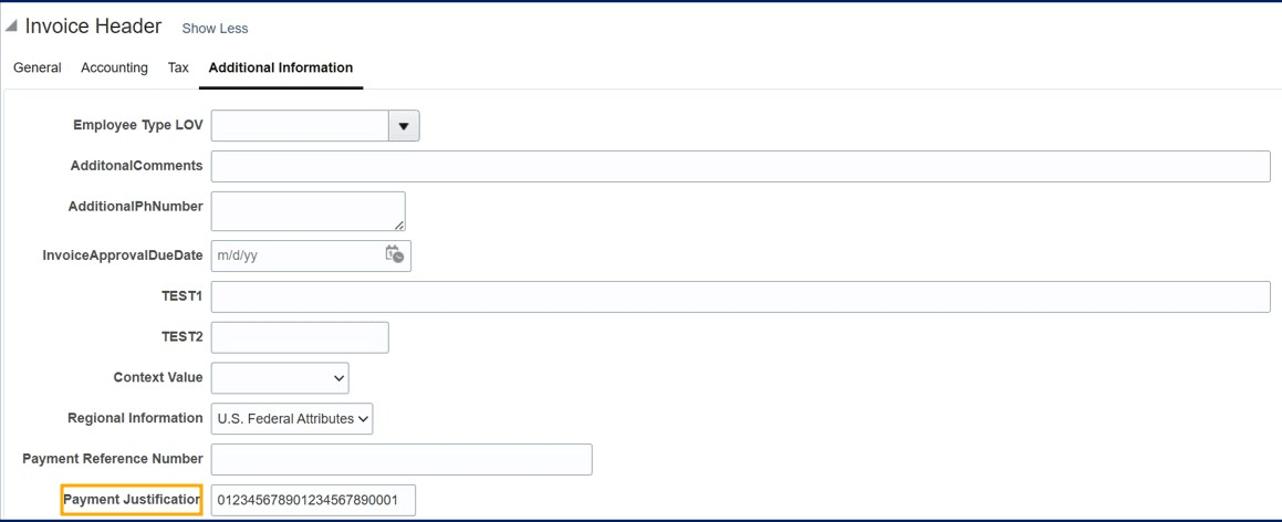

Include the payment justification and program record in Payment Automation Manager, or PAM, payment files to comply with updated U.S. Department of the Treasury requirements. The Payment Justification field is a global descriptive flexfield on the invoice header and enables entry of an Award ID Number or a description of the payment purpose. The program record, created during payment file creation, is populated with the Procurement Instrument Identifier, or PIID, and the Federal Award Identification Number, or FAIN, sourced from the referenced purchase order.

Payment Justification on Invoice Header
The business benefit is that it provides improved transparency, auditability, and regulatory compliance by capturing detailed payment classification and federal award tracking in PAM Type B payment files in accordance with Treasury standards.
