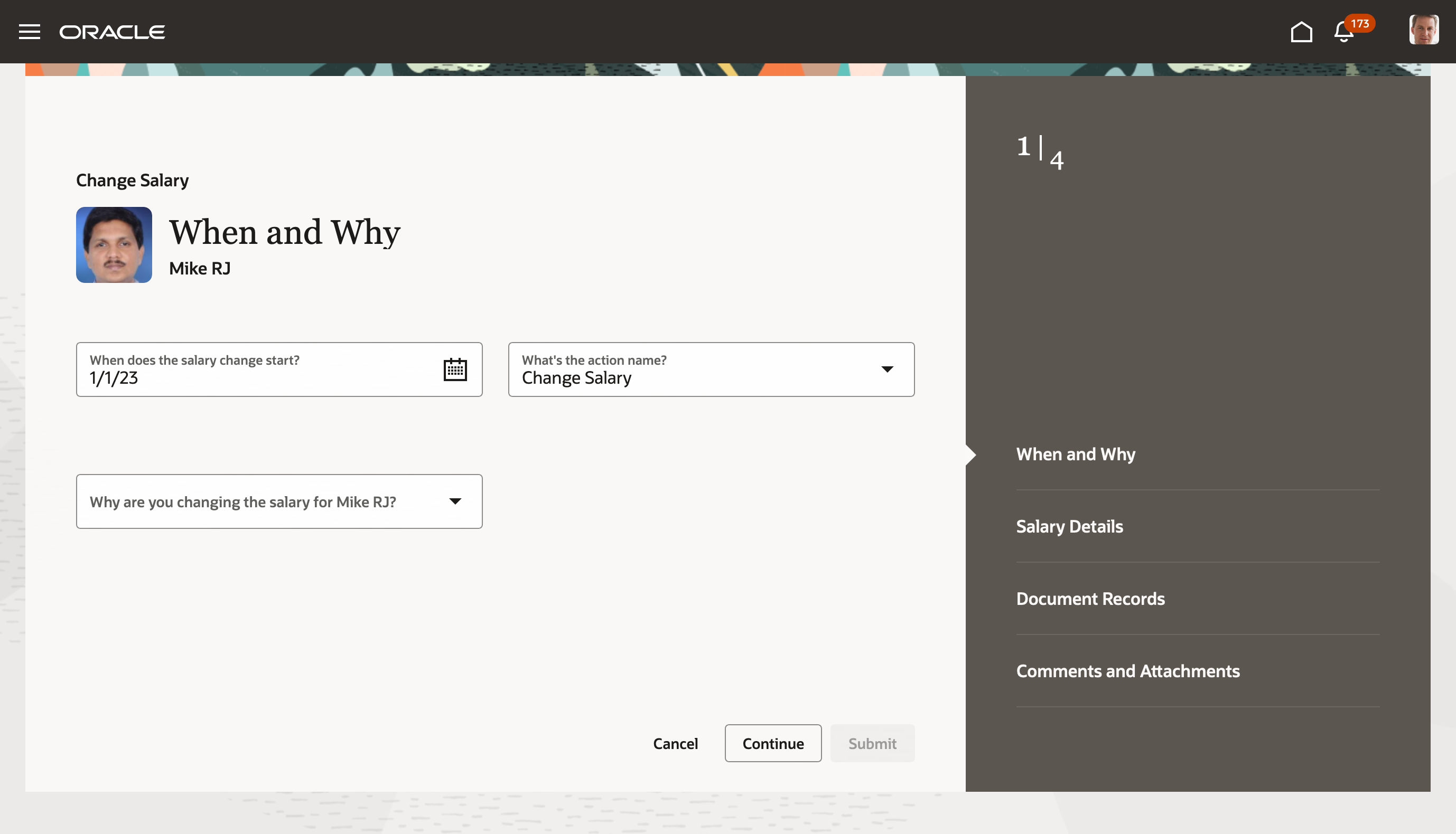

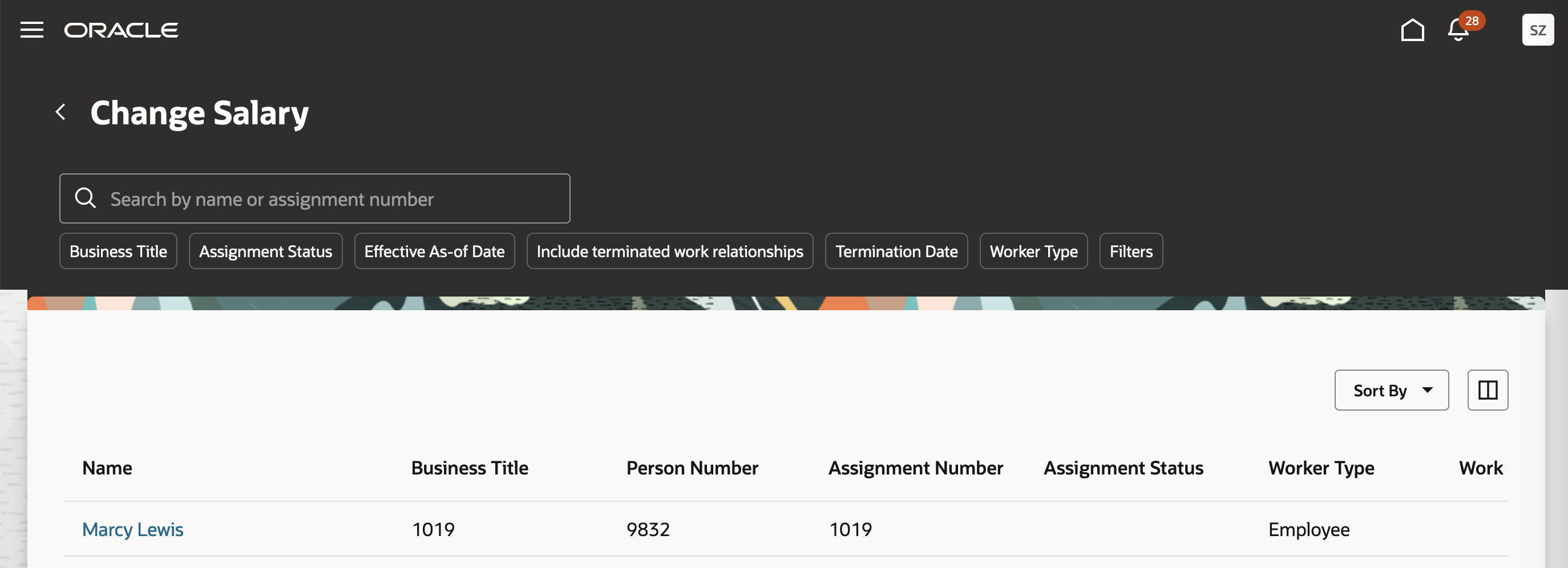

You can now let HR specialists and compensation managers use the Change Salary page re-created with the Redwood toolkit, when you enable the Redwood experience. Earlier only line managers could use this Redwood page.
Redwood Change Salary Page for HR Specialists
Salary Details Page in the Redwood Change Salary Guided Process
