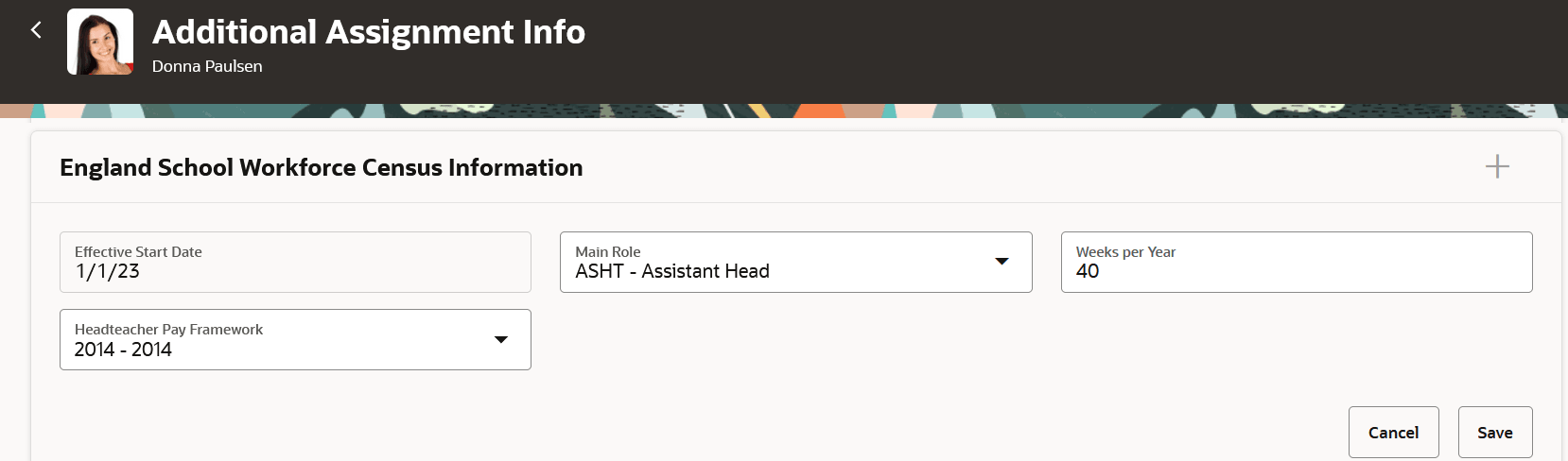

You can now manage and view additional assignment information (assignment extensible flexfield) for a worker.
  • HR specialists can manage the additional assignment information of people in their person security profile.
  • HR analysts can only view the additional assignment information of people in their person security profile.
  • Line managers can only view the additional assignment information of their direct reports.
Assignment extensible flexfields
The new page offers a fewer number of clicks and better performance. You can take advantage of the cohesiveness through the application with the new page.
