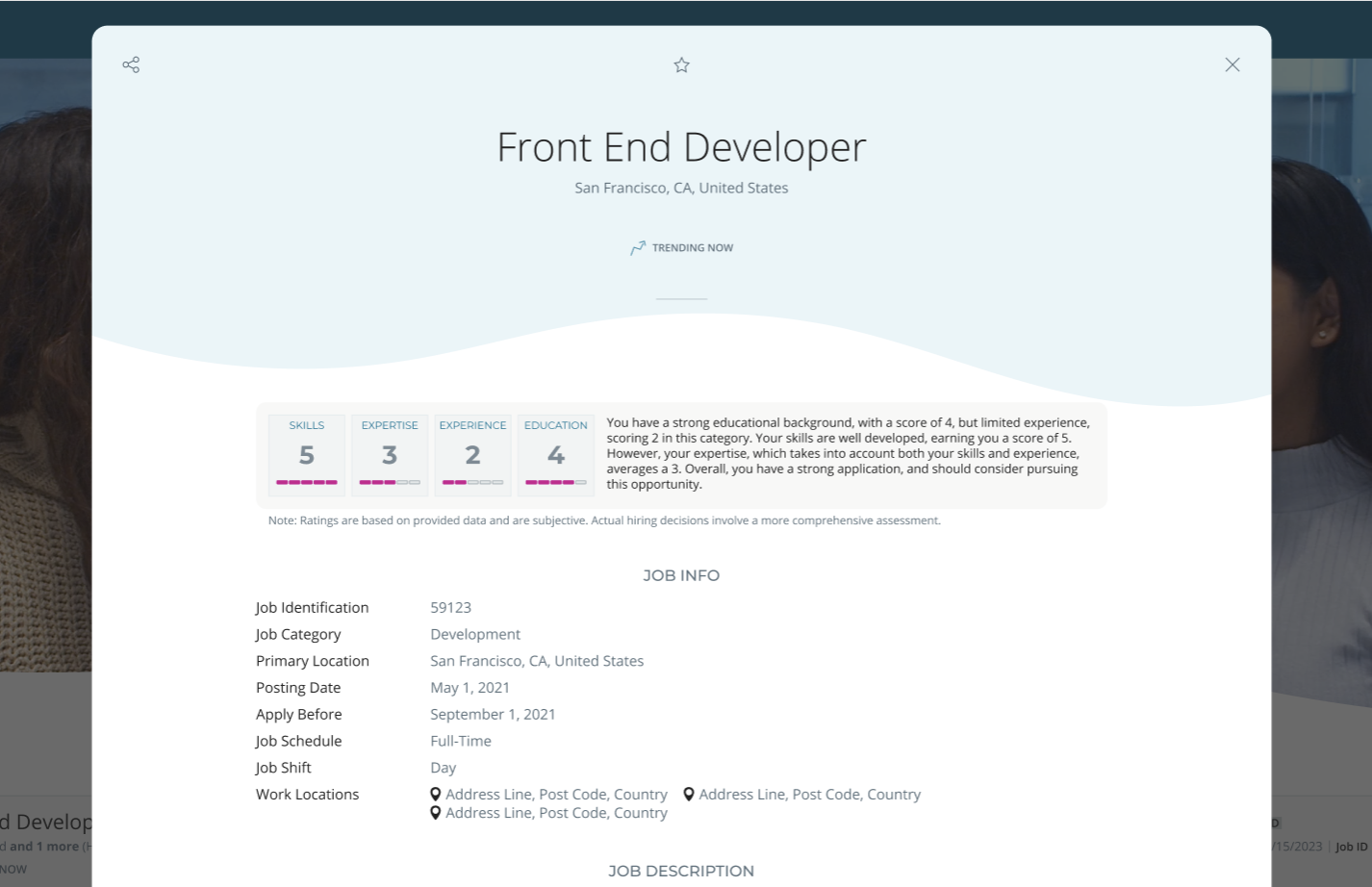

Add the new Job Fit metrics bar element at the top of a page.
This element uses Generative Adaptive Intelligence (AI) to compare information from a candidate's profile or uploaded resume with the job information on the job details page. A candidate's suitability for a job is rated using a 0-5 scaled for skills, job history, education, and other data match the skills, requirements, and job information from the job details page. This element also provides a summary of why they received the displayed scores.
This screen capture shows the metrics on a job details page.
