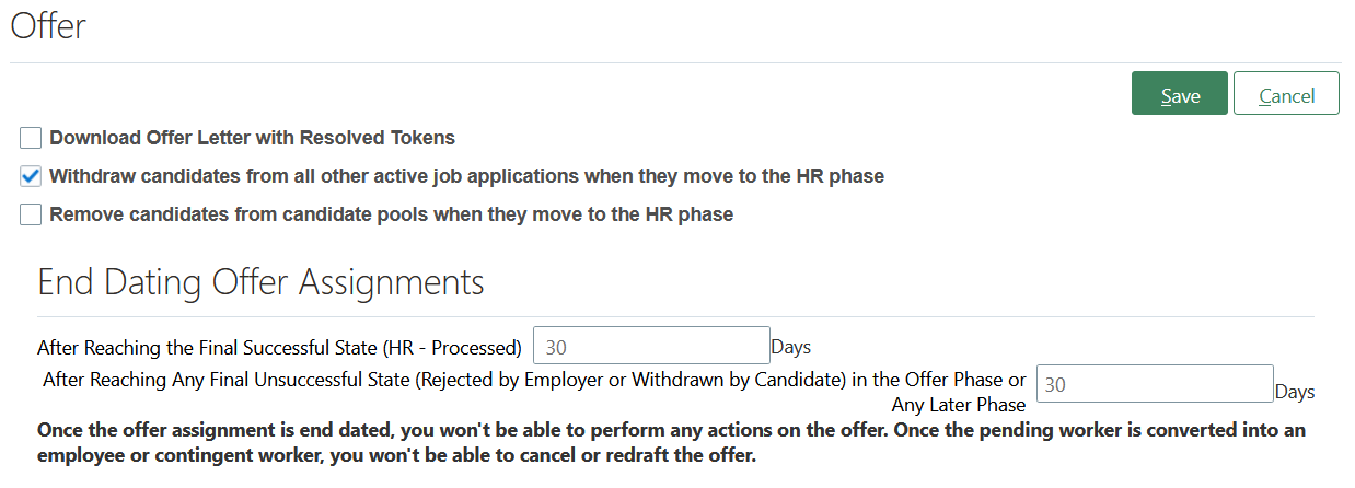

The Prevent Redrafting Offers section in the Enterprise Recruiting and Candidate Experience Information task page was renamed End Dating Offer Assignments. The default value of the existing two options have been modified. It's now 30 days (instead of 90 days) for the option After Reaching the Final Successful State, and 30 days (instead of 90 days) for the option After Reaching Any Final Unsuccessful State. A note was also added to provide more details about the impact of end dating a job offer.

New Offer Section Called End Dating Offer Assignments
  1. In the Setup and Maintenance work area, go to:
  • Offering: Recruiting and Candidate Experience
  • Functional Area: Recruiting and Candidate Experience Management
  • Task: Enterprise Recruiting and Candidate Experience Information
  1. Expand the Offer section and click Edit.
  2. In the End Dating Offer Assignments section, two options are available:
  • After Reaching the Final Successful State (HR - Processed) - Default value is now 30 days.
  • After Reaching Any Final Unsuccessful State (Rejected by Employer or Withdrawn by Candidate) in the Offer Phase or Any Later Phase - Default is now 30 days.
  1. Click Save.
The availability of the Cancel Offer and Redraft Offer actions are dependent on the values (days) you set for the above settings. There’s no dependency on the profile option ORA_IRC_OFFER_CANCEL_REDRAFT_ENABLED for the above setting.
