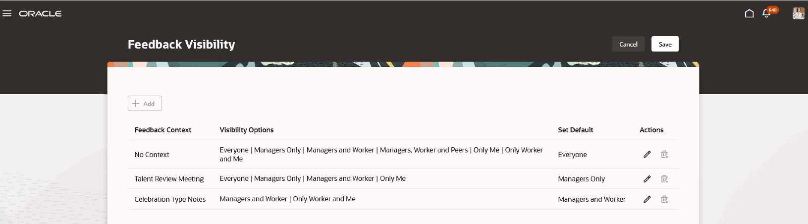

Screen capture of the Feedback Visibility Configuration Page
Steps to enable and configure
To enable Redwood Feedback Visibility, you need to enable the profile options indicated in the table.
Profile Option Code
Profile Option Display Name
Value
ORA_HCM_VBCS_PWA_ENABLED
Enable VBCS Progressive Web Application User Interface
Y
ORA_HRT_ANYTIME_FEEDBACK_REDWOOD_ENABLED
Enable Redwood Anytime Feedback Pages
Y
