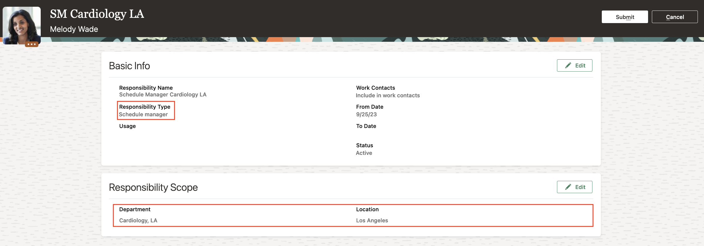

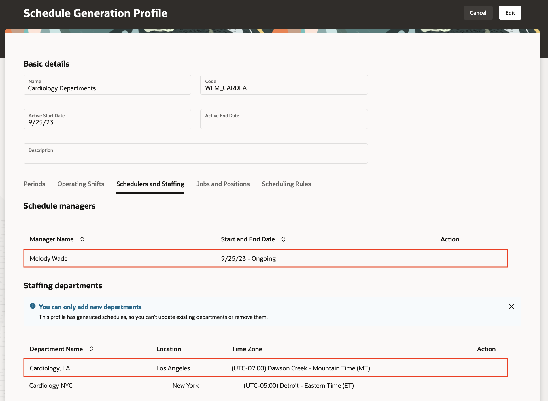

The workforce schedules that schedulers can access depends on the staffing departments for their schedule generation profiles and their area of responsibility. The responsibility type needs to be Schedule Manager and their responsibility scope needs to include the departments and locations that correspond to the staffing departments in their schedule generation profiles. For example, a scheduler's profile and responsibility scope both have the Cardiology department for LA and New York, but not Chicago. Thus they can't manage the Cardiology, Chicago schedule.
Schedule Generation Profile Showing the Schedule Manager and Staffing Departments
Area of Responsibility for the Schedule Manager Showing the Responsibility Type and Scope
