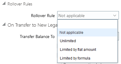

You can define the rollover rules by selecting the Rollover positive balance check box under the Balance Disposition Rules section. That check box enables the Rollover Rules section.
Screen capture of the Rollover Rules options
You can configure the rollover rules to either allow unlimited balance or limit the balance amount using a flat amount or a formula.
