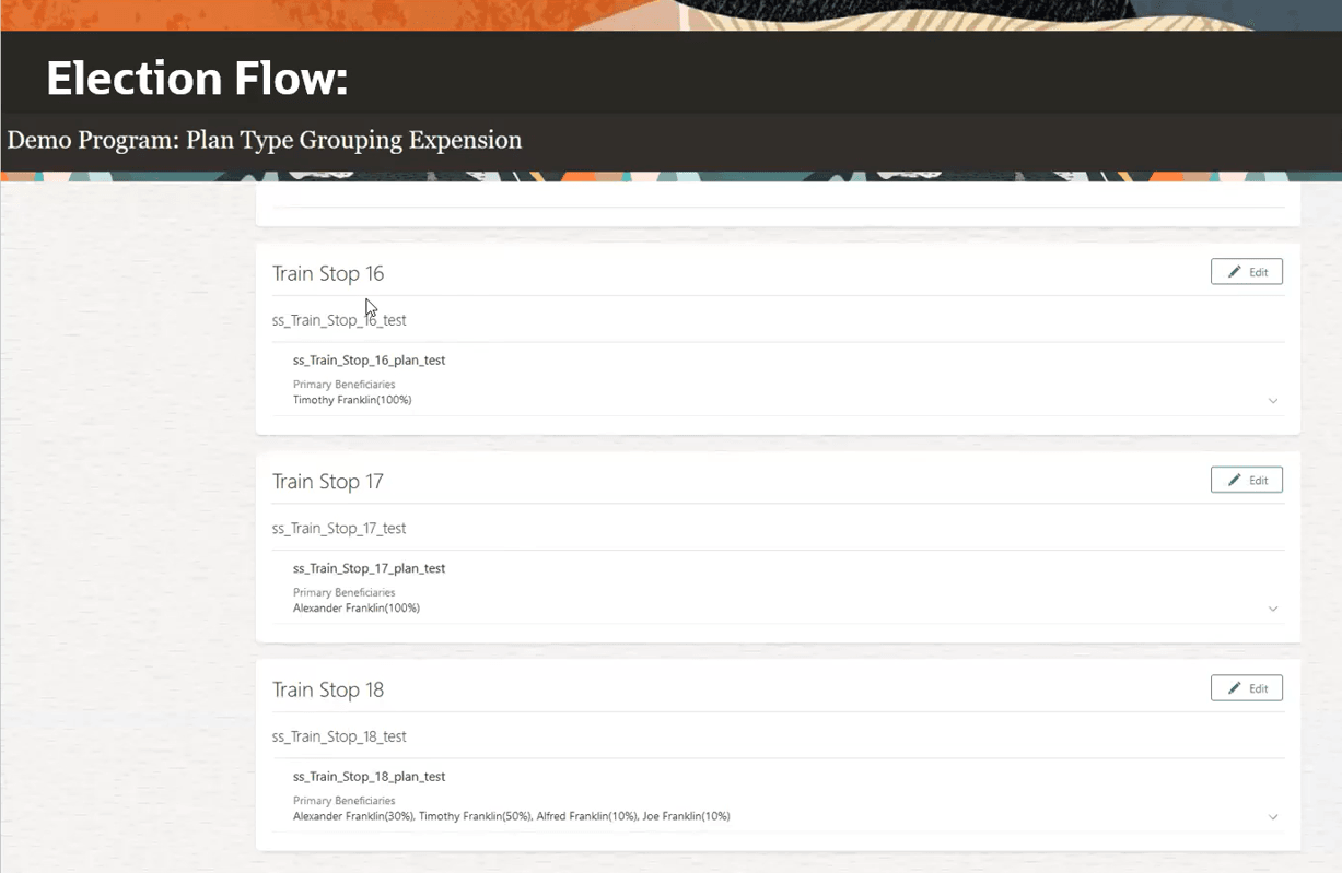

You can now use 6 new plan type groupings along with the existing 12 to group benefit plans and plan types. Plan type grouping enables you to group different plans for displaying them in the self-service enrollment flow. This grouping lets you have different text, display, and rate column information for each country.
This enhancement reflects in the following areas in Benefits:

All the plan type groupings are enabled by default in the Configure Plan Type Grouping Display page. The functionality of the Display and Rate Column Display fields remains the same. If you want to change the plan dependency enabled on a plan type grouping, delete the plan dependency before updating the self-service grouping.
To use this enhancement, navigate to Benefits Administration > Plan Configuration > Configure Plan Type Groupings Display.
Screen capture of the Configure Plan Type Groupings Display page.
