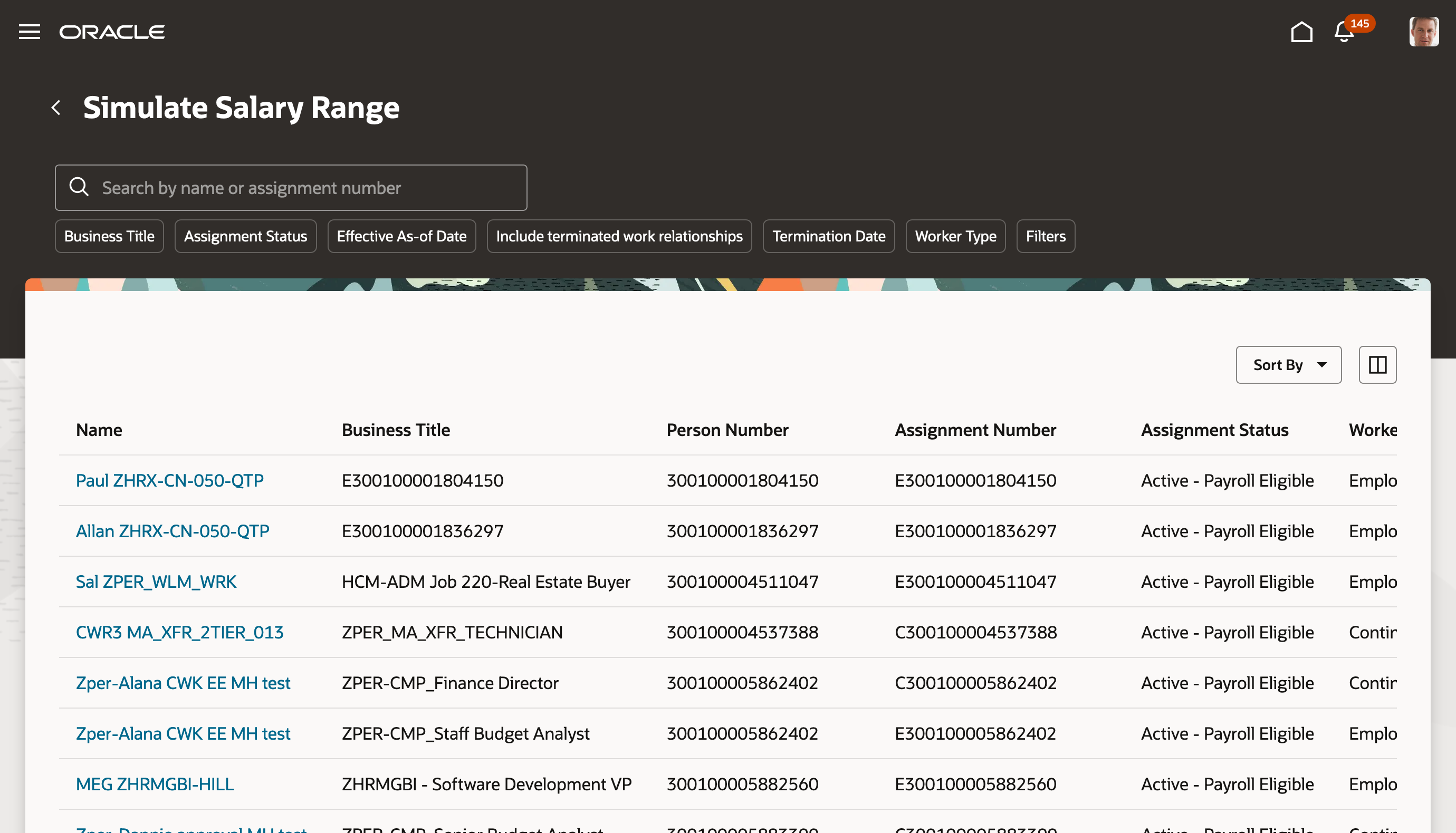

You can now let HR specialists and compensation managers use the Simulate Salary Range page re-created with the Redwood tool set Visual Builder Studio when you enable them along with the Redwood experience.
Simulate Salary Range Page with Search Results

When searching for person assignments, the results could display assignments that you don’t have data security permissions to simulate salary ranges. But when you choose such a person assignment, you're prevented from launching the page and viewing the details. This behavior improves elastic search performance for this page.
