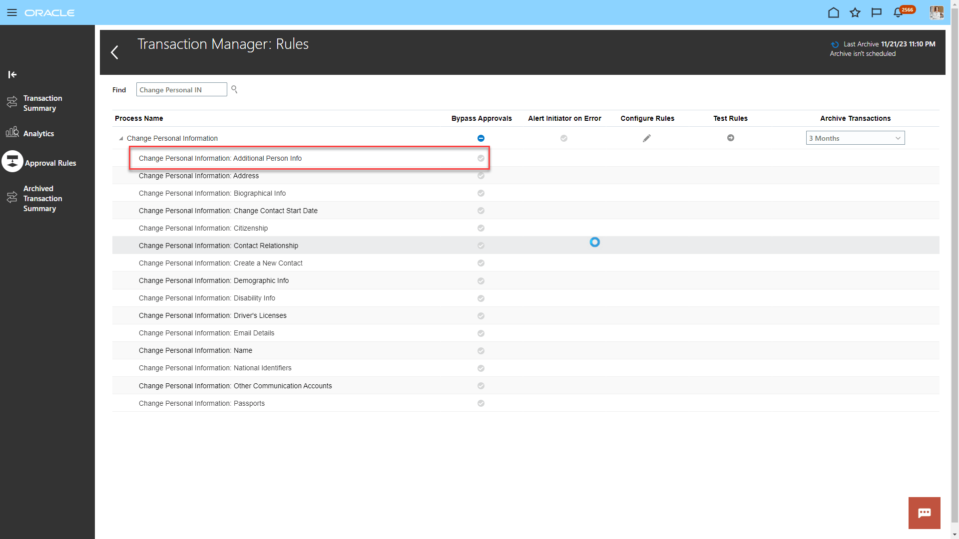

The Change Personal Information approval rule has been enhanced to include a new subcategory for Additional Person Info specific to the Redwood Additional Person Info page. This subcategory will be delivered as set to Bypass ready-to-use, even if the Change Person Information rule isn't set to Bypass. This will allow you to configure this feature based on your approval requirements. The approval rule includes both current and proposed values of each flexfield segment that can be used for evaluation in the approval rule. If you want to apply an approval rule, you will need to configure the Change Person Information approval according to your requirement.
Change Personal Information: Additional Person Info Approval Rule
This enhancement gives you more control over whether to have an approval rule for changes made to the data on the Redwood Additional Person Info page.

NOTE: You must also configure the Change Personal Information approval rule based on your requirement. For more information about configuring approval rules, see the links in the Key Resources section.
