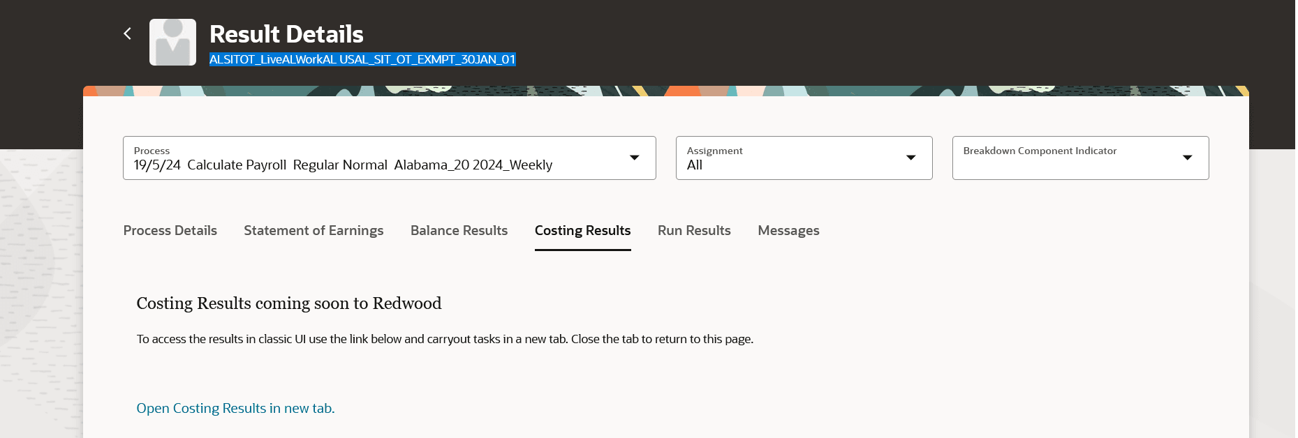

You can navigate to the Results Details page and navigate to each of the result pages for a person, even if some of the results pages haven’t yet been redesigned to the Redwood standards.
For example, the Redwood redesign of the Costing Results and the Messages pages is planned for a later release, however you can access these pages using the same navigation as the redesigned Redwood results pages, such as the Statement of Earnings, Balance Results or Run Result pages.
When you click on either the Costing Results or the Messages tab, the page displays a message and a link to the page.
Results Details pages
Use the link to access the page in a new tab. Close the tab to return to the Results Details page.
Access all of the results pages for a person by using the respective tabs on the Results Details page. You can access the pages irrespective of the pages being redesigned to the Redwood standards.
