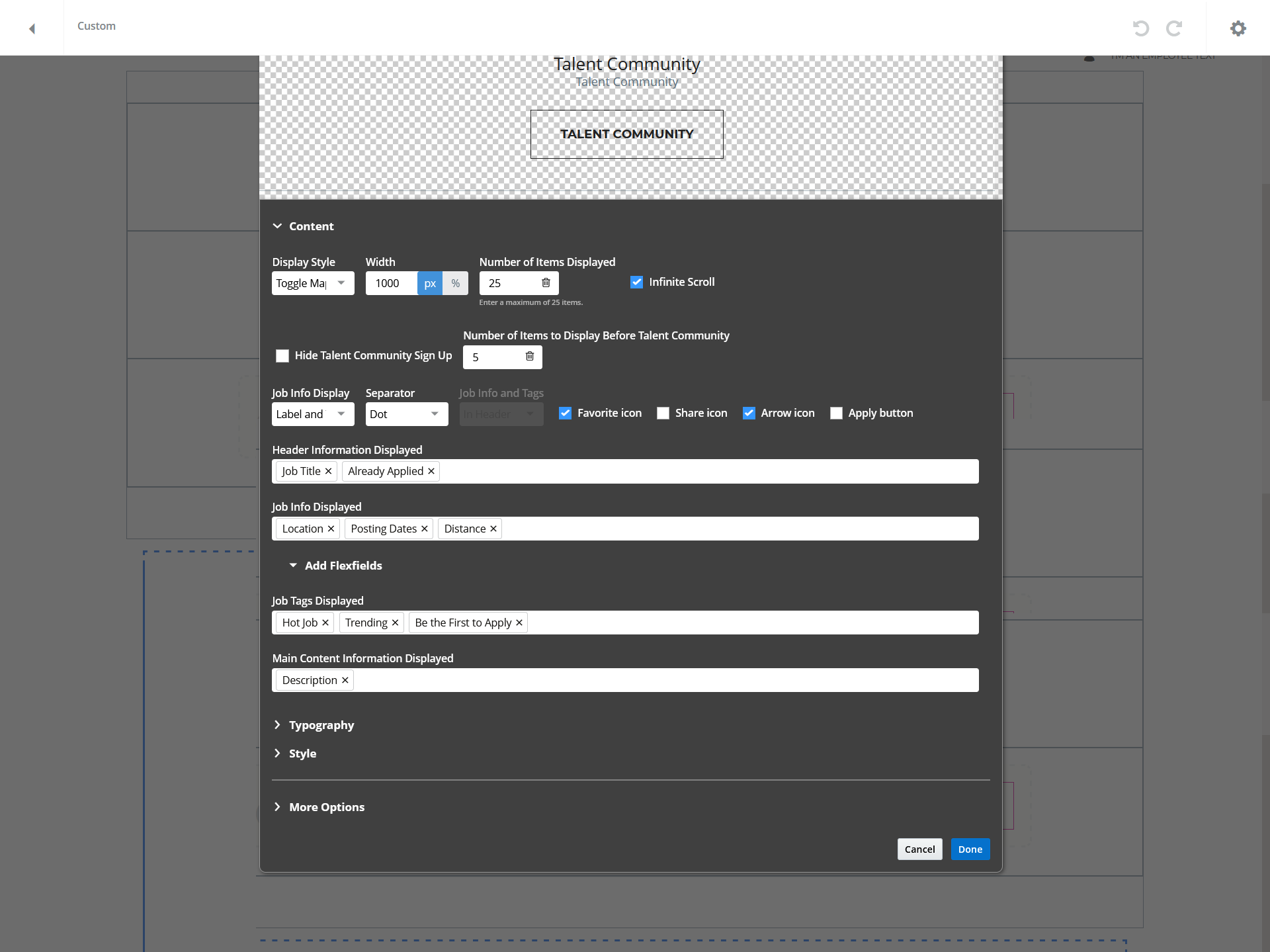

  4. Select the job list element to open it in edit mode.
Custom Search Page Has Been Updated

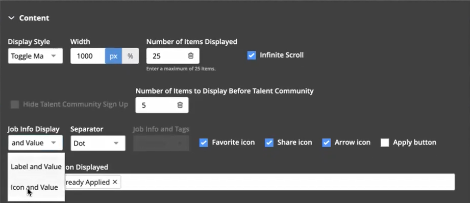

You'll notice that the configuration page layout has changed to have four new sections:
  • Header Information Displayed
  • Job Info Displayed
  • Job Tags Displayed
  • Main Content Information Displayed
  1. Click in each section to display a list of items that you can display in each section. These fields are predefined for each section and you select the ones you want.
Job Info Displayed contains new fields. Fields are added to the career site in the order in which you select them here.

This section also contains options to display the following:
  • Favorite icon
  • Share icon
  • Arrow icon
  • Apply button
You also have the option for changing the labels for icons for certain values.

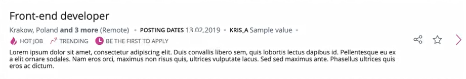

Label and Value
Label and Value

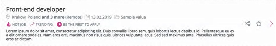

You can still display labels and values below the job title in this section, but now you've got the option to select Icon and Value.
New Display Option
New Display Option
Once selected the labels are displayed as icons.
Display Icon and Value
