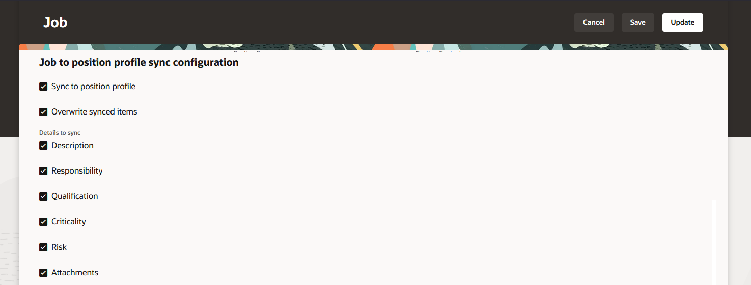

The screenshot below displays few options that are available in the Job to position profile sync configuration section under My Client Groups ->Profiles ->Profile Types ->Job. The sync is initiated only if Sync to position profile is selected.
Screen capture of the configuration section with 'Sync to position profile' selected

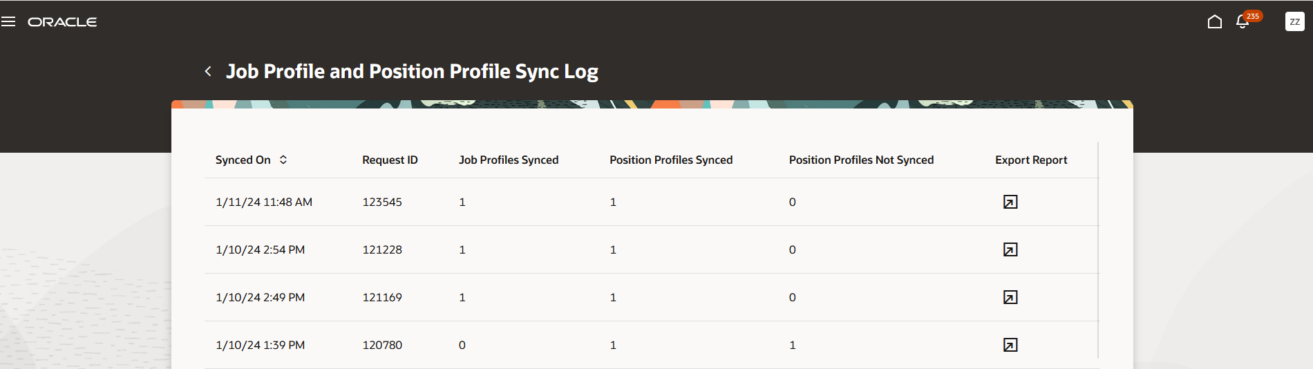

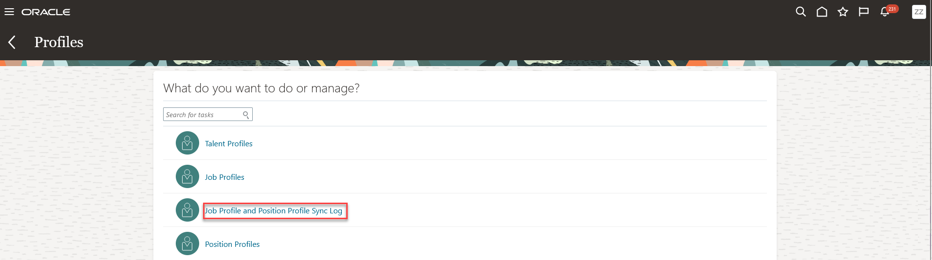

You can also access logs to review the results of completed sync runs. These logs present warnings and errors as well as actions you may need to take to ensure consistency of data being synced. The screenshot below displays the steps to view the log or report.
Screen capture of the Profiles page to view the sync log
Screen capture of the Job Profile and Position Profile Sync Log page

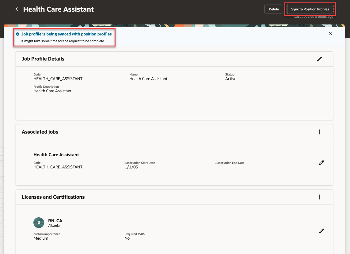

The screenshot below shows the location of the Sync to Position Profiles button in a job profile and the message that gets displayed after the sync is initiated.
Screen capture of a job profile with 'Sync to Position Profiles' button and information message
Job Profile

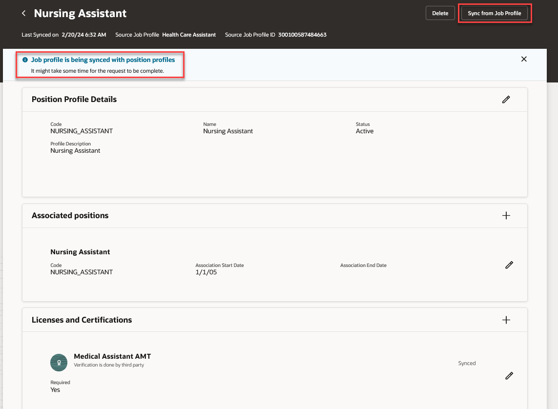

The screenshot below shows location of the Sync from Job Profile button in a position profile and the message that gets displayed after the sync is initiated.
Screen capture of a position profile with 'Sync to Job Profiles' button and information message
Position Profile
