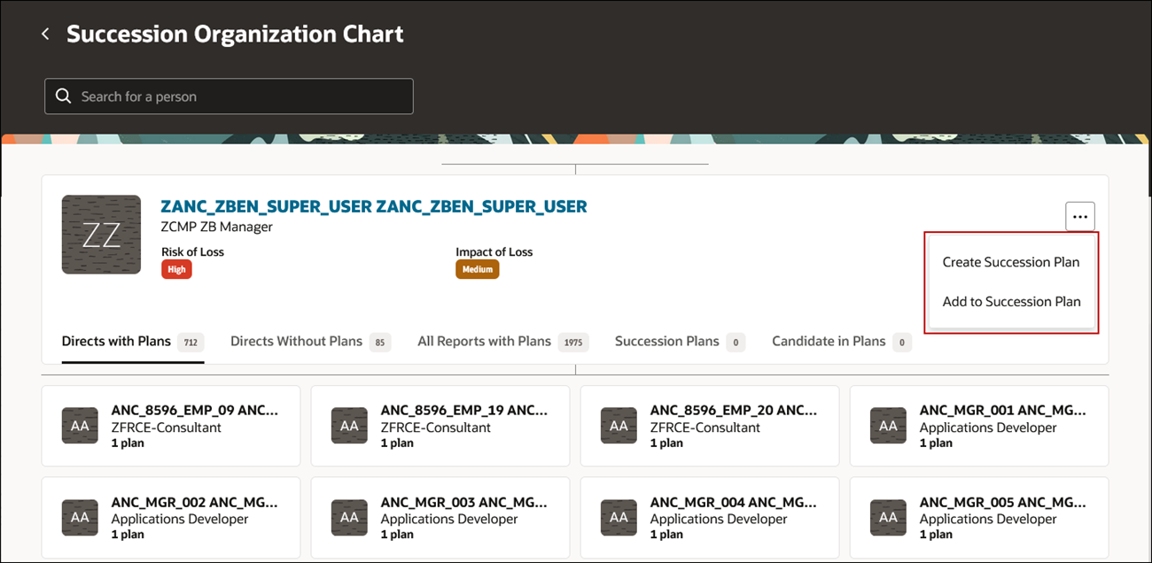

In the Succession Organization Chart, you can now navigate to the Redwood version of the Create Succession Plan and Add to Succession Plan pages, making a consistent user experience with other Redwood pages and flows. To view this page, go to My Client Groups > Succession Plans and click View Succession Organization Chart or go to My Team > Quick Actions > Succession Organization Chart.
Actions highlighted on Succession Organization Chart page
From the Succession Organization Chart page, you can search for the person whose succession chart you want to see. From there, click the Actions menu to select one of these actions:
  • Create Succession Plan
  • Add to Succession Plan

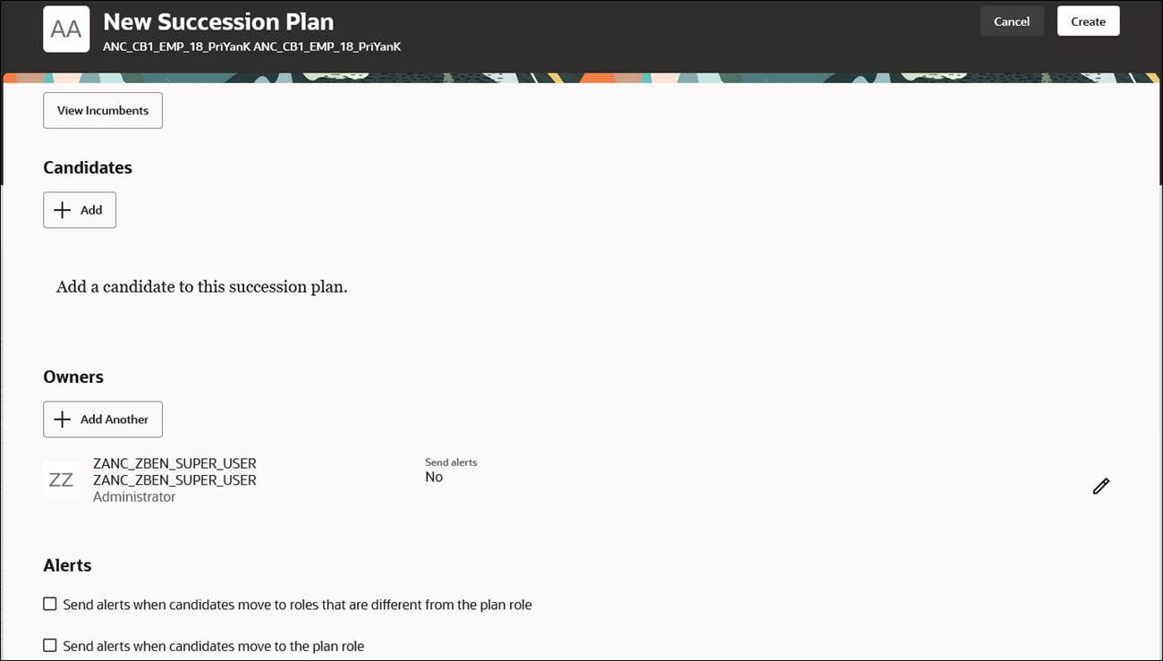

On the New Succession Plan page, you can perform these actions:
  • Add plan information
  • View incumbents
  • Add candidates
  • Add owners
  • Enable alerts to send when candidates move roles
Plan Info Section of New Succession Plan Page
Candidates, Owners, and Alerts Sections of New Succession Plan Page

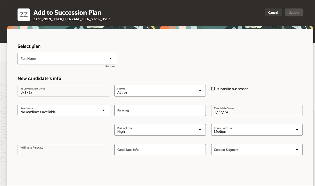

On the Add to Succession Plan page, you can do these actions:
  • Select a plan
  • View candidates information
Add to Succession Plan Page
