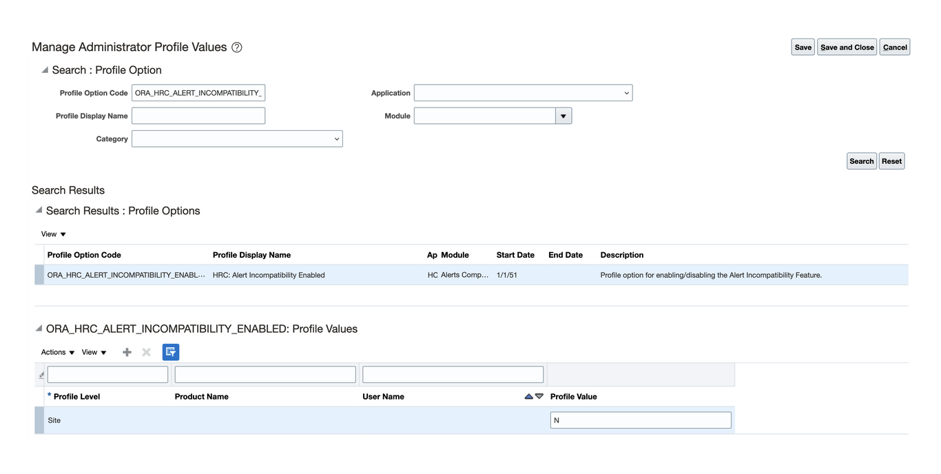

Steps to Enable
Follow these steps to change the profile option value.
- Go to Setup and Maintenance and search for the Manage Administrator Profile Values task.
- Go to the task page and search for the ORA_HRC_ALERT_INCOMPATIBILITY_ENABLED profile option.
- Change the value to Y.
- Save your changes.
Alert Profile Value Setup
