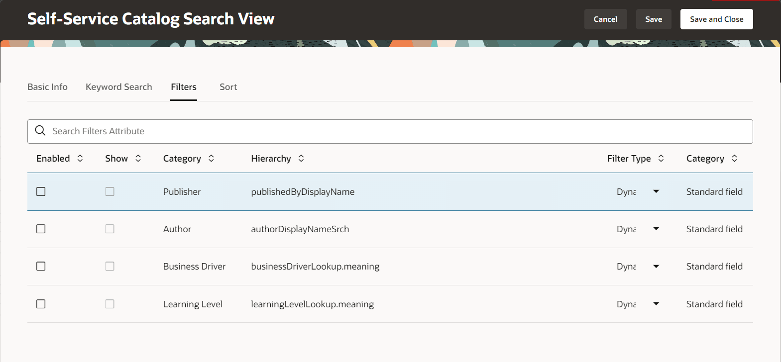

- Configure the Self Catalog Search View to show or hide the filters as you require. For configuration details, see the HCM Common release 25A What's New feature Configure Search Experience with Search Views for configuration details.
- Enable the use of HCM Search Views on learner and manager Learning Catalog pages by setting the Site level value to Y for the ORA_WLF_CATALOG_SEARCH_VIEWS_REDWOOD_ENABLED profile option.

- On My Client Groups, click Show More.
- Click Data Exchange > Search Views > Self-Service Catalog Search Field > Filters.
