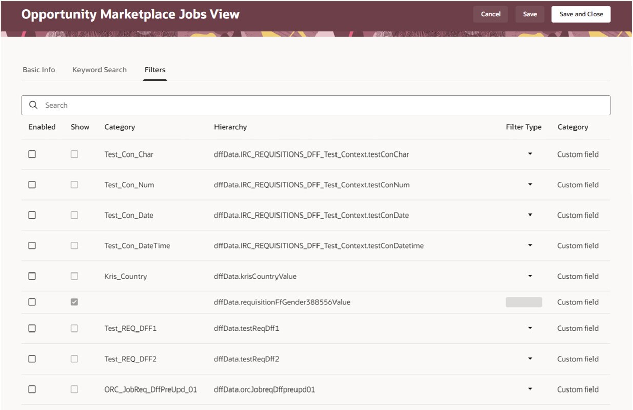

  3. Once ingested successfully, navigate to My Client Groups > Quick Actions > View More > Search Views.
  4. Select Opportunity Marketplace Jobs View.
  5. Click the Filters tab.
  6. Scroll down if needed to see the flexfields.

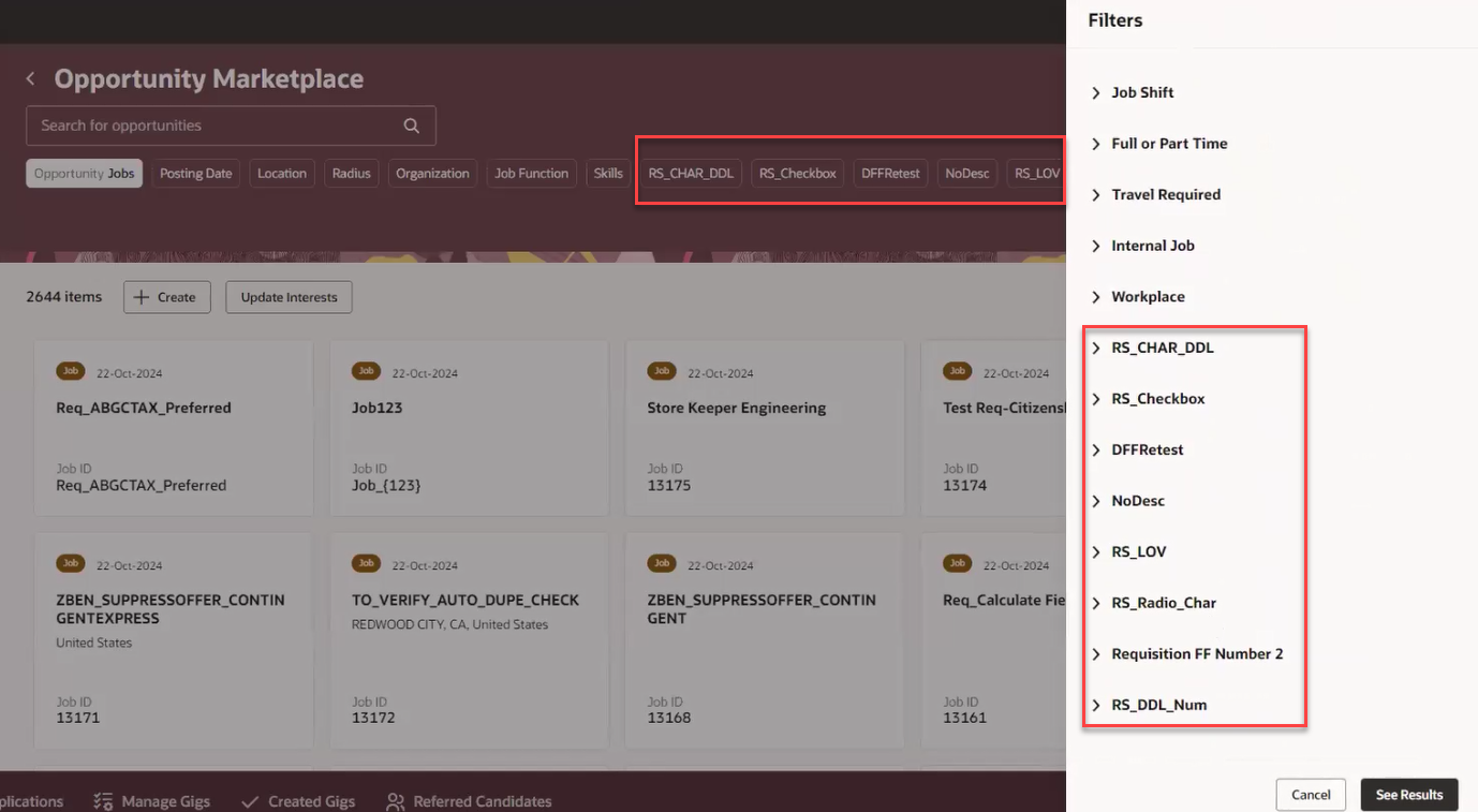

This screen capture shows the Opportunity Marketplace Search View Page
Filters Tab for the Opportunity Marketplace Jobs View
  1. Select the fields you want to use.
  2. Indicate whether you want to display them as filters or facets (or both).
