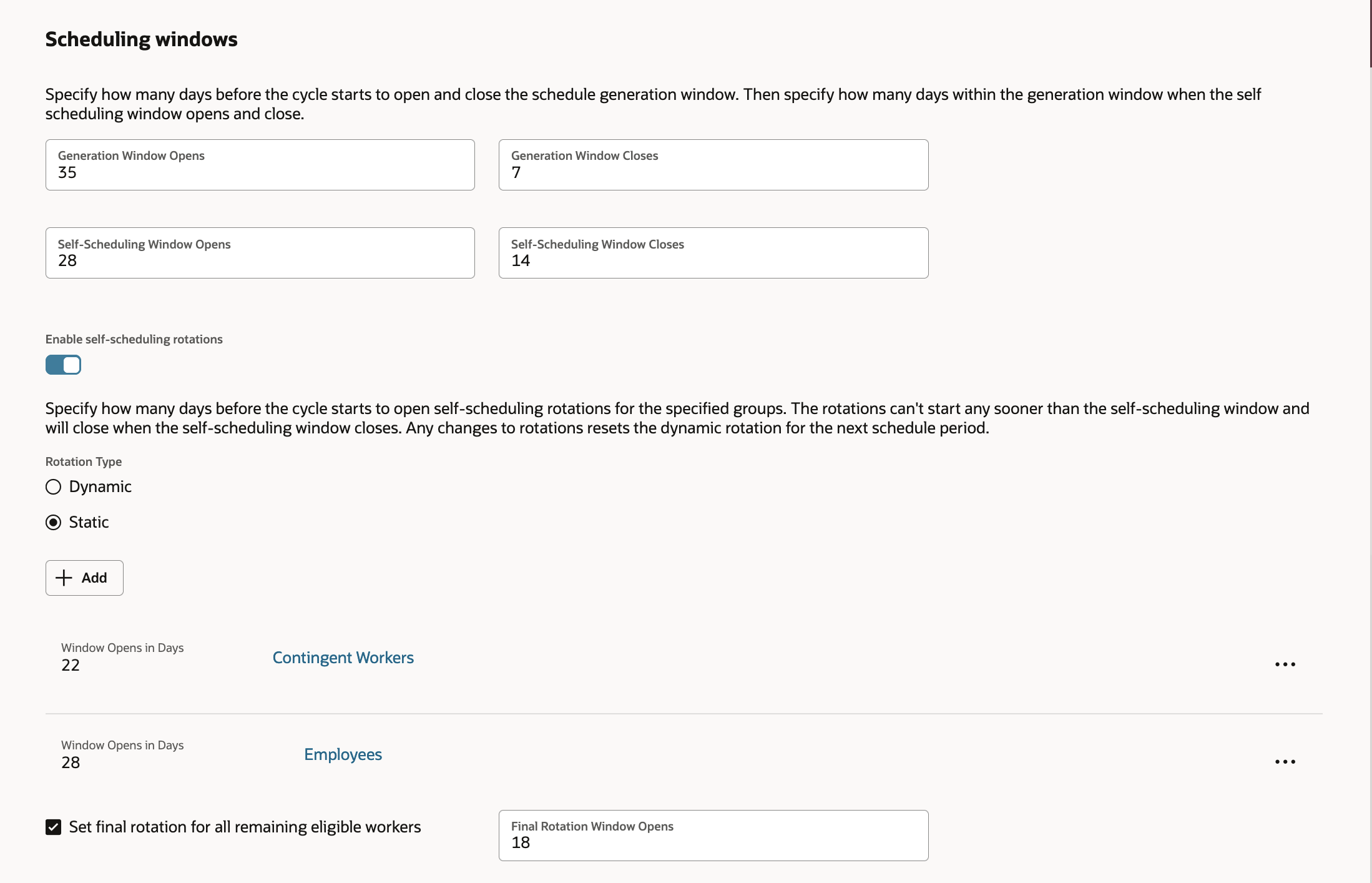

Steps to Enable
Use the My Client Groups > Scheduler Generation Profiles quick action.
- On the schedule generation profile, Schedule Plan tab, set the start and end dates for the self-scheduling window.
- Enable self-scheduling rotations.
- Specify whether the rotation type is Static or Dynamic.
- Add the rotations and the eligibility conditions for each rotation.
- Conditions can use attributes from worker assignments, such as location, department, job, grade, and position attributes.
- Make sure that each window opens on or within the self-scheduling window.
- Optionally set a last rotation for all remaining eligible workers.
Sample Scheduling Windows Configuration that Includes Self-Scheduling Rotations
