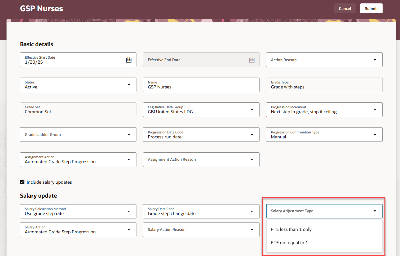

To configure the feature to prorate salary for FTE (or adjusted FTE), use the Salary Adjustment Type on the grade ladder. This image shows the Salary Adjustment Type attribute on the Redwood Grade Ladders page. The attribute isn't new with this enhancement, and it's also available on the classic Progression Grade Ladders page. The change with this enhancement is that if you set the grade ladder to adjust for FTE, the feature can be configured to use Adjusted FTE instead.
Salary Adjustment Type in Grade Ladder
