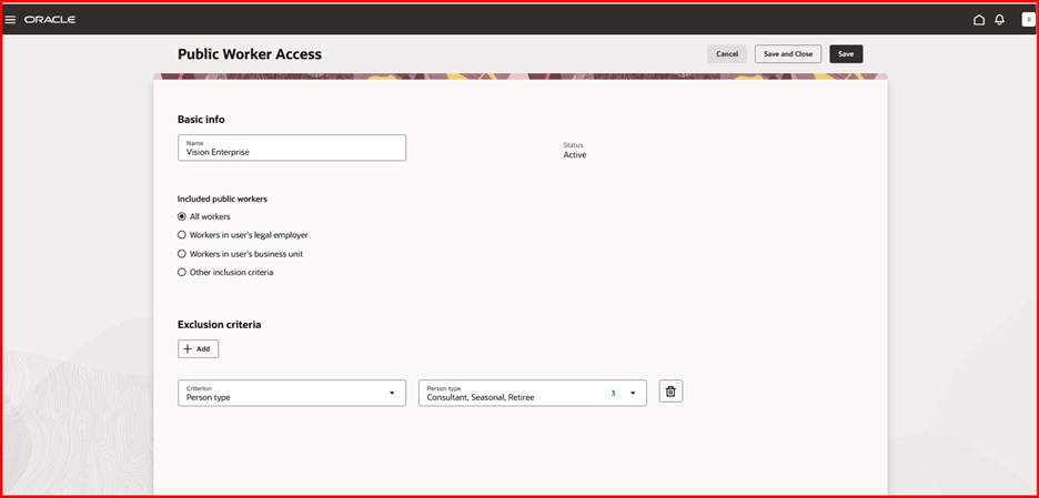

Scenario 1: View All Workers in the Enterprise, but Exclude Certain People based on Criteria
If you want to include All workers with certain groups to exclude, you can do this by choosing one or more values from the available criteria which includes the following:
  • Assignment status
  • Business unit
  • Department
  • Grade
  • Job
  • Legal employer
  • Person
  • Person Type (both user and system person types).
Public Worker Access Page Where the All Workers Option Is Chosen, Along with Person Type Exclusion Criteria
Public Worker Access Page Where the All Workers Option Is Chosen, along with Person Type Exclusion Criteria
With the All workers option, you can configure multiple criteria and values to exclude. Based on the example above, the public worker’s LOV will list all workers in your organization that are not consultants, seasonal workers, or retirees.

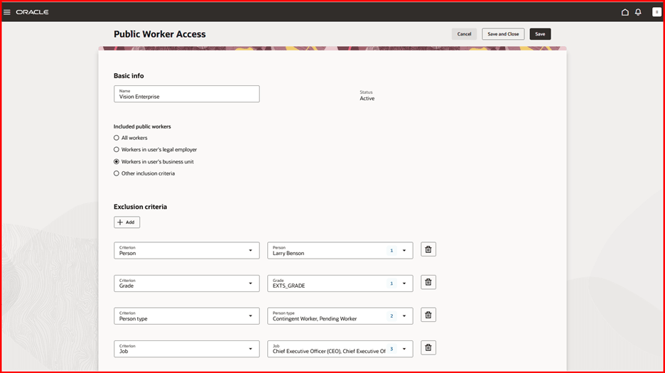

Scenario 3: View Workers from the User’s Own Business Unit, but Exclude Certain People based on Criteria
If you want to include Workers in a user’s business unit this option uses the business unit from the signed-in user’s assignment(s).  If the worker has multiple assignments in different business units, then workers from those business units will be evaluated.  With this option, you can further limit access from workers in those business units by choosing one or more values from the available exclusion criteria which includes the following:
  • Assignment status
  • Business unit
  • Department
  • Grade
  • Job
  • Legal employer
  • Person
Public Worker Access Page Where the Workers in User’s Business Unit Option Is Chosen, Along with Multiple Exclusion Criteria
Public Worker Access Page Where the Workers in User’s Business Unit Option Is Chosen, along with Multiple Exclusion Criteria
With the Workers in a user’s business unit option, you can configure multiple criteria and values to exclude, except for business unit. An error appears if you choose Business unit as this choice conflicts with the public workers inclusion selection.
Based on the example above, the public worker’s LOV will list all workers in the signed-in user’s business units that aren’t in a grade of EXTS_GRADE, are not in CEO or CFO jobs, and aren’t consultants or pending workers. Additionally, Larry Benson is identified as a sensitive person, so he will also be filtered out.
