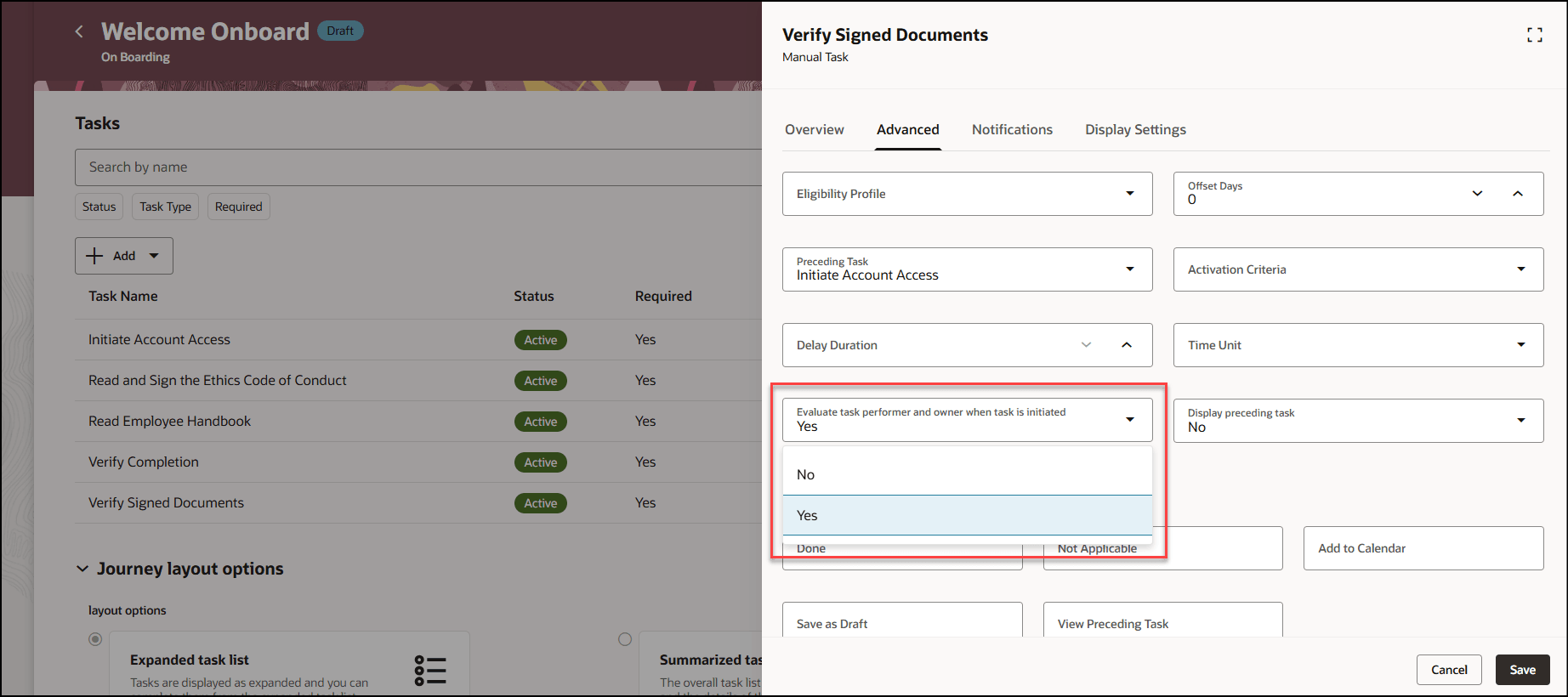

Option to Evaluate Task Performer and Owner When Task is Initiated

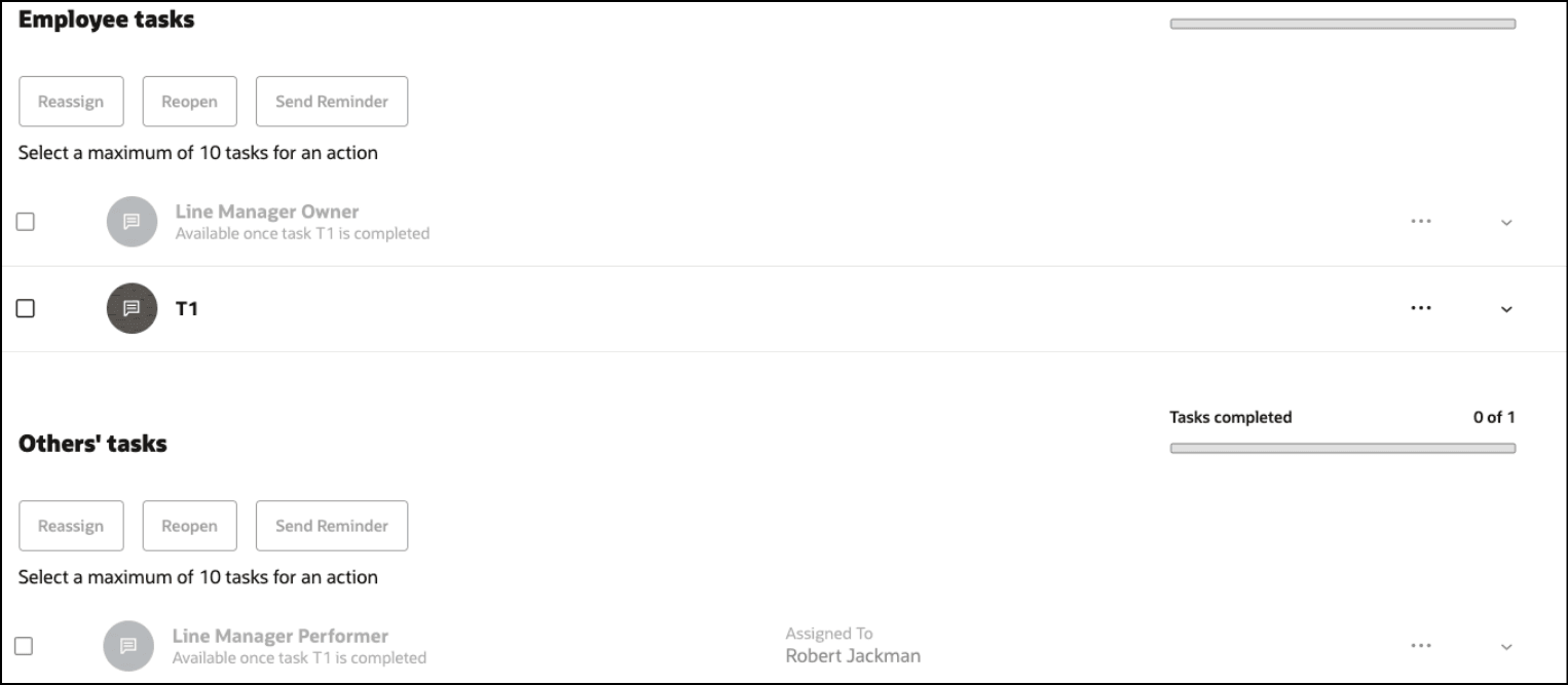

Line Manager Owner and Performer Before Assigning

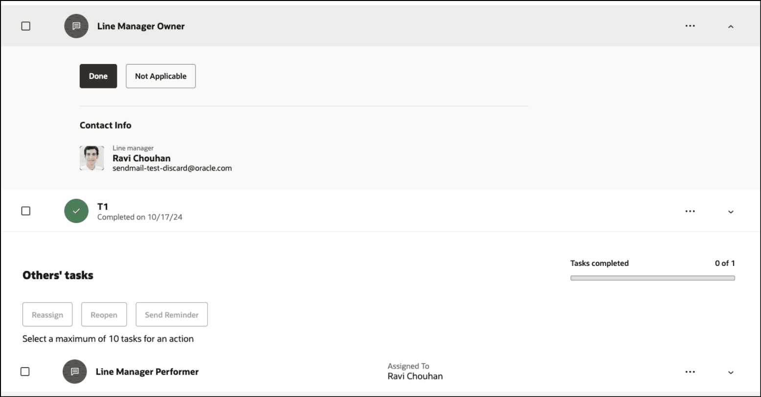

Line Manager Owner and Performer After Assigning
