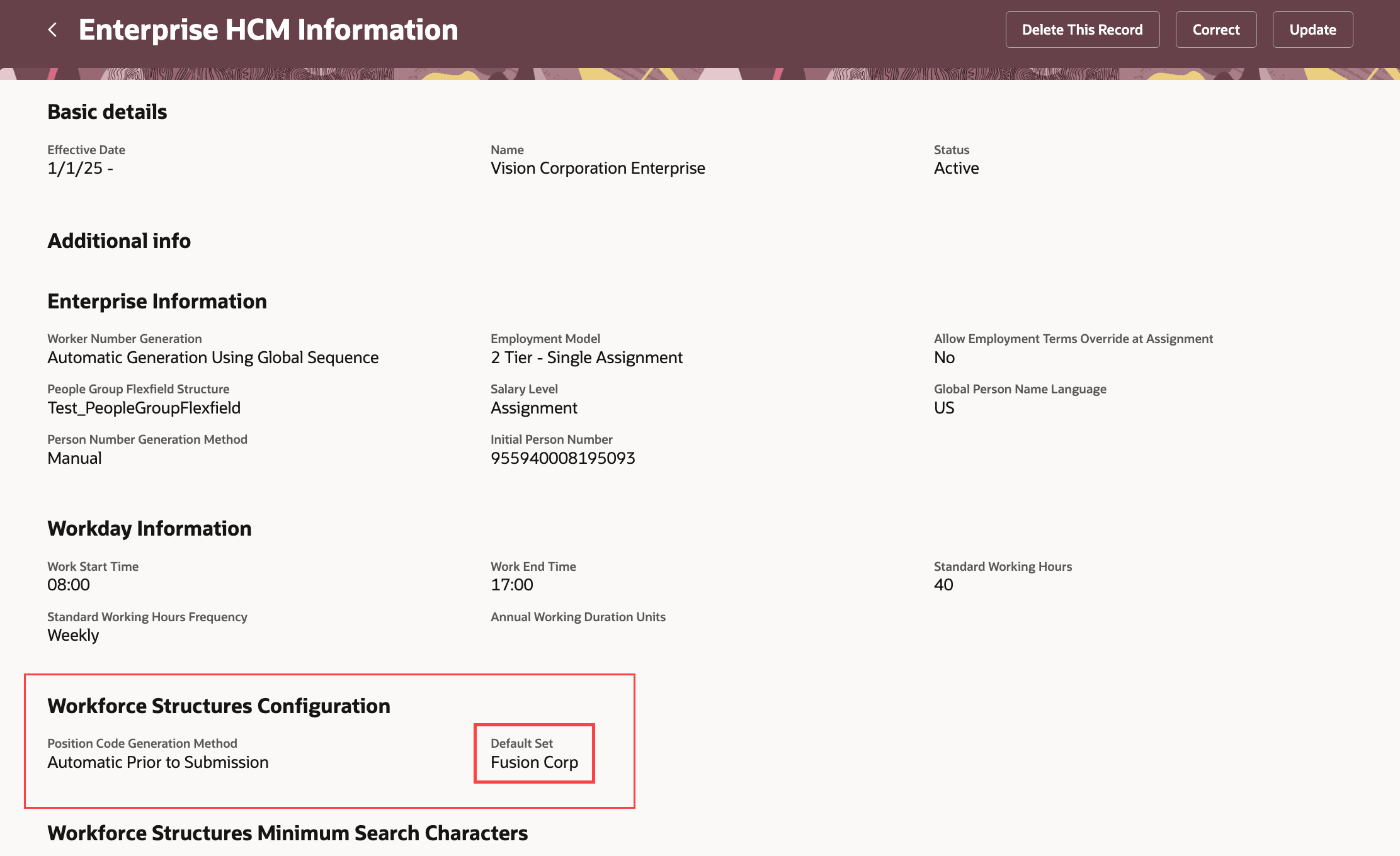

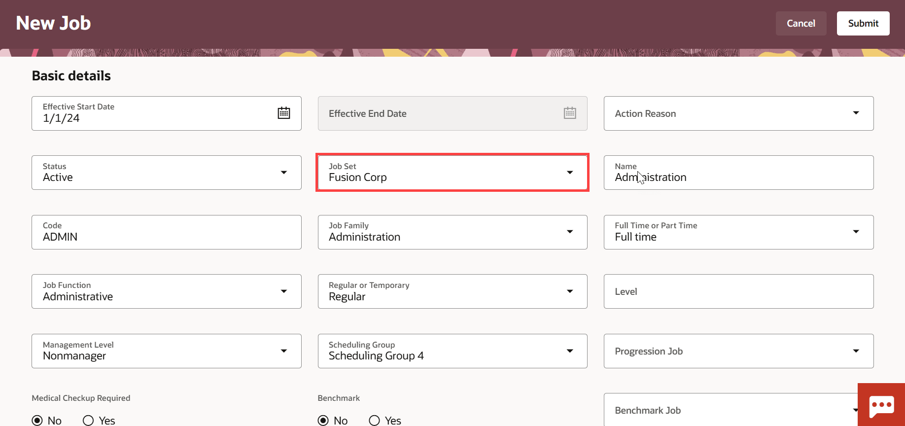

When you’re creating a job, location, department, or grade, the set is defaulted to Common Set. You can now override this default value by updating the Default Set field on the Enterprise HCM Information page. When you specify a default set, the pages mentioned above inherit that set from the enterprise configuration.
To update the default set on the Enterprise HCM Information page:
  1. On the Home page, navigate to Workforce Structures > My Client Groups > Enterprise HCM Information page.
  2. Click Update.
  3. In the Additional info section, go to the Workforce Structures Configuration segment, and update the Default Set field with the set name that you want.
  4. Click Submit.
Configure Default Set on the Enterprise HCM Information page
Job Set defaults to the Default Set on the Enterprise HCM Information page
This feature provides you the ability to specify a default set to be used for pages in a consistent manner while creating workforce structures objects.
