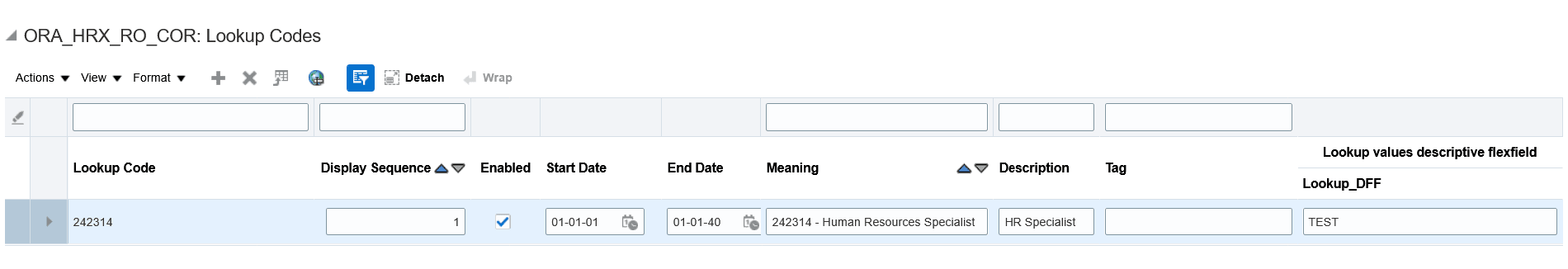

To manually add the needed values for the COR Occupation:
  1. Click Navigator > My Enterprise > Setup and Maintenance.
  2. In the Setup and Maintenance work area, search for the Manage Common Lookups task.
  3. Search for the Romania Worker Occupation Classifications lookup type: ORA_HRX_RO_COR.
  4. Under the Lookup Codes section, click the plus sign (+) to create a COR Occupation value for Romania.        Screen capture of the Romania job legislative information lookup code to add the COR Occupation attribute.
  5. To have multiple COR codes, click the plus sign (+) again. After the necessary values are added, click Save and Close.

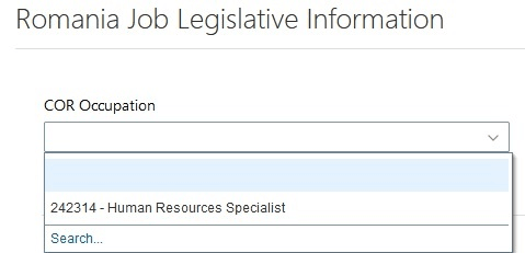

The COR Occupation attribute is available in both Redwood and responsive interfaces.
Screen capture of the Romania job legislative information with value added to the COR Occupation attribute.
COR Occupation list with a value added to the ORA_HRX_RO_COR lookup type.
