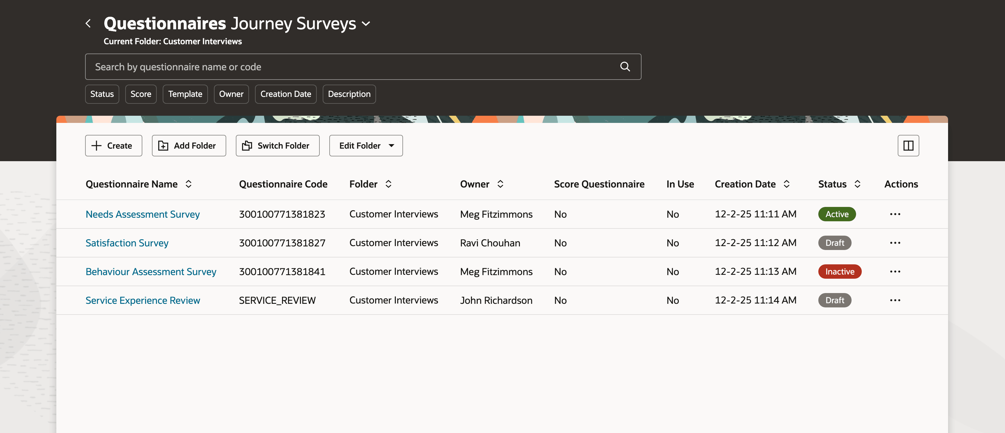

Quickly find existing questionnaires using search filters and easily navigate through the steps to create and manage them.
Screen capture for the Questionnaires landing page

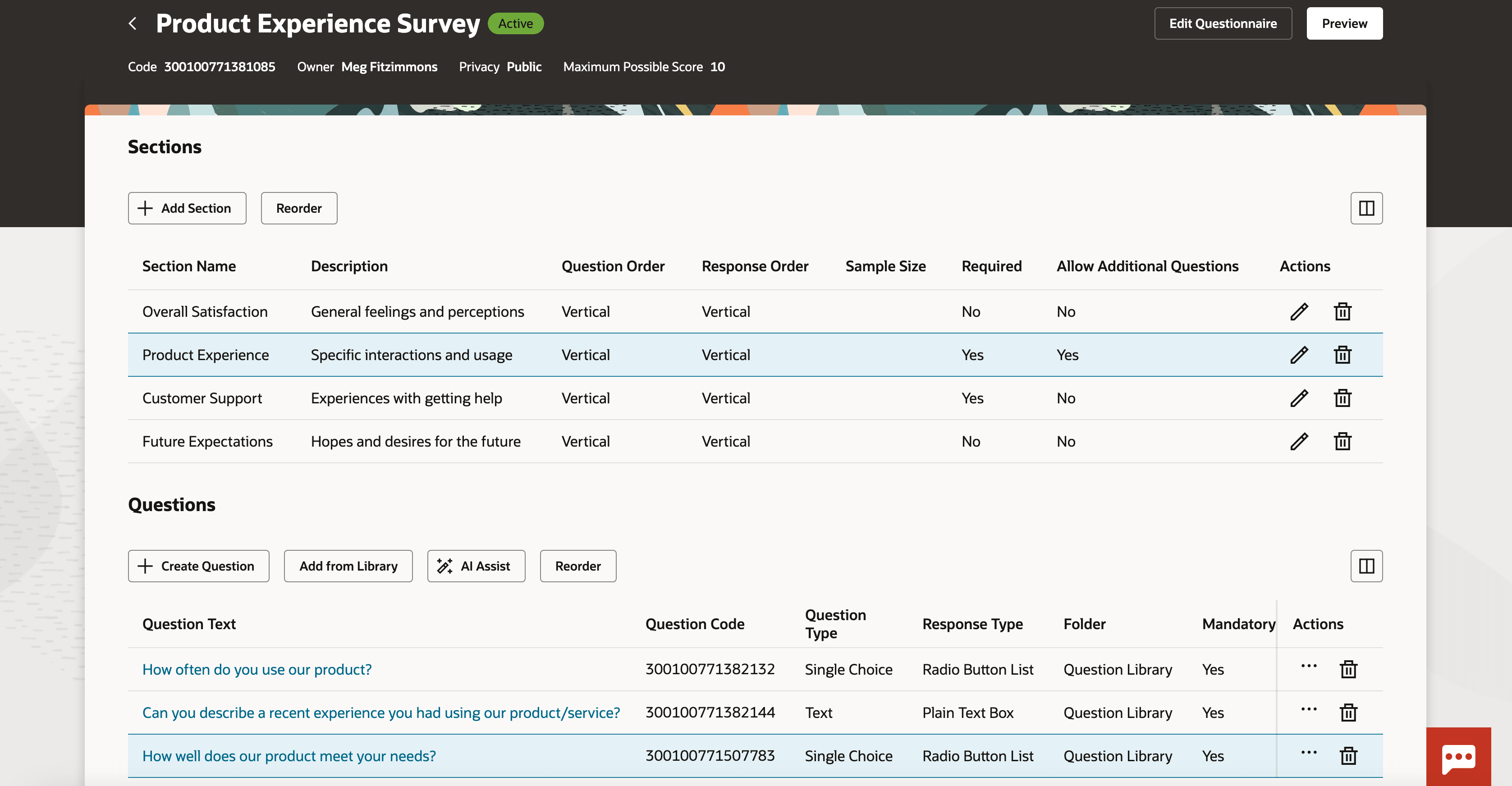

Screen capture with sections and questions

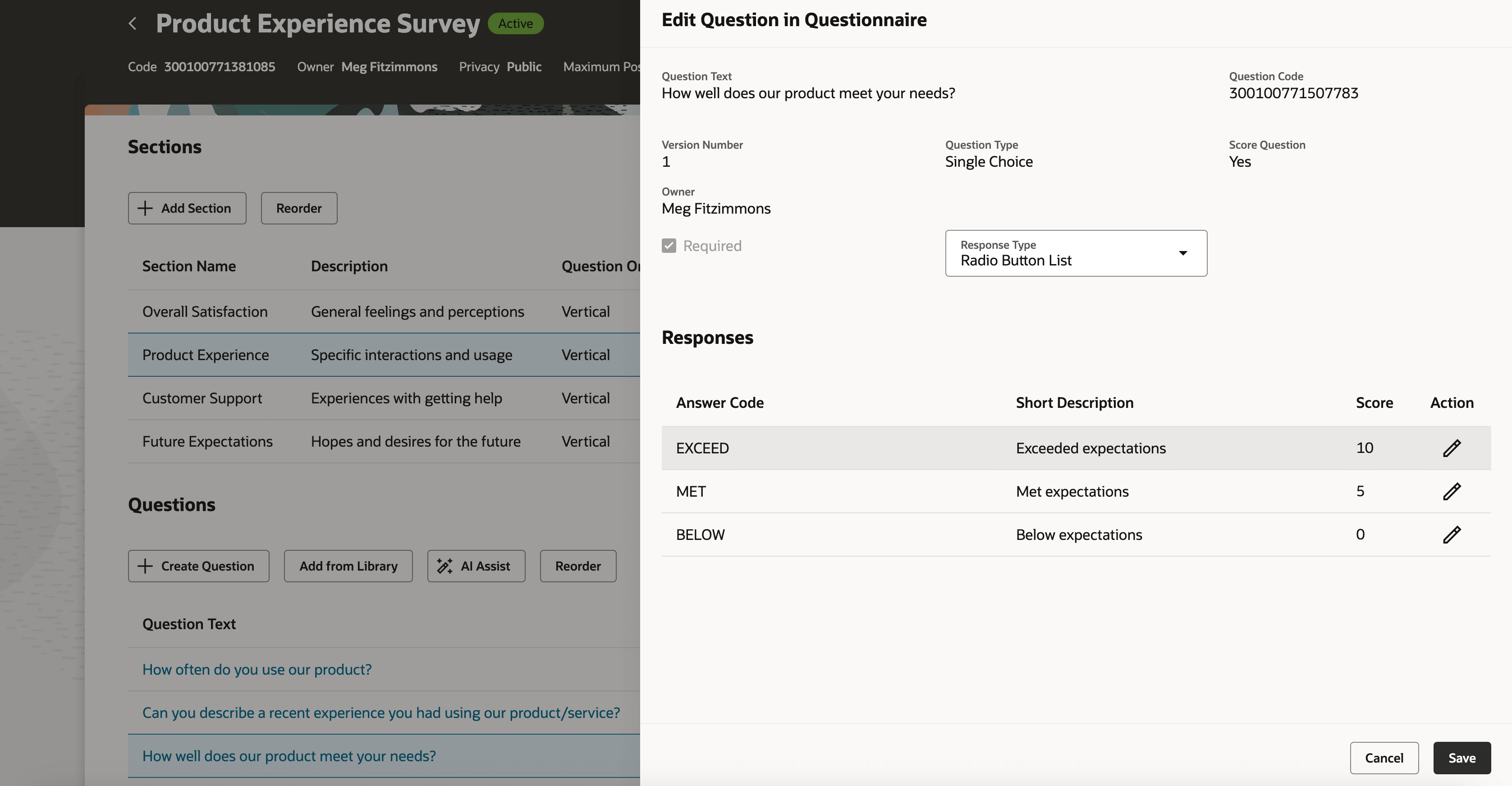

Screen capture of Questionnaire page open with Edit Question in Questionnaire side panel open

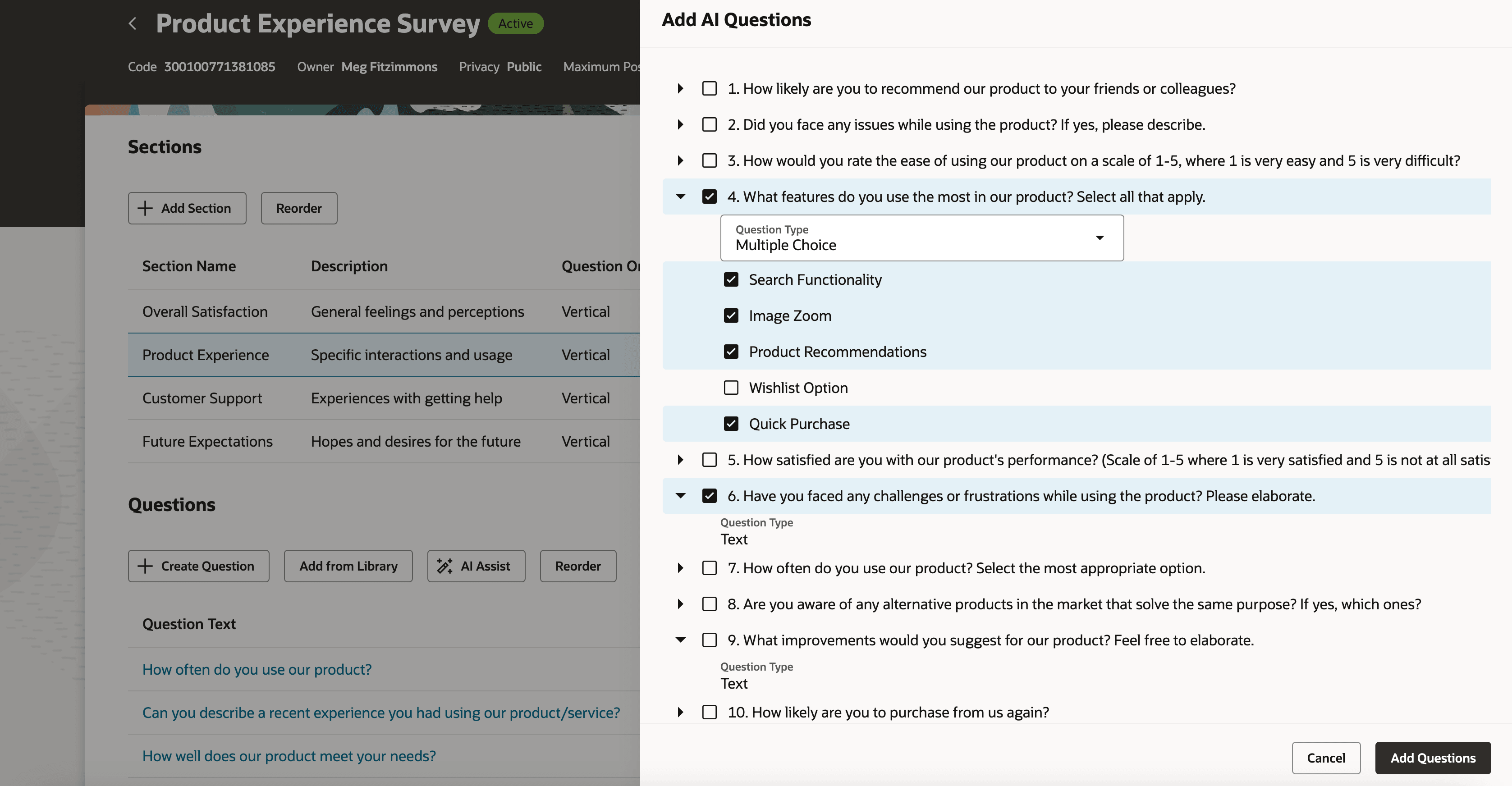

Screen capture of Questionnaire page open with Add AI Questions side panel open
The AI Assist capability is available for the Journey Survey subscriber only.
