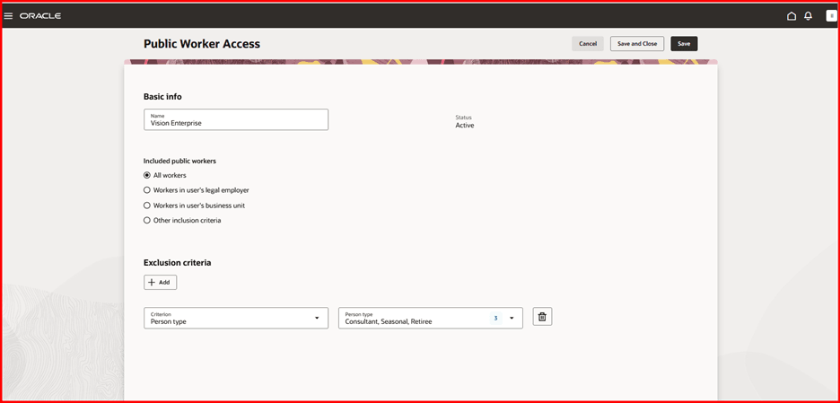

Scenario 1: View All Workers in the Enterprise, but Exclude Certain People based on Criteria
If you want to include All workers with certain groups to exclude, you can do this by choosing one or more values from the available criteria which includes the following:
  • Assignment status
  • Business unit
  • Department
  • Grade
  • Job
  • Legal employer
  • Person
  • Person Type (both user and system person types).
Public Worker Access Page Where the All Workers Option Is Chosen, along with Person Type Exclusion Criteria
Example 1: Public Worker Access Page Where the All Workers Option Is Chosen, along with Person Type Exclusion Criteria
With the All workers option, you can configure multiple criteria and values to exclude. Based on the example above, the public workers LOV will list all workers in your organization that are not consultants, seasonal workers, or retirees.

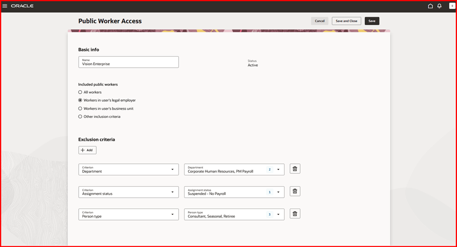

Scenario 2: View Workers from the User’s Own Legal Employer, but Exclude Certain People based on Criteria
If you want to include Workers in a user’s legal employer, this option uses the legal employer from the signed-in user’s assignment(s).  If the worker has multiple assignments in different legal employers, then workers from those legal employers will be evaluated.  With this option, you can further limit access from those legal employers by choosing one or more values from the available exclusion criteria which includes the following:
  • Assignment status
  • Business unit
  • Department
  • Grade
  • Job
  • Person
Public Worker Access Page Where the Workers in User’s Legal Employer Option Is Chosen, Along with Multiple Exclusion Criteria
Example 2: Public Worker Access Page Where the Workers in User’s Legal Employer Option Is Chosen, along with Multiple Exclusion Criteria
With the Workers in a user’s legal employer option, you can configure multiple criteria and values to exclude, except for legal employer. An error appears if you choose a legal employer as this choice conflicts with the public workers inclusion selection.
Based on the example above, the public workers LOV will list all workers in the signed-in user’s legal employer that are not in Human Resources or Payroll Departments, aren't suspended, and aren’t consultants, seasonal workers, or retirees.

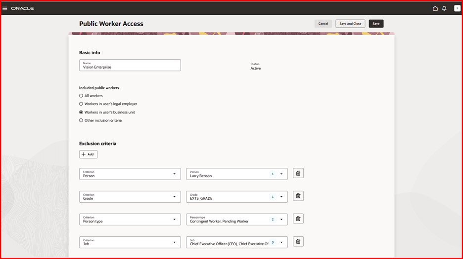

Scenario 3: View Workers from the User’s Own Business Unit, but Exclude Certain People based on Criteria
If you want to include Workers in a user’s business unit, this option uses the business unit from the signed-in user’s assignment(s).  If the worker has multiple assignments in different business units, then workers from those business units will be evaluated.  With this option, you can further limit access from workers in those business units by choosing one or more values from the available exclusion criteria which includes the following:
  • Assignment status
  • Business unit
  • Department
  • Grade
  • Job
  • Legal employer
  • Person
Public Worker Access Page Where the Workers in User’s Business Unit Option Is Chosen, Along with Multiple Exclusion Criteria
Example 3: Public Worker Access Page Where the Workers in User’s Business Unit Option Is Chosen, along with Multiple Exclusion Criteria
With the Workers in a user’s business unit option, you can configure multiple criteria and values to exclude, except for business unit. An error appears if you choose Business unit as this choice conflicts with the public workers inclusion selection.
Based on the example above, the public workers LOV will list all workers in the signed-in user’s business units that aren't in a grade of EXTS_GRADE, aren't in CEO or CFO jobs, and aren’t consultants or pending workers. Additionally, Larry Benson is identified as a sensitive person, so he will also be filtered out.

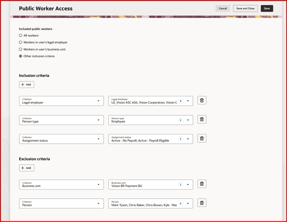

Scenario 4: View Workers Based on Other Inclusion Criteria
Lastly, if the earlier options don’t suit your needs, you want to define another set of workers to include.  For this, we let you choose the Other inclusion criteria option.  Here you have the choice to choose one or more values from the available inclusion criteria which includes the following:
  • Assignment status
  • Business unit
  • Legal employer
  • Person type
  • Assignment status
  • Business unit
  • Department
  • Grade
  • Job
  • Legal employer
  • Person
Note that you can’t define exclusion criteria for any of these same inclusion criteria. If you want to exclude a value, then simply remove it from the inclusion criterion values. Inversely, it may be advantageous to define a shorter list of exclusion criterion values instead. It depends on the number of corresponding values defined by your organization. You’ll have to assess which is easier to manage during your implementation.
Public Worker Access Page Where the Other Inclusion Criteria Option Is Chosen, Along with Multiple Inclusion and Exclusion Criteria
Example 4: Public Worker Access Page Where the Other Inclusion Criteria Option Is Chosen, along with Multiple Inclusion and Exclusion Criteria
With the Other inclusion criteria option, you can configure multiple criteria and values to include and exclude. Based on the example above, the public workers LOV will list all workers in the 4 specified Vision legal employers that are people with an active assignment status.  Further excluded from the public worker search, is anyone in the Vision BR Payments BU business unit, including the 4 people provided in the Person List of Values (LOV).
