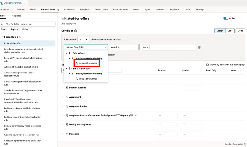

This allows validations and field controls depending on whether the action is initiated from a job offer conversion. To help customers prepare early, the "Initiated from Offer" field is available in 25C, so business rules can be set up in advance and avoid rework when the feature goes live in 25D.
Business Rule Configuration Based on Whether Initiated From Offer
Reduces reconfiguration effort by enabling early setup of business rules, ensuring a smooth transition when the feature becomes active in 25D.
Steps to enable and configure
