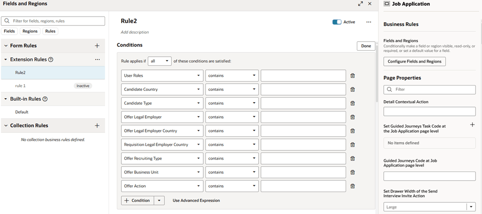

Take advantage of these new parameters in Visual Builder Studio to personalize the job application details page and job offer details page. With these parameters, you can personalize fields and sections.

With these new parameters, you can hide or show sections and fields in the job requisition details page and job offer details page as per your business process and efficiently display the appropriate information using additional parameters.
